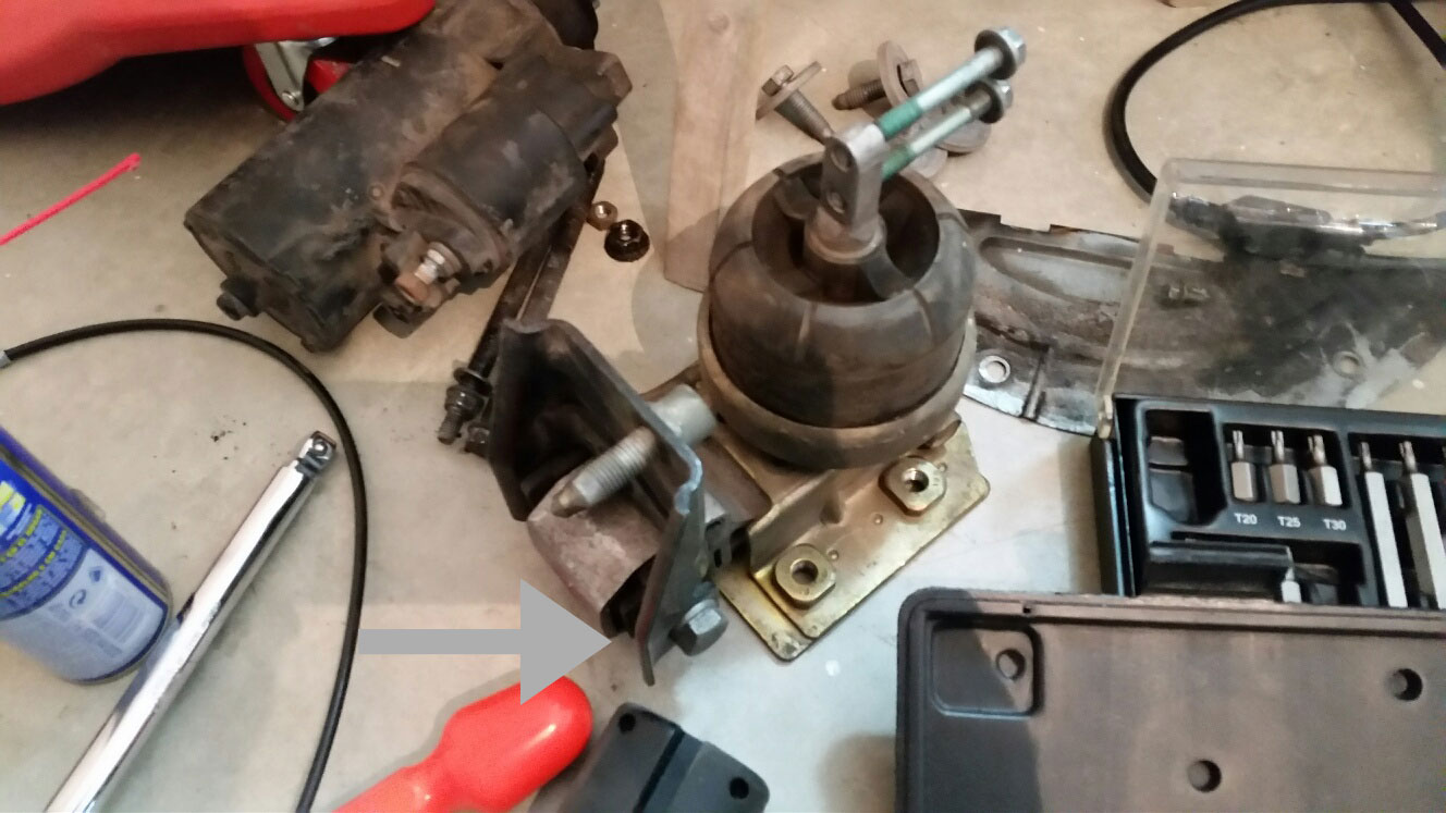

« Reply #63 on: April 07, 2016, 11:06:22 am »
The judder is really getting me down, done about 180km now since changing the clutch.  :sad1:
Jacked it up earlier and checked the mounts the lower mount is rock solid struggle to get any movement.
But there is a tiny bit if movement on the gearbox mount with not much pressure. I've marked where the movement is in the pic below could this be causing the judder?? It only moves a tiny bit.
05 | Tornado Red | DSG

« Reply #64 on: April 11, 2016, 10:13:15 pm »
Ordered a new engine mount if that does not fix the judder will move on to the dog bone mount. If that fails i think i will scrap her.

« Reply #65 on: April 13, 2016, 07:48:14 pm »
The judder is gone. Changing the mount was a pita not helped by buying the cheapest mount i could find.
It didn't fit so i took the grinder to it.
