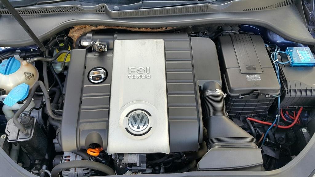

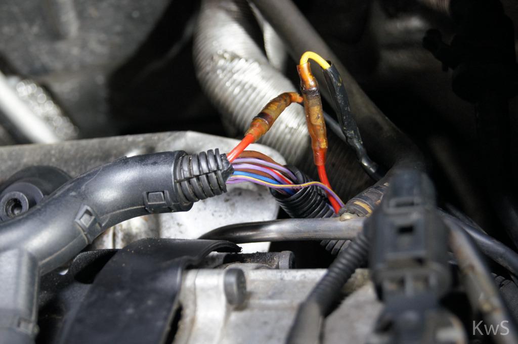

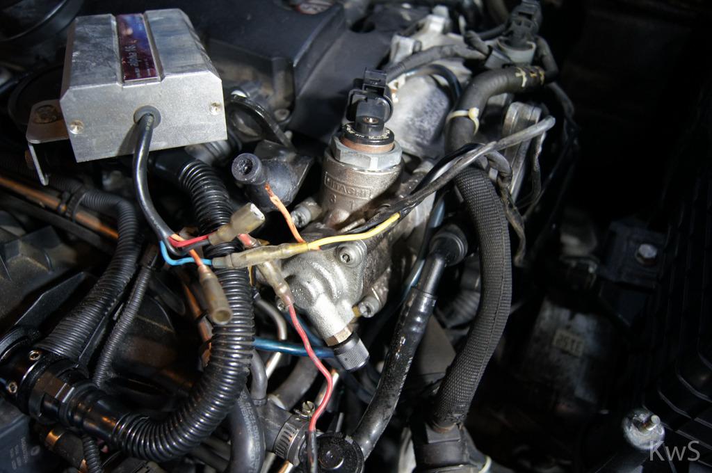

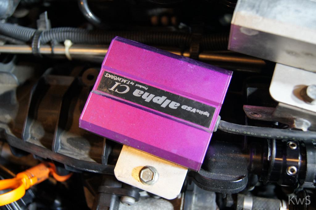

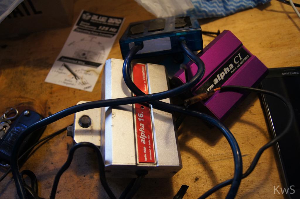

Obviously it was fuel or spark that was missing. I always have my OBD2 bluetooth scanner in the car, because its fun watching things on my phone screen whilst driving. I did a quick check, if the fuel pump wasnt working, the fuel rail pressure would be poo. Sure enough, when i checked the fuel pressure in the rail it shot up as soon as the engine was cranked. Fuel ruled out, the low pressure pump is feeding the high pressure pump and the pressure was quickly increased to almost 1000psi.

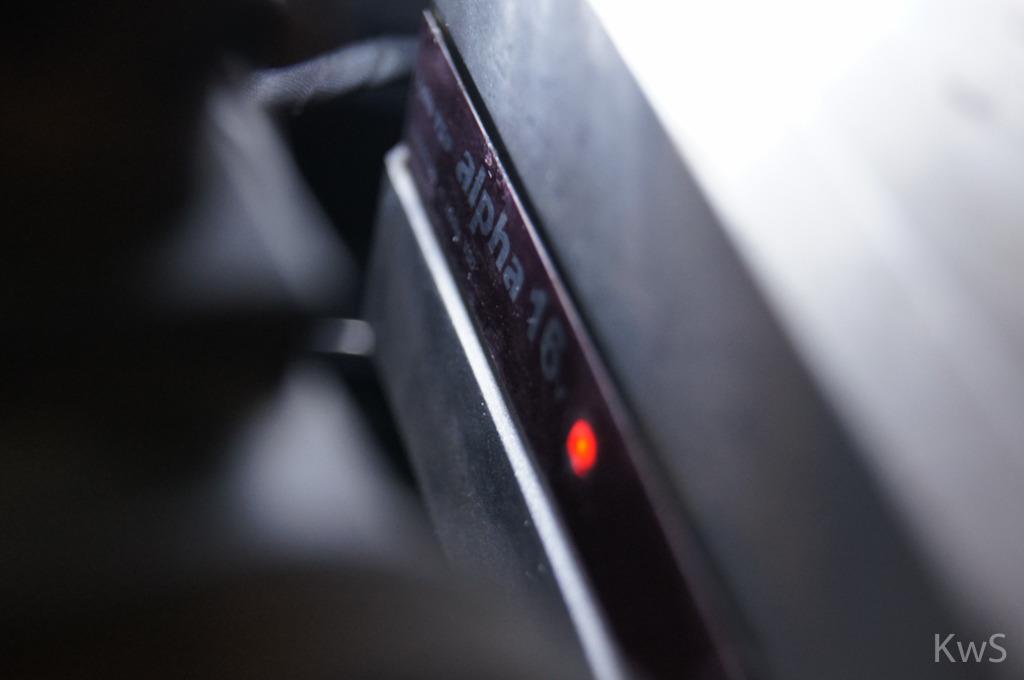

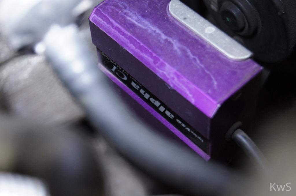

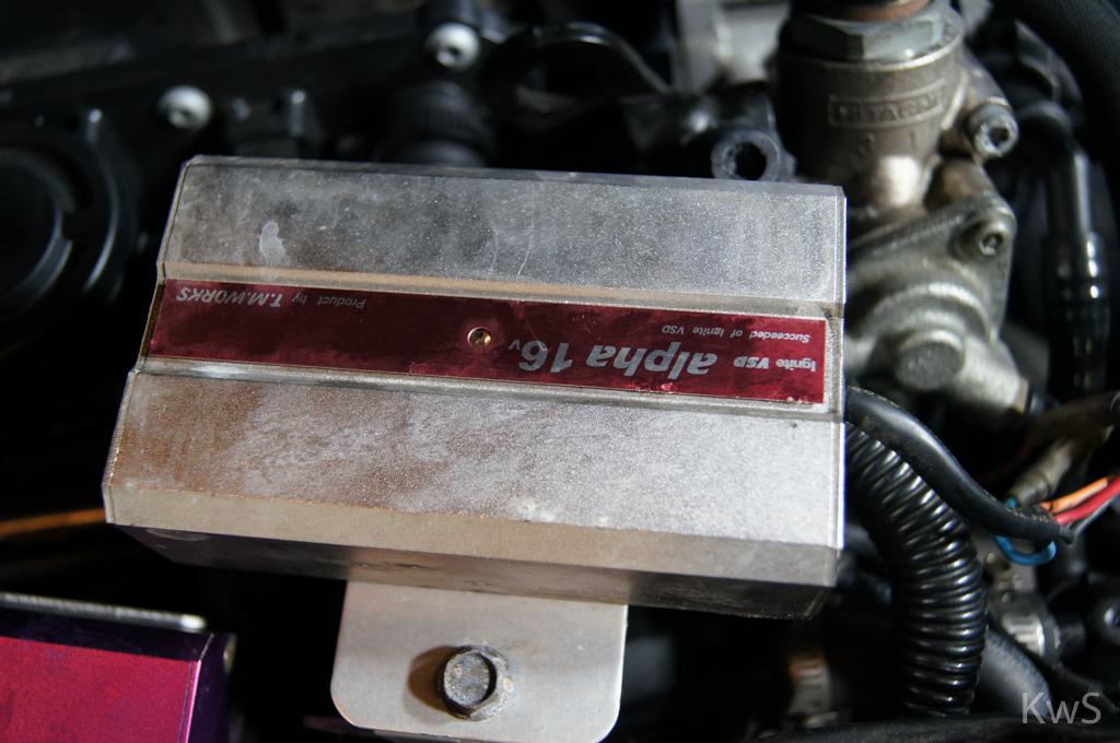

So, its spark then. Its coil on plug, so it would be pretty unexpected for all 4 coils to fail in one go. Wait, what about the japanese ignition booster boxes? Turned the ignition on, and popped the hood. sure enough, the lights on the boxes were not lit. Wiggled and jiggled the wiring going to the boxes, and the light came on. Turned the key and the car fired into life. barstewards.
Drove around the block a bit, and the car was running fine. Decided to YOLO it, so rang roadside rescue and told them to cancel the truck as i was going to limp the car home (and not pay the $80 towing fee).
Got home ok, no issues at all. DSG is even operating a little better with the battery reset, and its learning my driving style. Rev matching on downshift is a bit better than it was too.
So all in all, the car is now in the garage, didnt need a tow, and ill be ripping all the useless dodgy japanese electronic boxes out from under the hood.
Didnt need this in the end, but made me feel like a mad hardparker driving home with it in
And these are the things ill be pulling out

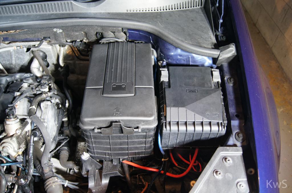

06/7/15

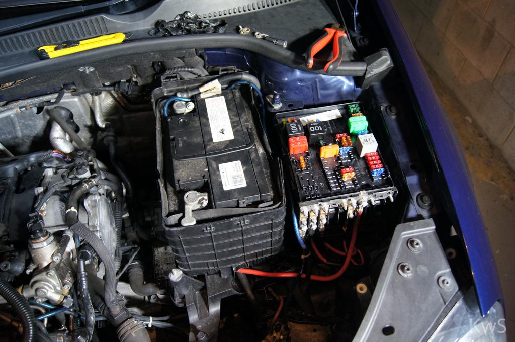

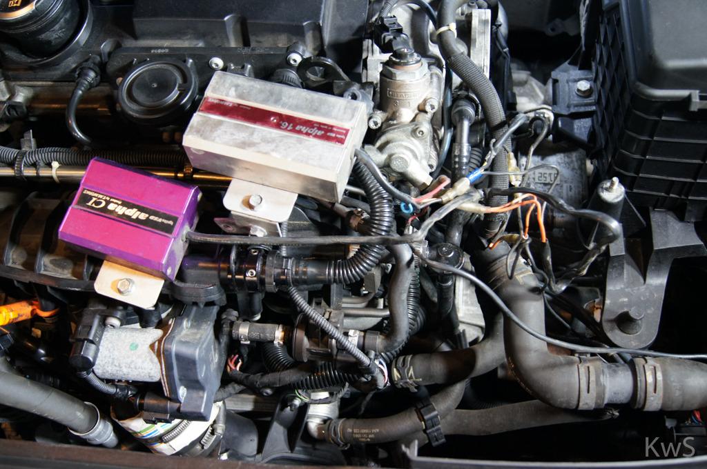

I thought i should probably get the stricken Golf out of the garage so the daily can get out of the cold. Poor thing.

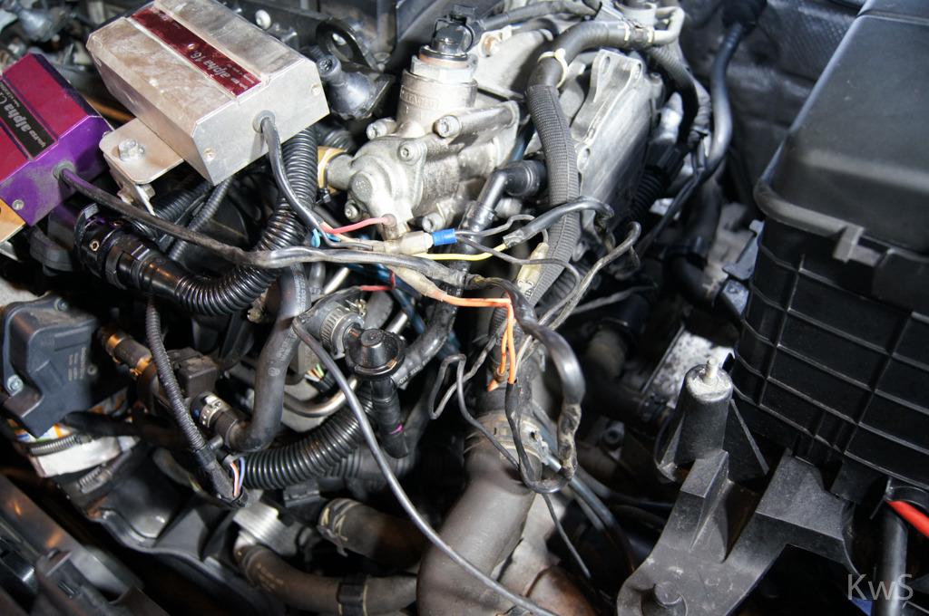

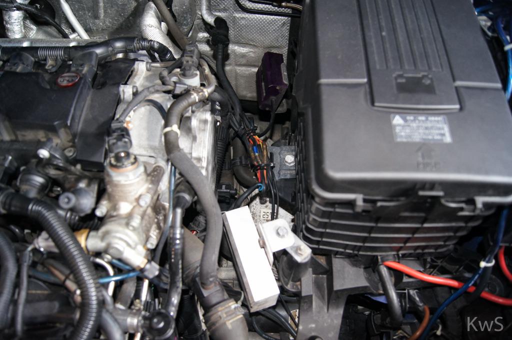

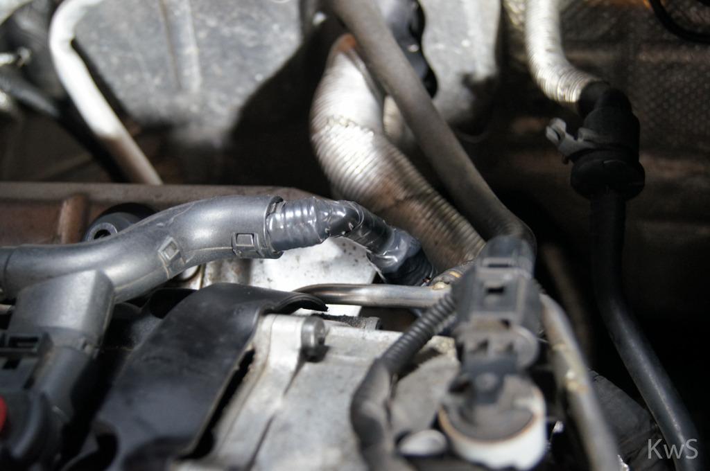

So this is where i started. removed the engine cover (getting real good at that now), and took a good geez at what was before me. The two boxes and the clump of wiring.
I started by physically removing the boxes from their mounts and removing all the dozens of zipties holding the wiring in.

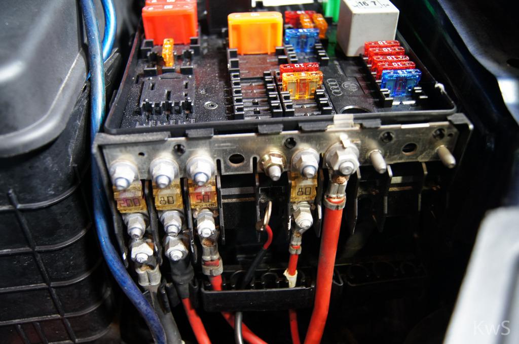

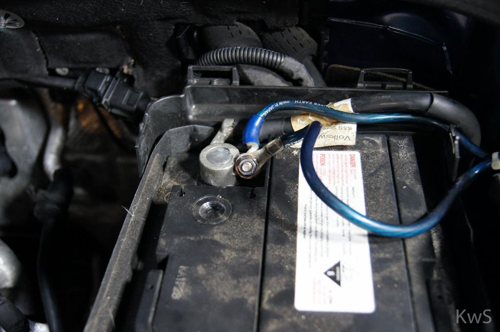

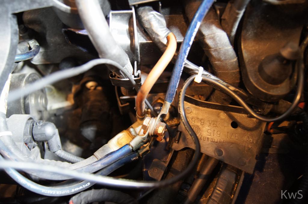

Disconnected the (unfused) mains connection, and ground

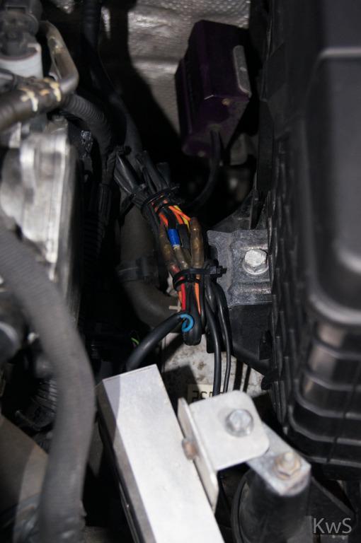

When i weeded out the wiring for the Alpha CI box, i wasnt left with a lot. In fact, only two wires were heading into the loom.
Followed the two wires, and found them intercepting the main power feed to the coils.
Now, i did intend to solder the wires back together when i started, but its bit of a poo to reach, the wires are now short with not much slack (due to them being cut), and the lovely japanese installer has installed bullet terminals on them. I decided it was just easier to reuse the bullet terminals, so i plugged them together and wrapped the loom in insulation tape.

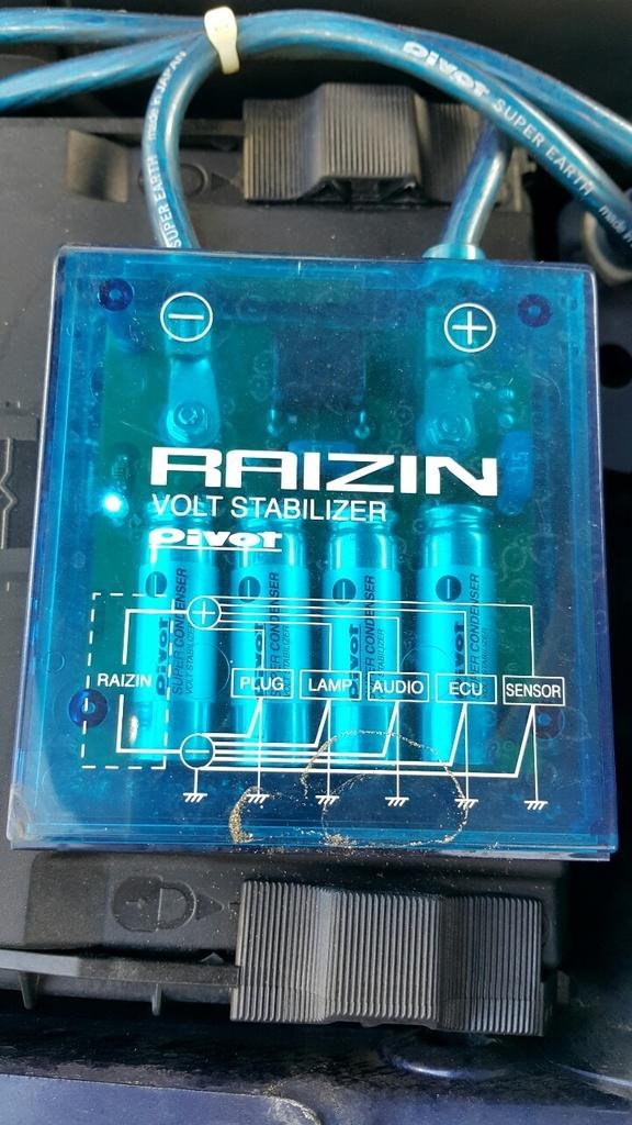

So after fixing that mess i had a look into the Raizin box. After some careful investigation i noted that the Pivot system comprises of the box with a power and ground, and a completely separate grounding kit. Left the grounding kit in place (after a quick tidy up of the wiring to the battery), and removed the box and its wiring.
This is all the crap i was left with
The battery cover and fuse lid now fit correctly, much cleaner.
This is what it looked like before
Now
Im going to pull the boxes to bits to see whats actually in them. Unfortunately they do have security screws, so ill need to wait till i can be bothered to get the Dremel out.
Car starts and runs normally again. No other real noticeable differences yet, hopefully i dont notice a reverse placebo by removing the boosters.

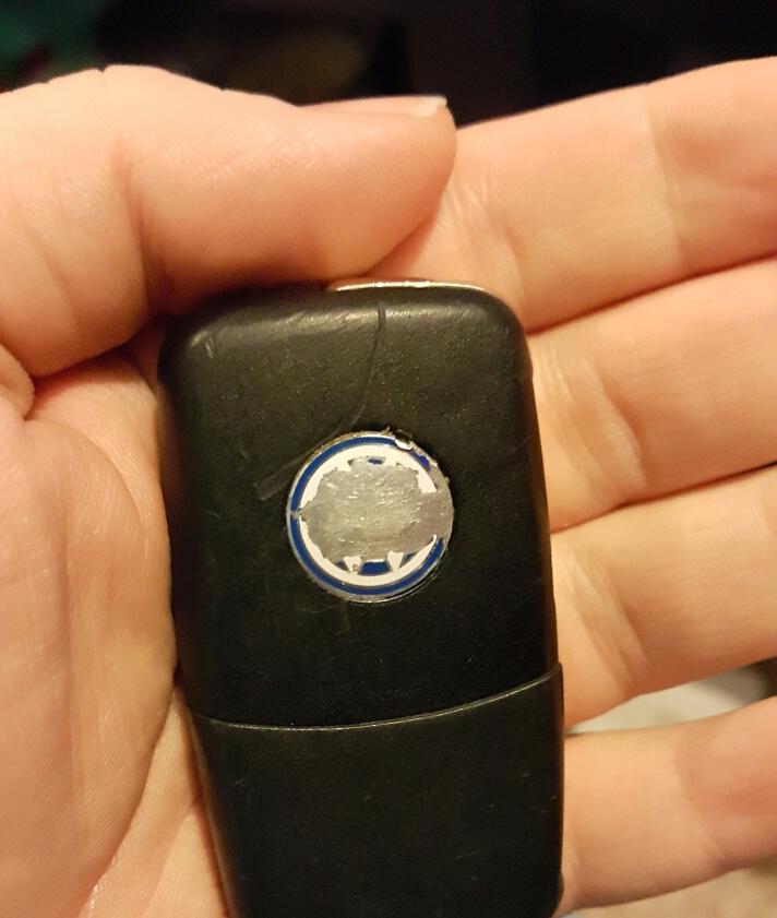

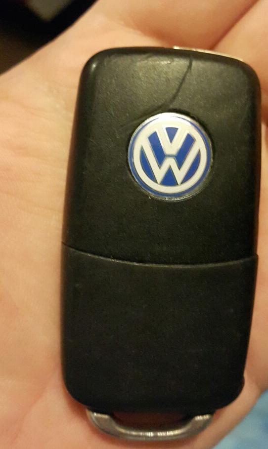

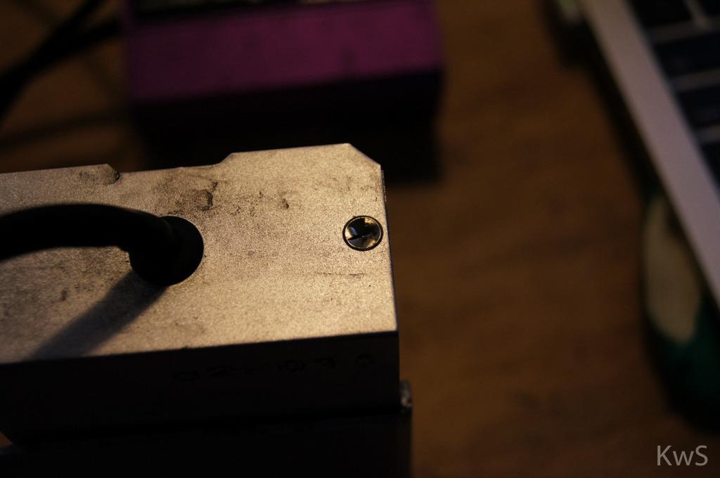

Lame question, but how did you get the old VW logo off the keyfob? I tried getting mine off with a screwdriver but I just chopped and chewed at the logo instead of actually lifiting it off...
Offline KelvinatorNZ
  • Posts: 33
Re: Shadow Blue 07 GTI
« Reply #24 on: July 27, 2015, 03:40:44 am »
no worries. I used a tiny little jewelers flat blade screw driver to lever it off. You can see the little mark i made when i started to lever it off in the first photo at about 1 oclock position. Once i got the blade under the edge the badge just popped off.

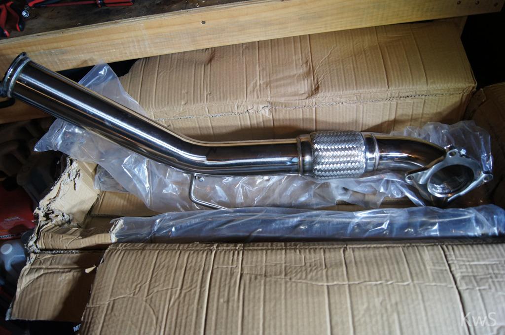

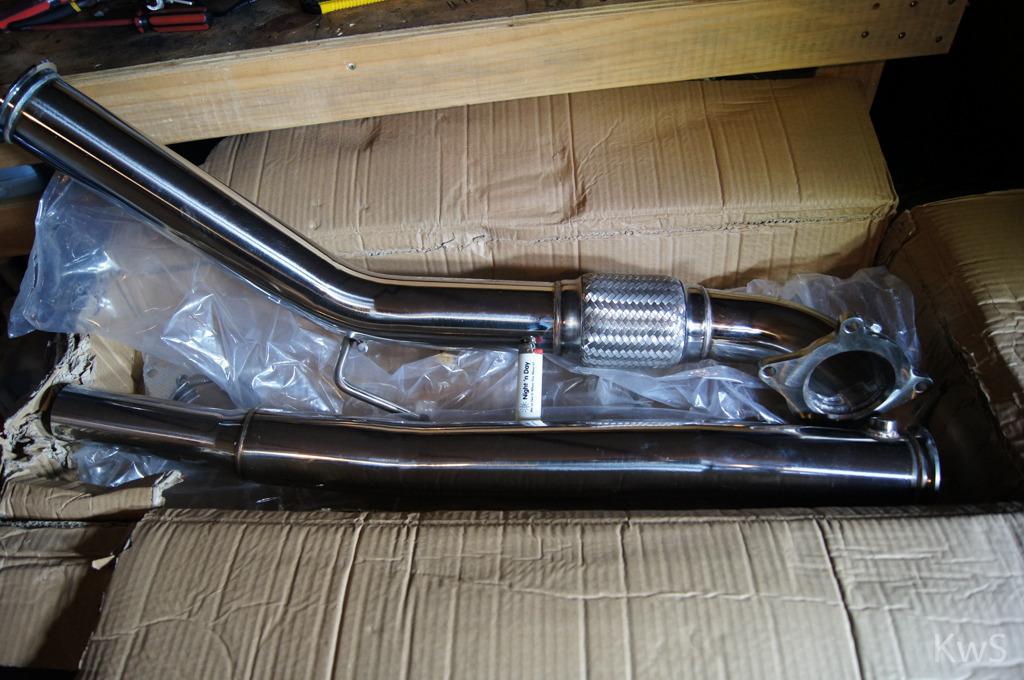

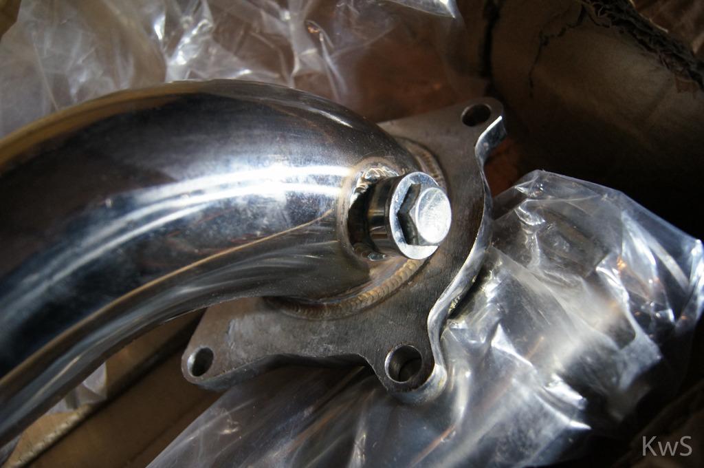

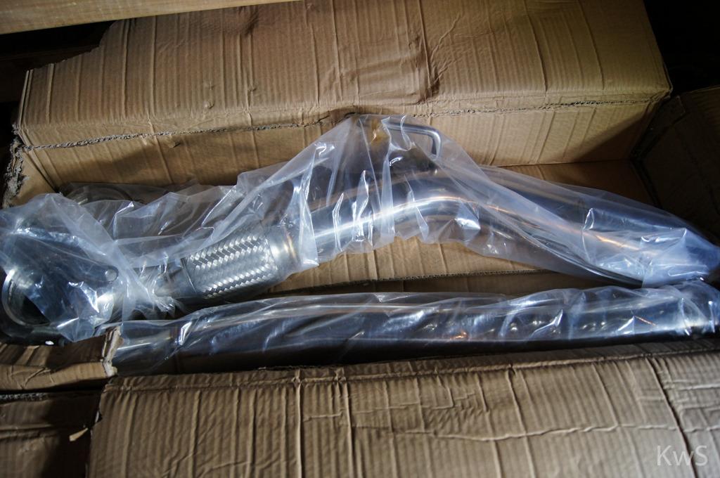

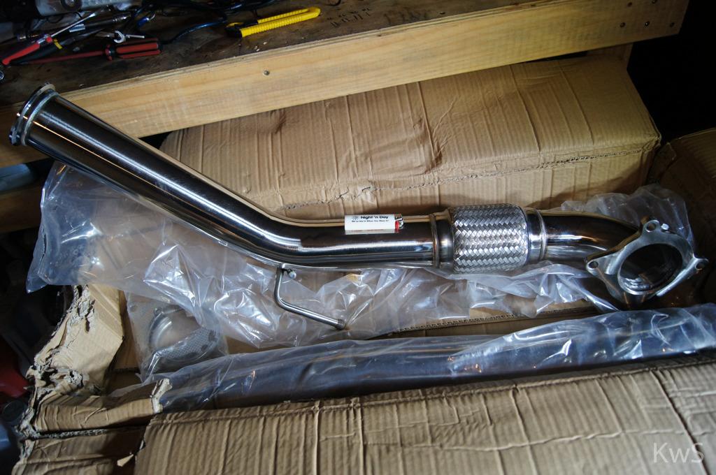

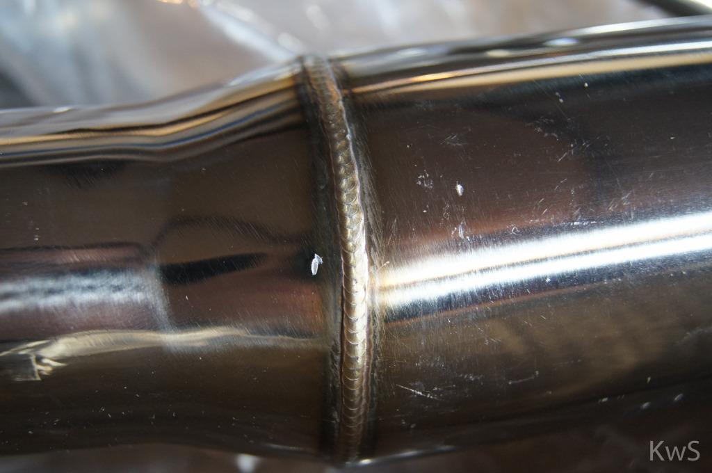

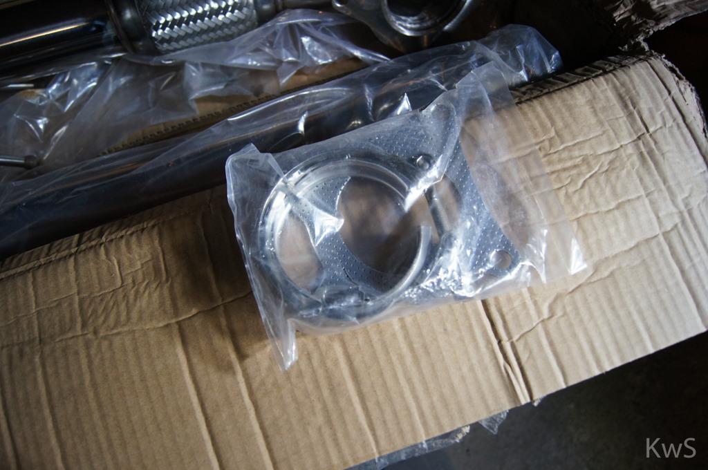

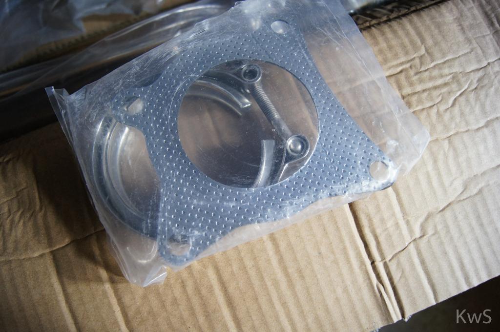

Got the pipe home, and had a decent nose over it. Preliminary investigations show that its actually pretty well put together.
Packaging couldve been better, the flange was poking out of the box (heh) when i got it, but seems although it was sticking out it hadnt been bashed around and was OK.
The stainless is very shiny

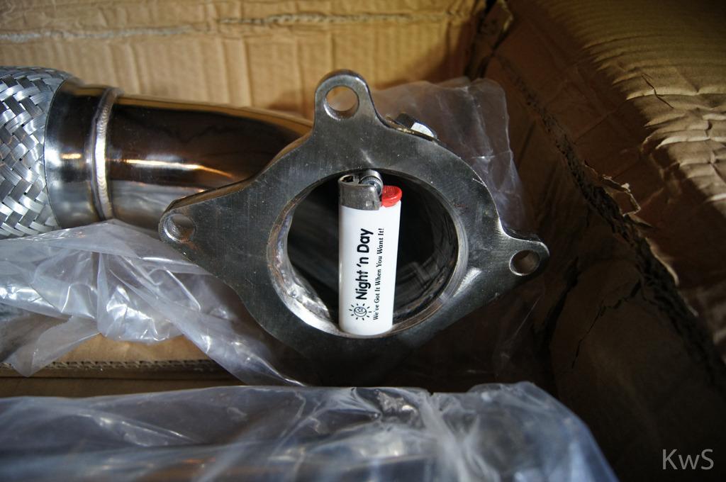

The pipe is also pretty damn big. 3" with bellmouthed flange. Standard size lighter for scale.

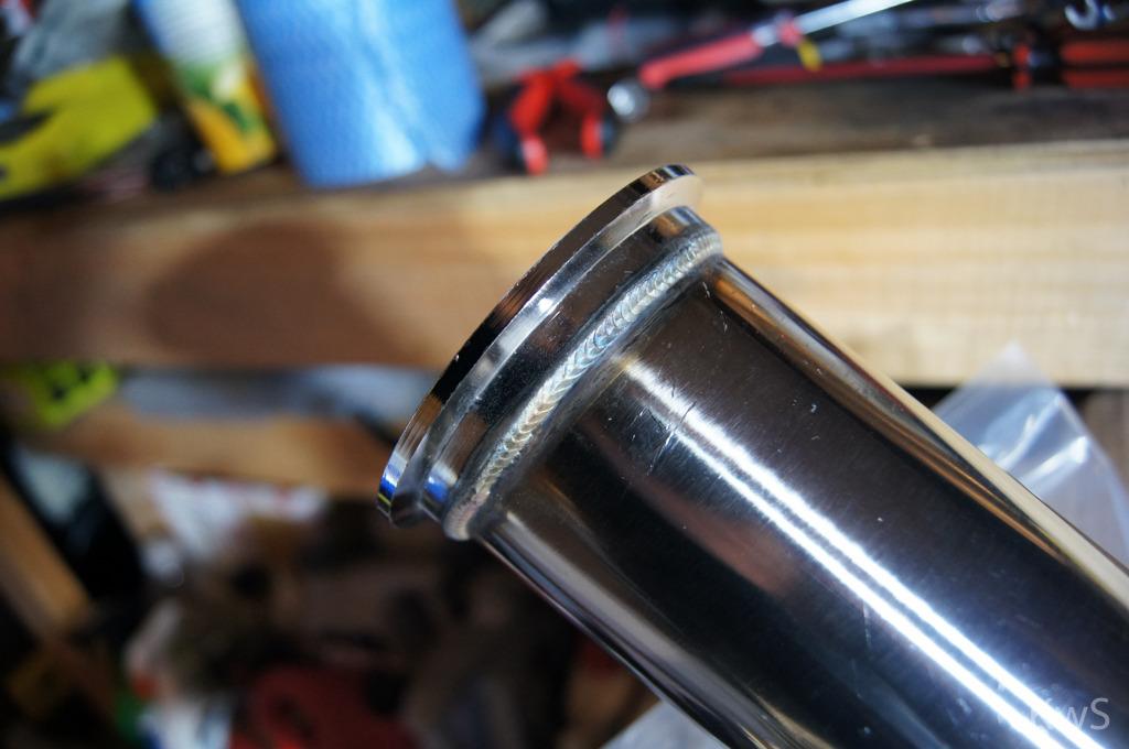

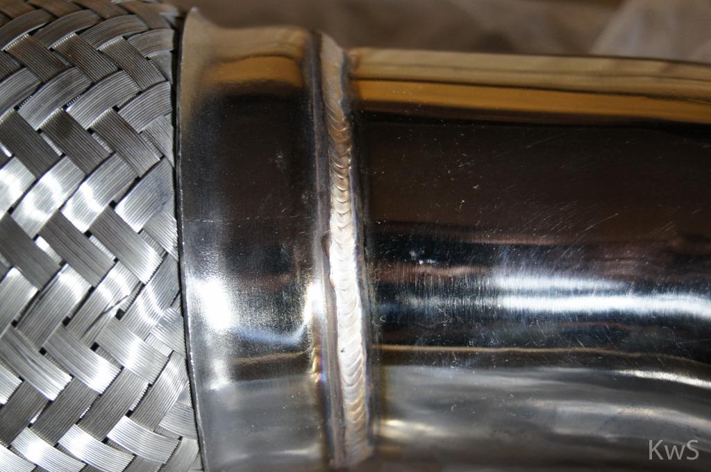

The welds are pretty decent, tidy with no splatter or obvious holes. Good penetration.
Comes with VBand to join the sections, and a new gasket for the turbo (although apparently its better to reuse the standard metal gasket)
As long as the O2 sensor adaptor arrives this week, ill endeavour to have this fitted this weekend. Sound clips to come.

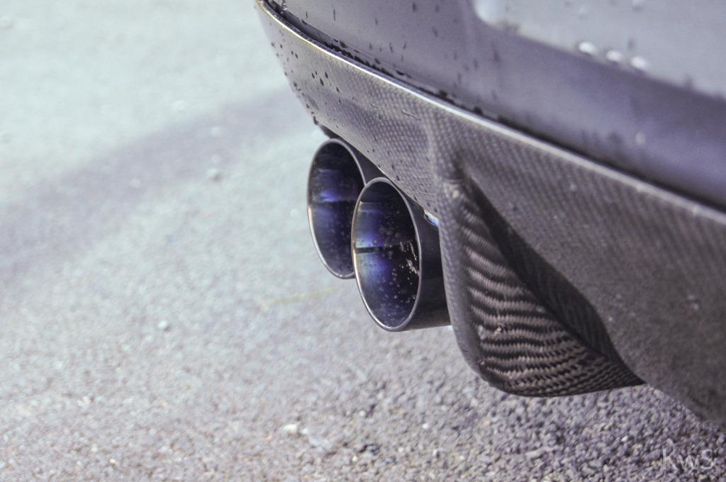

Hi mate, any idea where the rear carbon bumper piece came from? It looks nice IMO
  • Posts: 33
« Reply #28 on: July 28, 2015, 10:45:46 pm »
Hi, i cant be 100% sure as it was on the car when i got it, but it appears to be an OSIR rear
Offline Martk19871
  • Posts: 188
  • Va Va Voom
« Reply #29 on: July 28, 2015, 11:01:20 pm »
Lovely, thanks, I will look into it. Like the threat btw
