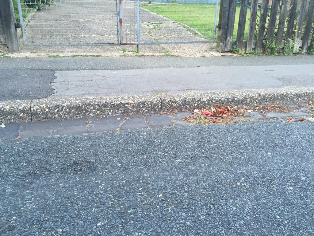

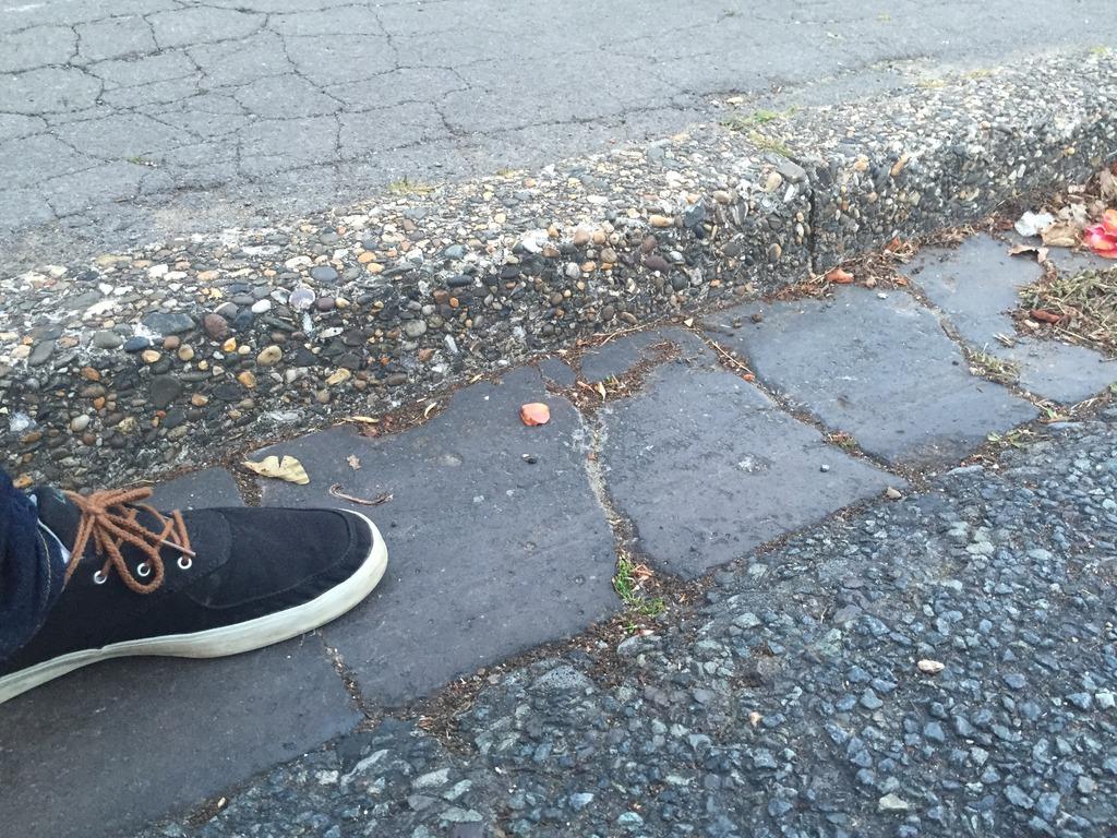

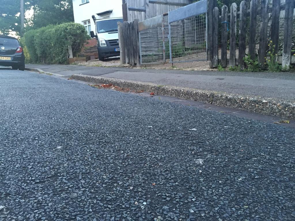

Hi there, unsure if this is in the right place but I'm looking to move house but there's a slight problem with the driveway.
The curb isnt dropped and also the road is cambered where the guttering is.
So my problem is even if I spend over the odds and get the curb dropped I'll still have the problem of the front end bottoming out as the rear would go down then up before the front end. (my golf is lowered around 90mm)
So my thought is something like the Americans have (pictured) or to put some blanks of wood in the guttering so the road would be level with the curb with the addition of the wood if that makes any sense.
Any advice on what to do would be great.
Thanks!

Yea, but I wasnt planning on dropping it as the road itself is as high as the curb, it just drops down before the curb for the guttering, so I want something to basically make it a level run from the road to the curb without dropping it, because if I dropped the curb my car would just bottom out going down then up if that makes sense!
