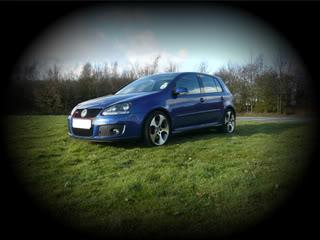

I believe the Rim King's car is fitted with the said springs: -
:drool: :drool: :drool:
Re: *pic request* eibach sportline's fitted
« Reply #2 on: December 19, 2008, 10:01:27 am »
and so is Robmkv car
http://www.mk5golfgti.co.uk/forum/index.php?topic=257.0
and mine will be in a few weeks  :wink:
