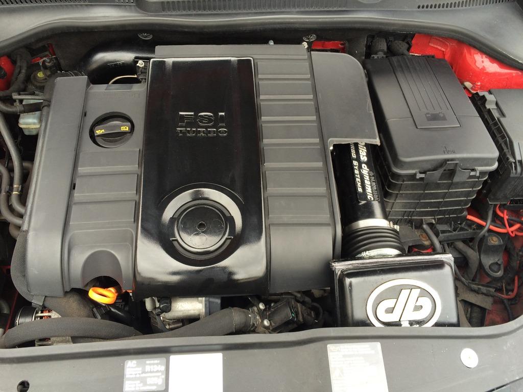

A minor update, got myself a second hand engine cover, saves cutting mine up. It looks so much better already although I do need to swap the badge over, plus I'm thinking of giving it a lick of paint, possibly some wrap. Anyways here it is:
Also gave the car a good clean yesterday before the rain started and couldn't resist a picture out in the countryside

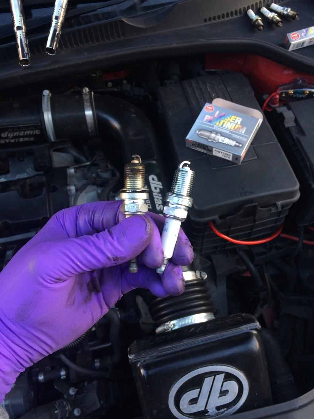

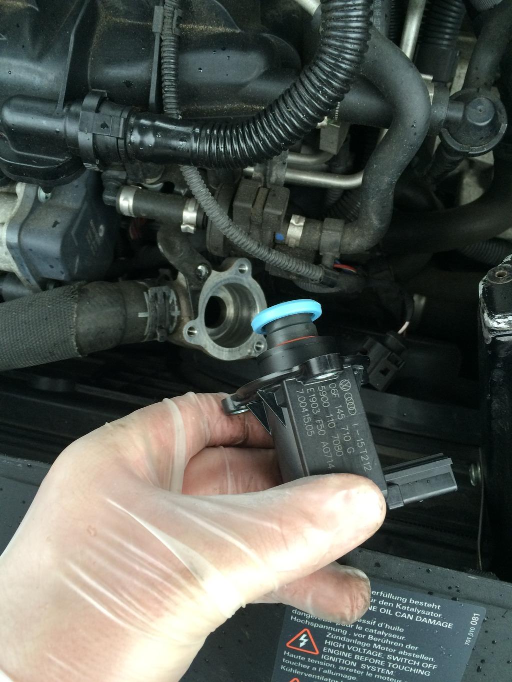

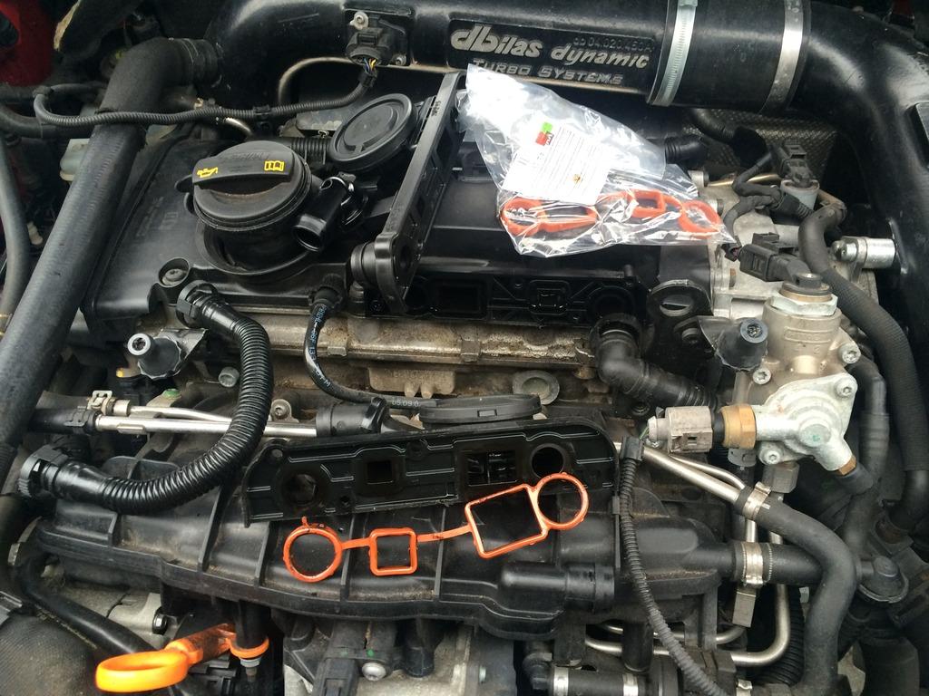

So I had a problem over the past few weeks, initially I thought it was some bad fuel but after running down and refilling with V power nothing changed. So my car was hunting at idle and struggling when in the lower rev range. After a diagnostics scan multiple faults came up including misfires.
Changed the plugs:
They cost a few quid
Then came a new revision G DV:
I got a second opinion from Colin Gunning's in Hertford, they immediately knew and told me to change the PCV, which had been my initial thought:
New vs Old:
Offline Rholtby

So as you can see from the above I got a bit done and thankfully the new PCV solved the issue

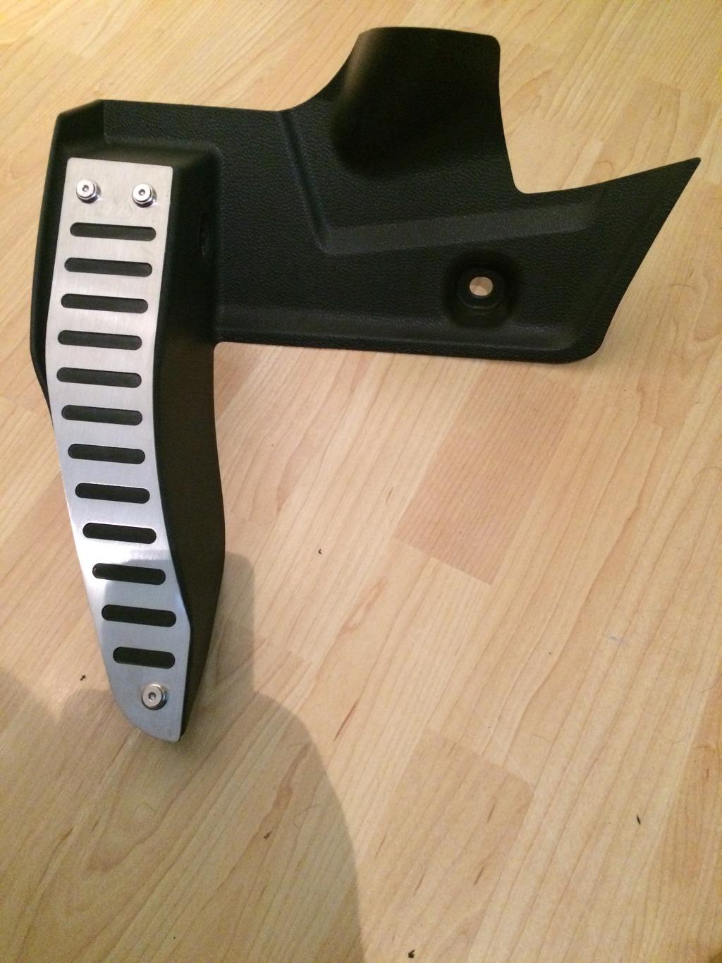

Got another couple of bit last week, only minor updates
Some new wipers:
New foot rest plate:

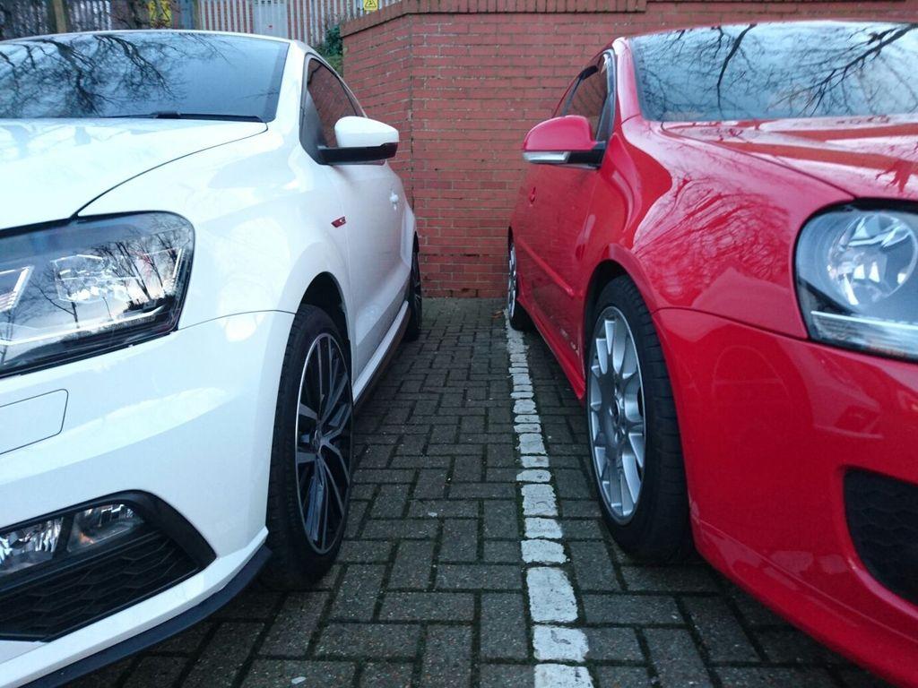

Also met up with a friend who's got himself a lovely new Polo GTI

Looking good! Like the window switch touch. My PCV also gave me the same problem, really simple fix!
