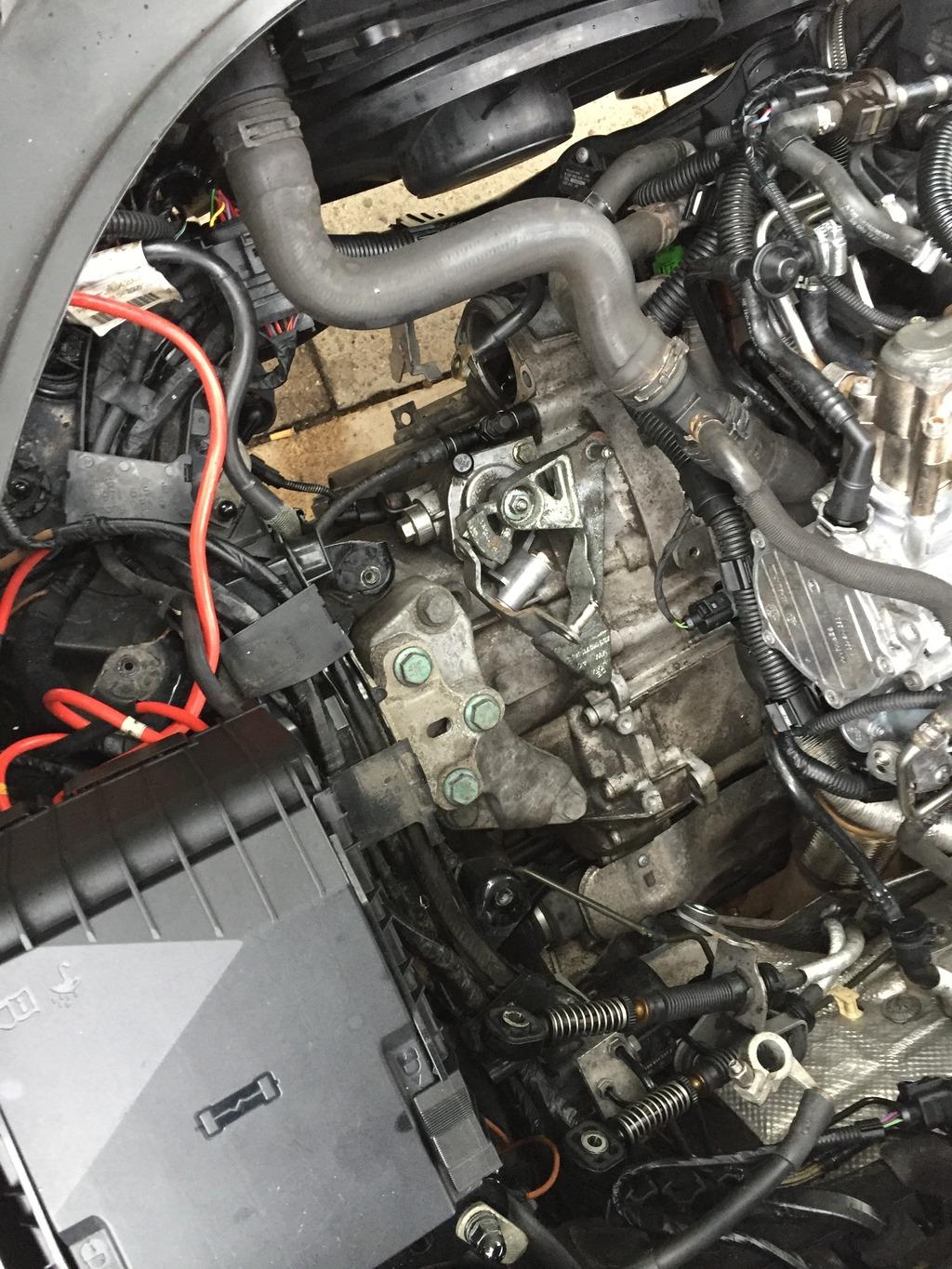

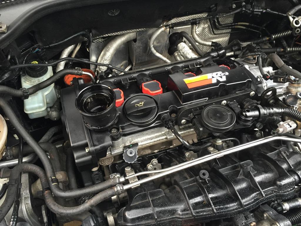

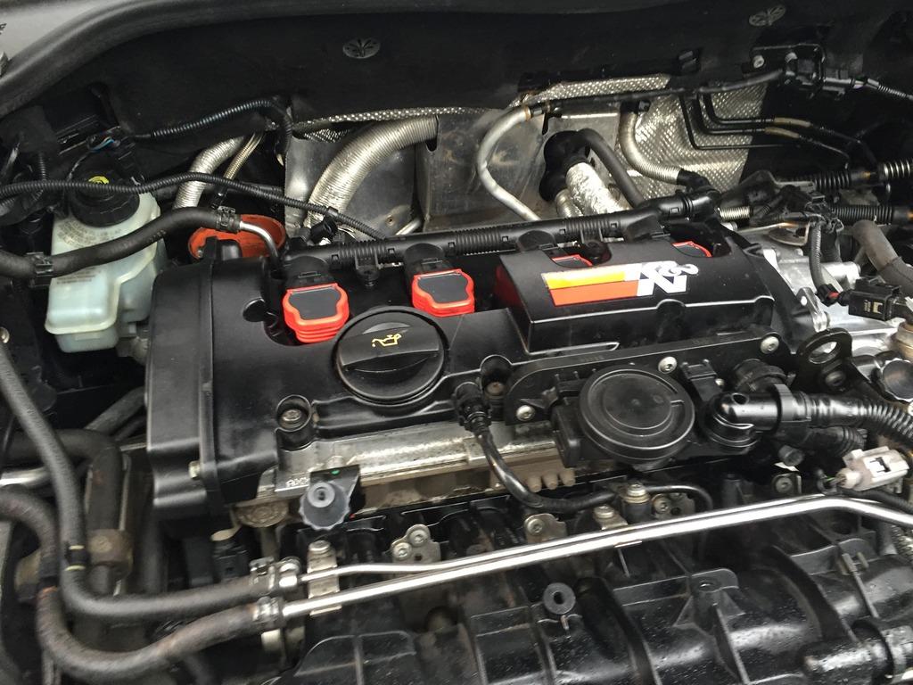

Well the sound is definitely coming from where I suspected. Also when looking threw the removable inspection panel you can see the back of the flywheel and see where the plate has been rubbing on the back of it.
So preparation for the gearbox removal got started today.
Oh and I did this...
I think it looks a lot better. Could have done without this miss hap but things done always go to plan. It will all be sorted soon. Hopefully I'll be driving her by weekend.

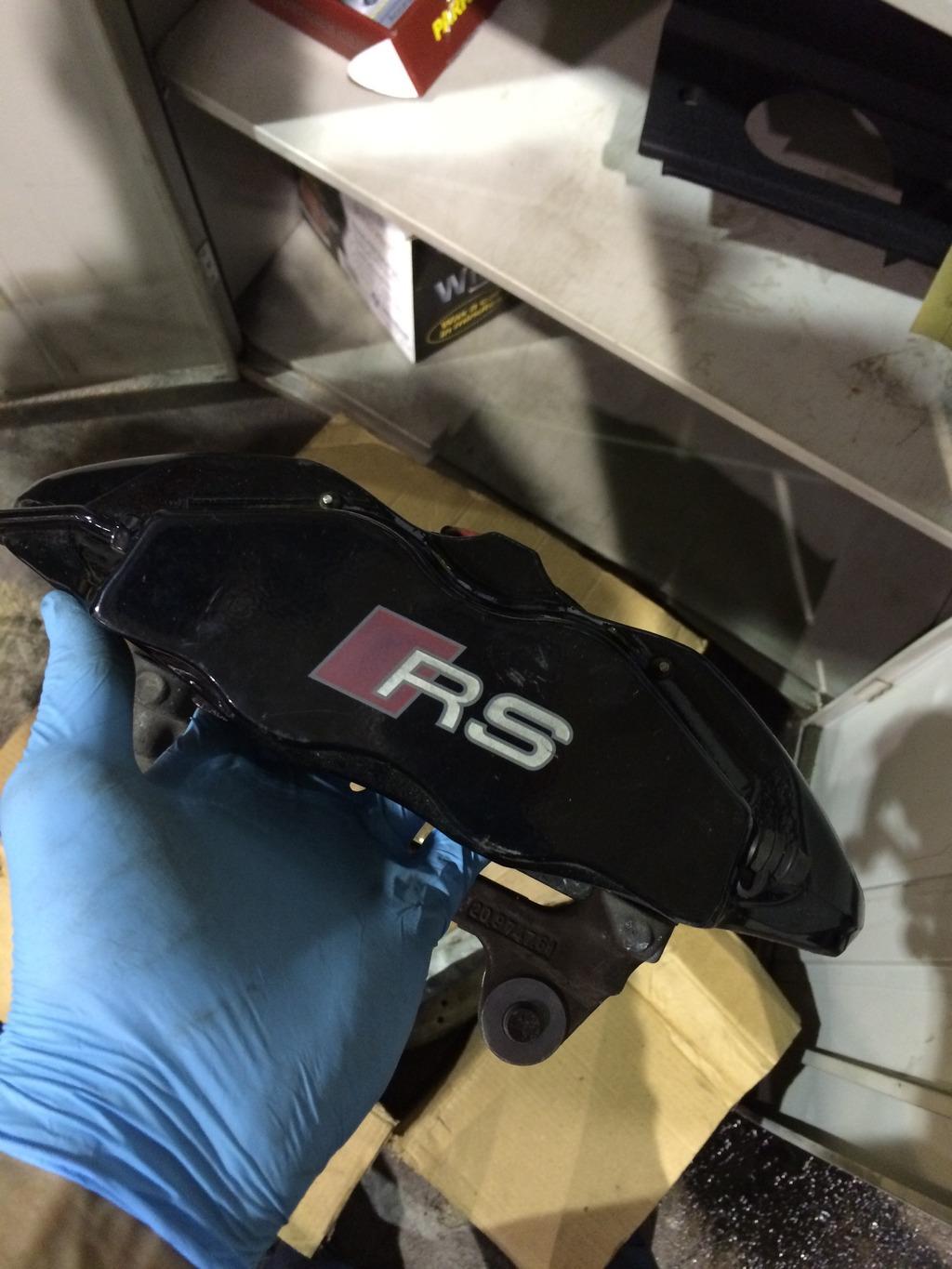

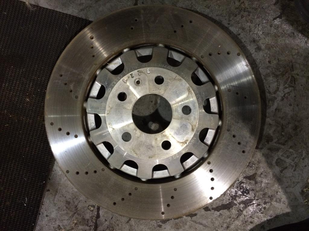

Managed to buy these off a mate today  :happy2:
