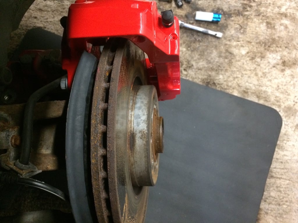

Ok, so now she is lifty i thought id best get some big stoppers.
We all know that bigger is better, so i bought myself a set of Porsche Cayenne 18z 6 pots.
I could have bought a refurbed set at £550 but i got a set for £340 needing refurbed, and it doesnt cost £210 to refurb them- so i bought them and stuff to rebuild em.
As bought;
Wanted to have the Brembo stickers fitted properly and before lacquering, so went down to Fife Powder Coating after they were coated red to fit stickers, before powder lacquering.
Done and looking pretty amazing!
Went about test fitting them with the specific bolt kit off Ebay (still standard discs) to see what spacers id need;
3mm spacers all it needs, giving the recommended 2mm clearance!
So, 3mm hubcentric spacers ordered and some Mk4 R32 front braided hoses which are a direct fit into caliper.
Will order some discs and pads at the start of the week and hopefully have the setup fitted by next weekend.
I swear this needs to be the last money i spend on it!!!

Rest of my brake parts came, so theyre fitted;
EBC Ultimax Discs.
Yellow Stuff pads.
HEL red coated braided lines to suit Brembo calipers.
Stance+ 3mm hubcentric spacers
The standard GTI brakes
Comparisons
And them on
Unfortunately the Merc discs are 1mm thinner on the face making the wheel too near the caliper, so Ive had to order 5mm Stance+ spacers to compensate, so no wheels on pictures yet!
