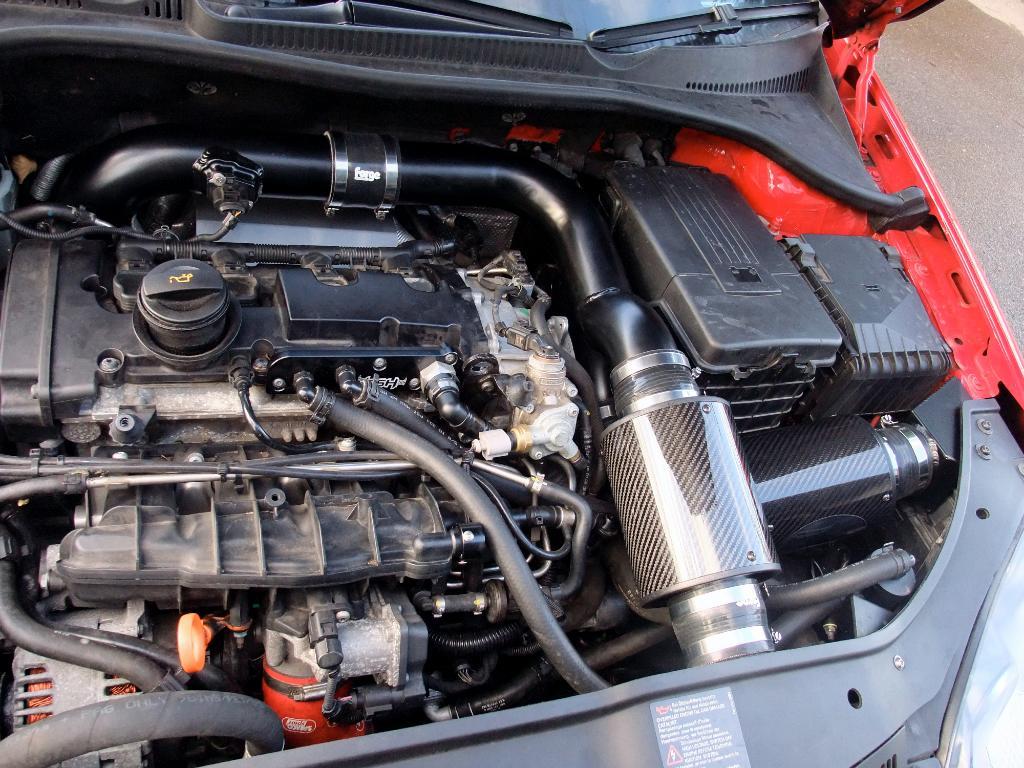

Most aftermarket specialists agree that the Volkswagen boffins were right to position the stock inlet at the top of the front grill just under the bonnet's leading edge to ram air to the filter. Forge have placed their TWINtake's principal inlet in the same position. They are not the first to do this but they are the first to also position an additional inlet and second, twin filter in the side behind the headlight.
In development Forge conducted tests with both one and two filtered inlets and surprisingly, the addition of the second sealed inlet behind the headlight showed an increase in airflow and power over a single ram air design. Incidentally they plan to release a single filter version in due course.
TWO INLETS + TWO FILTERS:

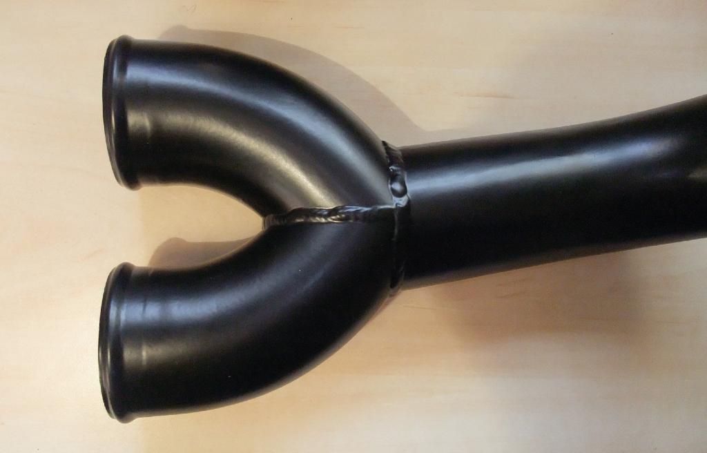

Most people on first setting eyes on the TWINtake (Forge's spelling) are very puzzled by there being not one but two filters. Does this work? But how can this possibly work efficiently? Is it just a gimmick? TWINcooler, TWINtake, are Forge now committed to only giving birth to twins? In my effort to understand this unusual intake I asked myself these questions and more. For those readers who are interested the answers are fairly lengthy:
Having twin filters is not a new idea on cars but Forge decided in early 2009 to investigate its potential for the 2.0T FSI engine (and now TSI version). As a relatively small English company with an established good reputation they would not have released it without spending an appropriate amount of time ensuring it worked flawlessly.
The main idea, though, is to create sealed inlets that allow for the introduction of the coolest ambient air possible. There are numerous debates among 'internet experts' but if the turbo system heats the air by say 50-70C before it hits the intercooler and the intercooler takes that back down by say 30-40C, then every degree colder your intake air then the lower your intake air temperatures are going to be post intercooler.
Cold air intake temp + Turbo increase temp - Intercooler reduction in temp = IA Temp in the manifold.
Apart from having the largest total possible surface area to the filtering media there are other benefits to a twin filter setup: Consider that a given filter size will present a given level of restriction to airflow, based primarily on the density of the filtering media. This will result in a given level of vacuum after the filter. Two identical filters, of the same level of restriction, applied to the same application as in this case, will apparently double the effective airflow possible by decreasing the restriction by roughly half. This will equate to more power potential.
The incorporation of a second filter doesn't introduce more airflow volume. The 70mm piping, which Forge say is the max allowable for proper MAF calibration, will only flow a finite volume of air regardless of the number of filters used. Higher flowing air filters, however, provide for a reduction in effort required to draw air through them due to a decrease in flow restriction. A larger surface area through which airflow is introduced, provides for the least possible restriction in flow.

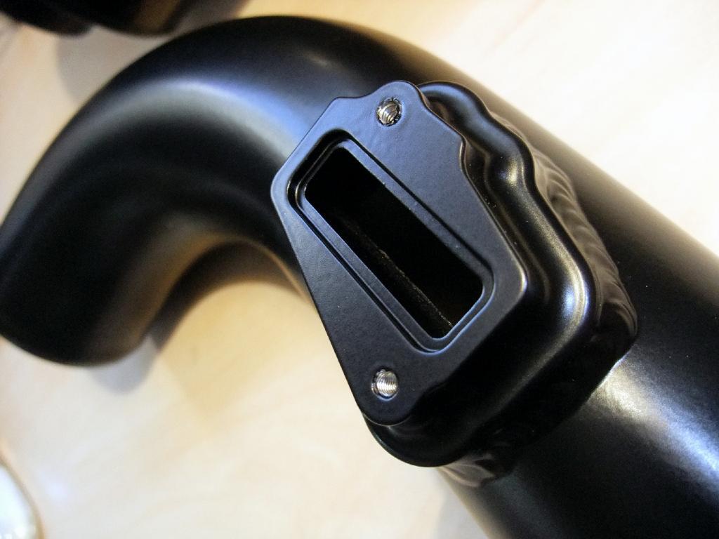

The oem MAF housing incorporated into the stock intake/airbox assembly is actually ovoid in shape and is roughly equivalent to just under 70mm (inside diameter). The piping Forge use is 70mm (outside diameter). Once you factor in the wall thickness of the pipe, this is virtually identical to the stock MAF size. This is the same size piping Forge have been using in all of their 2.0T specific intakes for years now. I have specifically questioned Forge about this and am assured that there are no issues with MAF calibrations whatsoever.

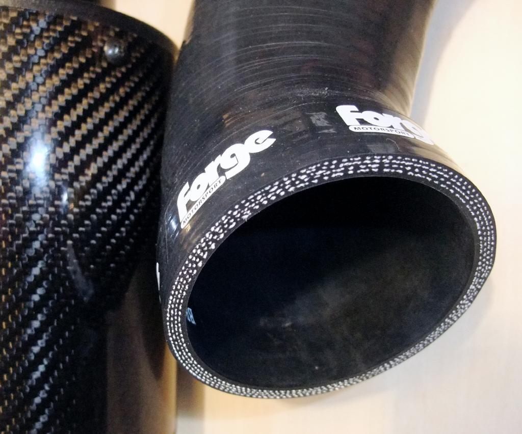

As with everything I've seen Forge produce, the standard of manufacture is very high. It's the small touches such as supplying all the jubilee clips as stainless which reflect a pride in their work and are very satisfying for the customer. Installation is further made easier by both the orientation of the silver Forge stickers on the cannisters and a small arrow moulded on each end cap which indicates whether inlet or outlet - See under cutaway illustration of the filter and photos below. If you find displaying the two shiny silver labels too blingy for your taste it's very easily resolved: Either remove the stickers completely or, a better option if you ever want to sell it on in the future, simply fit the cans so the labels are hidden.
When fitted, the TWINtake is exceptionally well anchored and simply doesn't need any additional fixings along the length of its pipework. The two metal inlets are bolted down at the front and then it bridges along to being firmly attached at the turbo, so technically it's a free floating unit but a very rigid and strong one. The TWINtake is fitted independently of the engine except to the turbo so isn't adversely effected if you do have any engine movement (engine rocking is guaranteed with stock engine mounts).

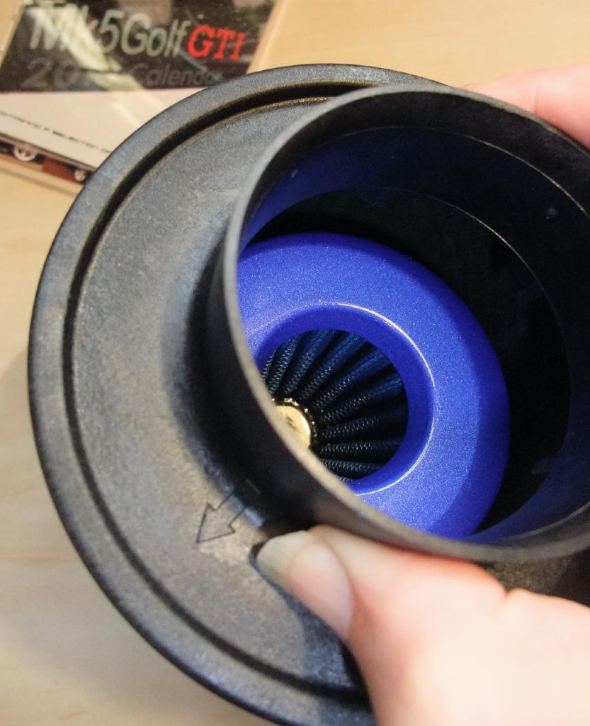

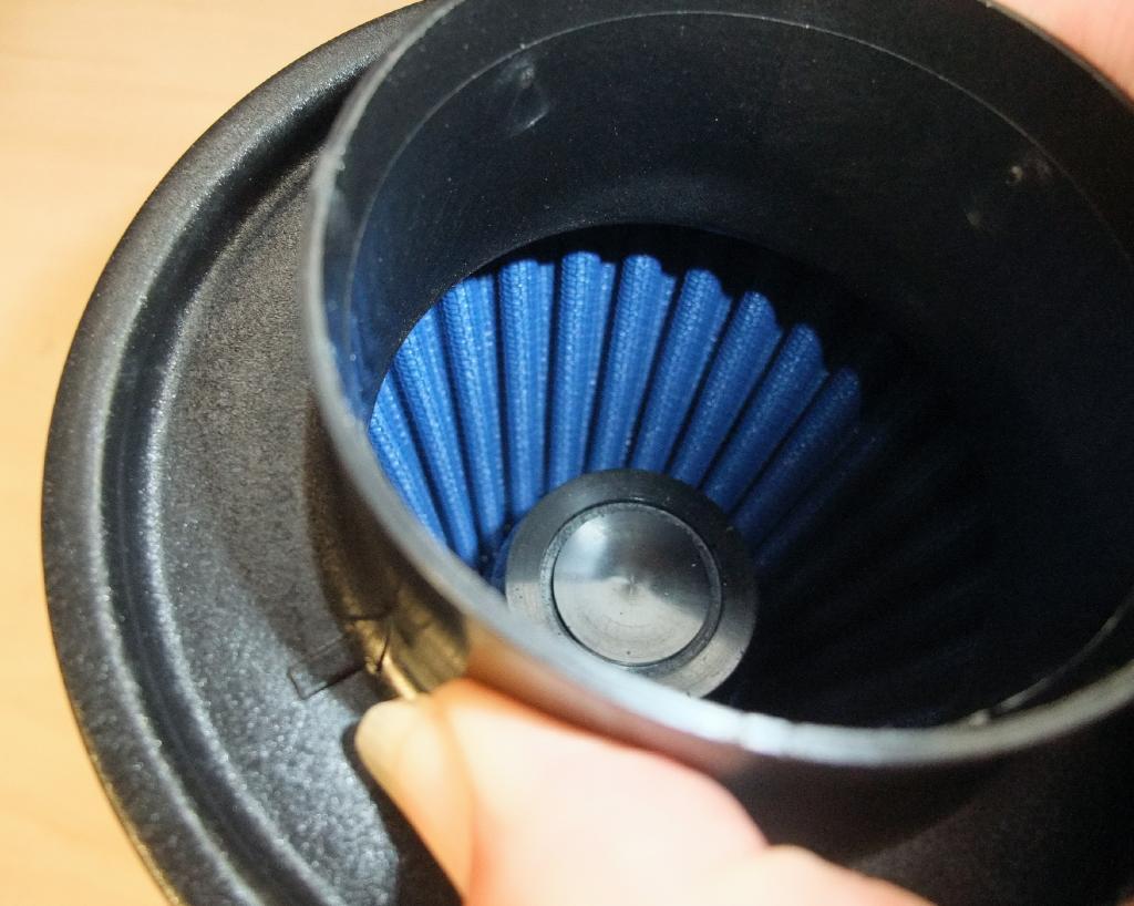

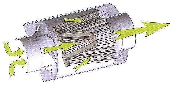

^ Filter manufacturer's cutaway illustration to show correct orientation of filter.
Forge UK, contrary to Forge USA, initially advised the opposite orientation! To be fair, it is very ambiguous and, to date (early September 2010), tests have shown that reversed orientation is not detrimental to function nor performance in any way. Obviously the filtering ability remains unchanged and any changes to flow will be minimal, likely imperceptible. This is now Forge's official position.
I am expecting to hear from Forge soon about their position and advice regarding those of us, includes me, who have their filters the 'wrong' way around.

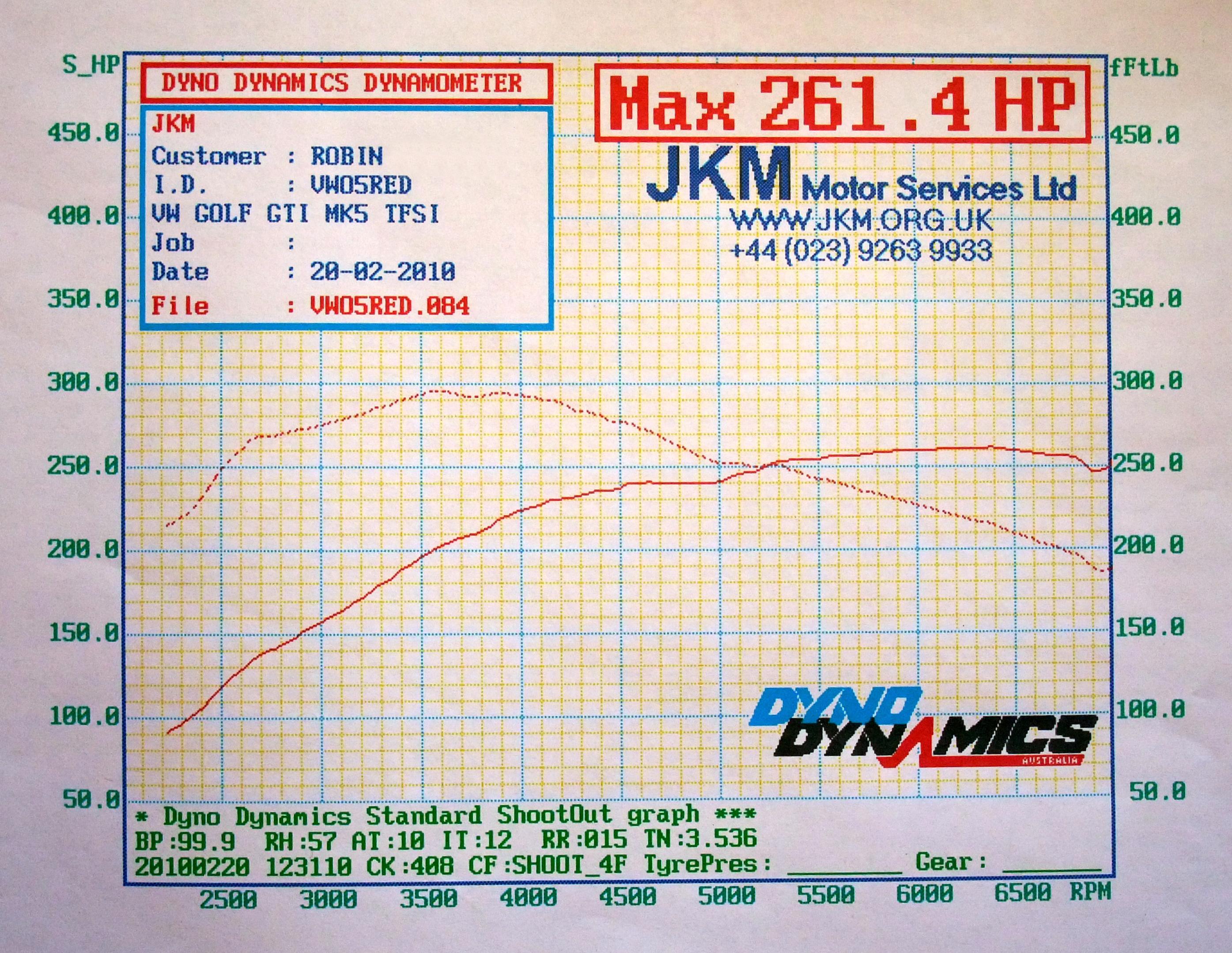

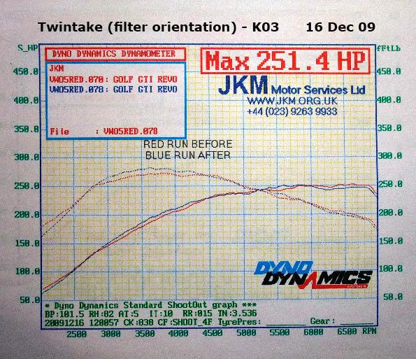

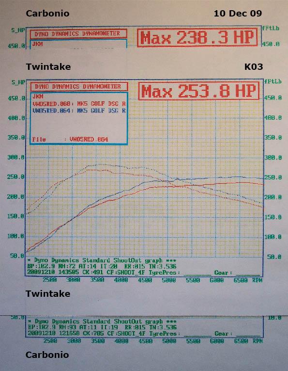

Here are the first session plots comparing before and after the installation of the TWINtake, BUT the filters were fitted the wrong way round - This was partly due to someone in ForgeUSA including an ambiguous photo in the installation pdf and partly because JKM followed the usual practice of the smaller end of a cone-shaped filter facing forward (suction end). This has now been corrected but I am including the graphs from both the rolling-road sessions we did. My car, a K03 GTI, stayed on JKM's Dyno-Dynamics rollers the whole time. The graph peaking at 238.3 bhp was with a Carbonio ram intake plus ITG panel filter and the 253.8 bhp was with the TWINtake fitted. Air to Fuel (AFR) plot was flat-lining in both cases as it should do. Revo2 was already set B7 / T5 / F9 for the Carbonio and later adjusted to F8 after the TWINtake runs.
On my K03 GTI on the first dyno session day, we saw a healthy increase of 15.5 bhp. So, if the Carbonio adds say 4 bhp (some claim 7 bhp but who knows for certain?) to stock, then the TWINtake theoretically delivers more neddies if compared with oem.
Accepting that any and every rolling-road 'test' of an air intake cannot reproduce what actually happens on the road we can only make relative comparisons. Consequently I decided to have another dyno session but continuing from the previous session by firstly running the TWINtake with its filters and velocity caps still the wrong way round and then directly comparing runs with the filters fitted correctly as designed. The incidental bonus from doing this was that we obtained data from the car in exactly the same state but on two separate days a week apart. Except that on the morning of the second session my car turned out to not be in exactly the same state because it had blown an O-ring and had a very minor boost leak. Ideally I needed to go for at least a 50-mile drive to get everything settled in after this was repaired but this wasn't practical. The resulting dyno curves were 'bumpy' as the ECU dynamically made whatever adjustments it felt were necessary on the fly. Such are the difficulties of closed loop systems as exist in the 2.0T FSI ECU. The highest bhp we saw plotted was 255 bhp but the whole curve reflected much variation.
So the conclusion at this stage is that the Forge TWINtake gains very similarly to the EVOMS when fitted to a K03 car, namely about +15 bhp. Logically, as the EVOMS has been seen to add about +20 bhp to a K04, one would expect the TWINtake to perform very similarly and hence matching the K04 performance of the ITG intake.
PERFORMANCE UPDATE:
On the same rolling-road at JKM a couple of months later which obviously has given plenty of time for the ECU settle etc - A healthy further increase in power and especially torque. Nice curves as usual and testament to JKM choosing the right Revo settings:

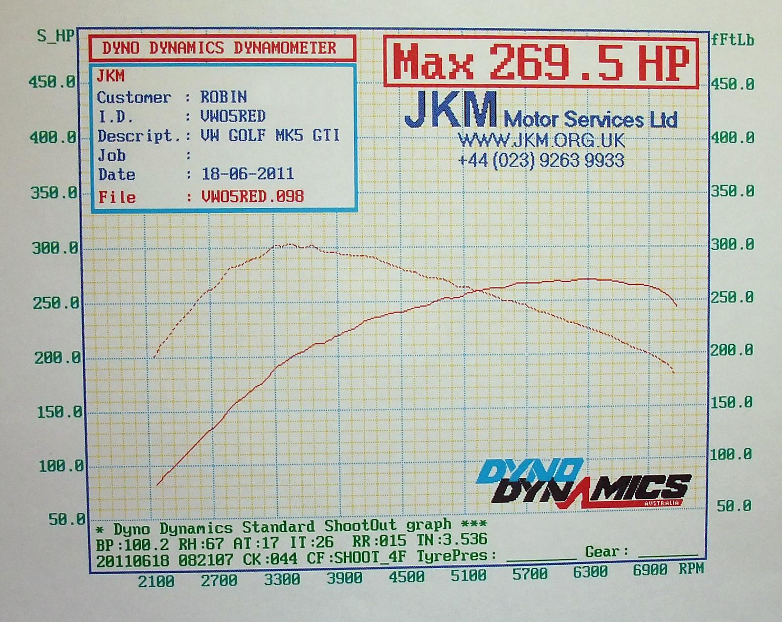

The latest (June 2011) dyno session at JKM - Everything has now settled in nicely:

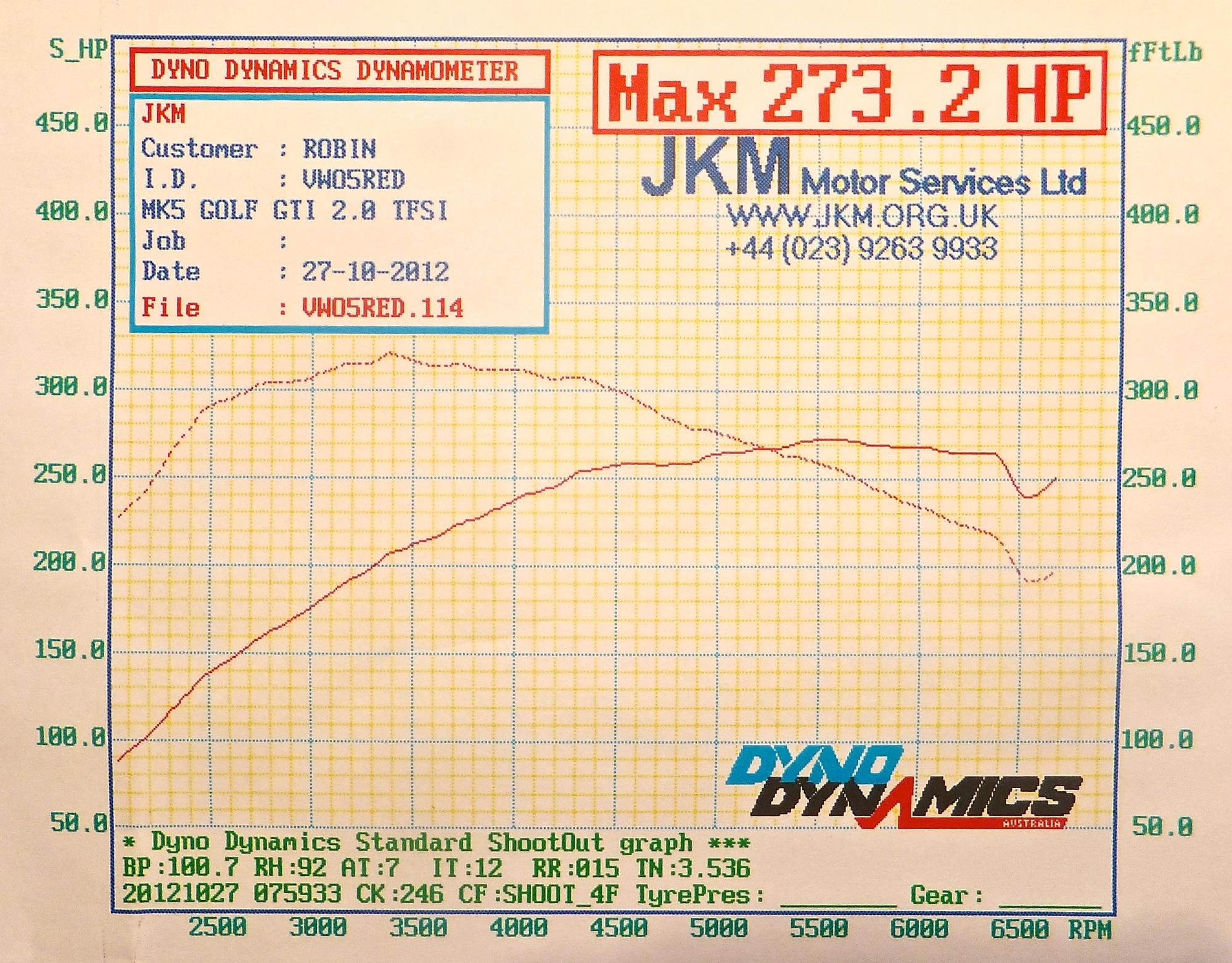

October 2012 dyno session at JKM:
The only other performance mod has been an APR High Pressure Fuel Pump. I am currently running on Revo Stage 2, B7 / T5 / F7.

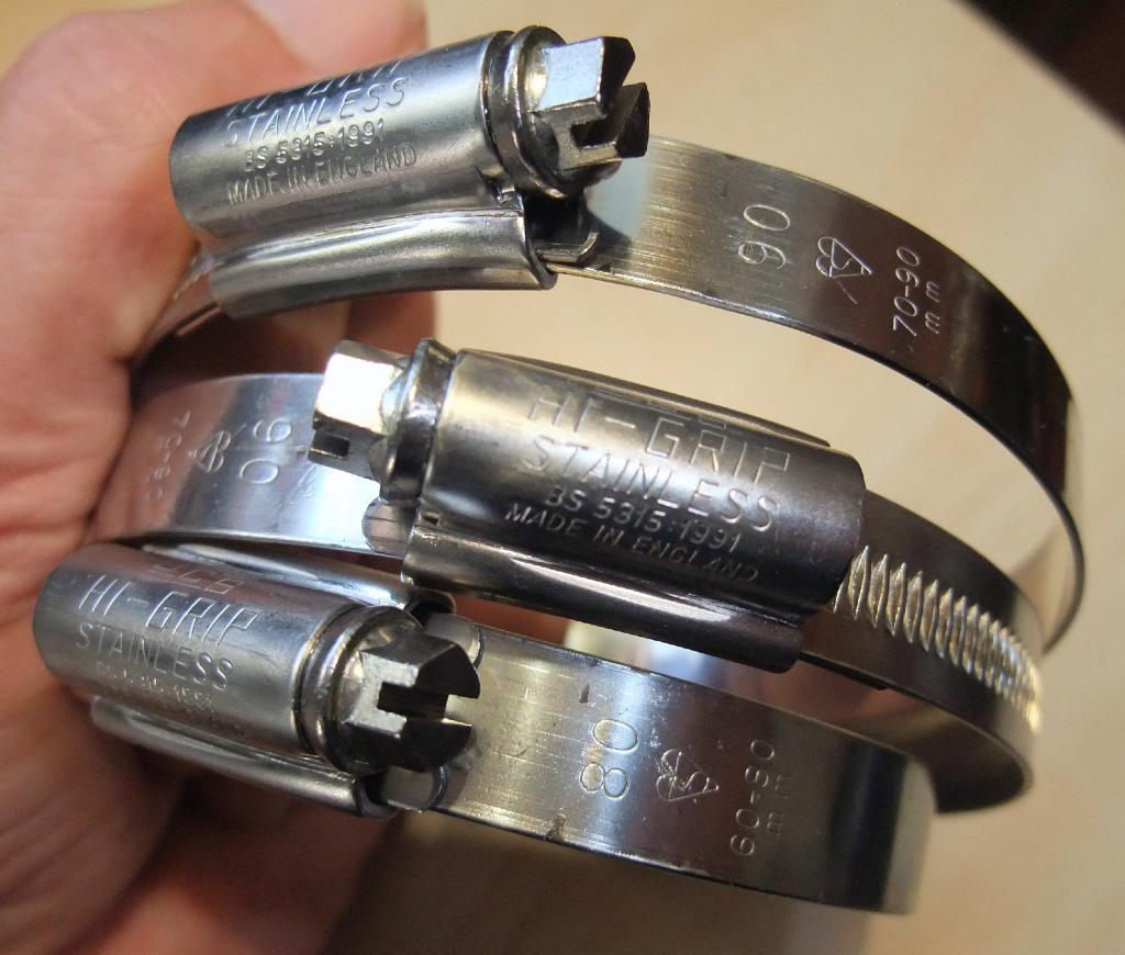

- A good quality heatshield is included and optimises the available area - Each supplied according to your engine code.
- Extremely well made with great attention to detail such as supplying jubilee clips as stainless.

I'm at work so cant see the pictures but can read the text.
superb and very thorough writeup thanks Robin.  :happy2:
just the right kind of total LOTS :pomppomp:
would be good to have seen your correction factors before and after.
Remind me going from 9 to 8 on REVO fuel setting is that more or less fuel?
can we have some MAF flow figures please?
like you I'm still confused on the 2 filters is better than 1 but ITG only needs one but gets same power.
still not convinced on the 'lack of bracketry' but if i was buying an intake then this would be 1 of my 2 choices ( :wink:)
another top addition to the product section, top man.  :drinking:
(maybe we should create a mk5golfgti handbook and sell for profit  :xmassmiley:)
....Cheers, John  :drinking:
MAF flow figs would require riding out with the laptop IIRC. We didn't have time but Dom might be happy to when we next meet.
I looks as if what both EVOMS and ITG have achieved with one open filter, Forge have achieved with two enclosed filters. I don't feel that we can judge any one of them as been far better than the other two - All three appear to deliver very similar benefits - On K03 +15 bhp and on K04 +20 bhp - These can only be guide figures.
Personally I don't like the sounds of the EVOMS, I'm not keen on the appearance of the ITG (but I may love its sound the most - I don't know yet), but I like everything about the Twintake.
Re the fixing 'bracketery', I can absolutely assure you that the Twintake is planted very firmly indeed but without being rigid - A bit like sitting on the wing of a car with good suspension, it hardly moves but can move.

So does the circa 15 bhp make the car feel any different on the road, if so how??
9 is leaner than 8...   :xmassmiley:
cheers , intuitive with the increased airflow but not having REVO I wouldnt want to quote wrongly  :happy2:
