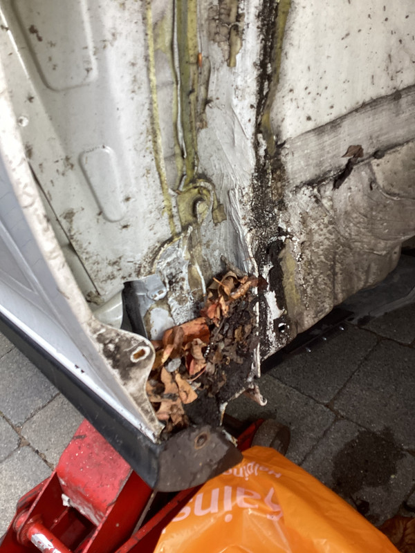

Removed front wings today, found this little collection!

That's just stage 2 of wing crud collection - you haven't got anything growing, it would be stage 3

Honestly, I just gave everything a good clean, touched in a couple of spots of surface rust and buttoned it all back up. Removing the sponge obviously.
I think giving the front of the sill a bit of a tidy is most important. Most people will have a little bit of rust there.

I actually had two plants growing behind my drivers side one, couldn't believe it lol
