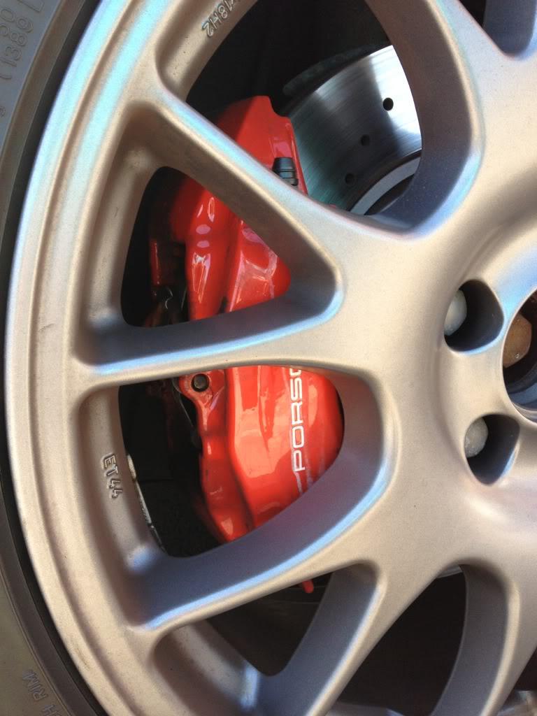

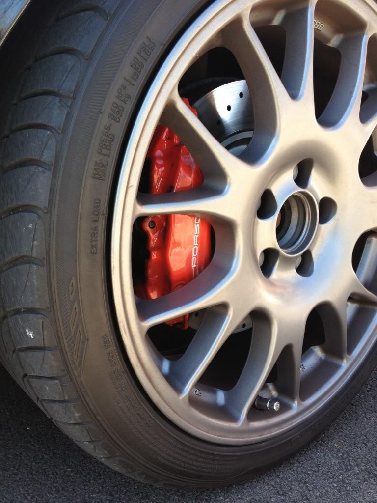

Offline sub39h
  • -Given: 189
  • -Receive: 84
  • Posts: 1719
Re: NQSBBK and BBS lm reps
« Reply #3 on: March 28, 2012, 04:07:56 pm »
all i've really got is some close ups i took for DaveB because i want one of my calipers refurbishing off him. not the best views, but hope it helps:

Offline Dan648v
  • -Given: 28
  • Posts: 795
« Reply #4 on: March 28, 2012, 04:23:49 pm »
Thanks alot for that!
