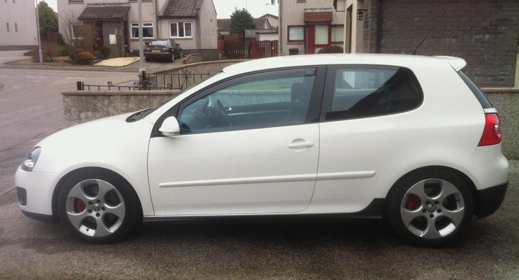

The springs have lowered the car the promised amount and the wheels now sit nicely in the arches.
The car definitely has more front end grip but has possibly reduced some of the loose rear end characteristics of the GTI, which I loved.  I havn't driven the car very hard since since fitting and the alignment is out but i'll update this in a few months again.

Only picture I have so far -
