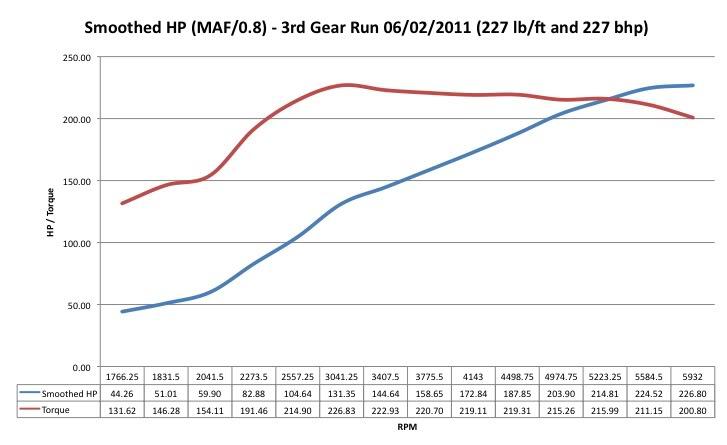

I have it with a cheap eBay adapter and managed to try it out some more today - I'm impressed by the results!
Previously I seemed to have a data rate problem but I've since changed the settings to log at 0.5s intervals and enabled faster logging to improve it. I think the data rate could be better if I had a more expensive adapter and better phone hardware, but it'll suffice for now!
Today I logged the RPM and MAF reading and did a 3rd gear run. Unfortunately I couldn't get to the point where it would change up because I ran out of road!  :ashamed:
I downloaded the log anyway and calculated the horsepower by the MAF reading /0.8, smoothed the HP reading by taking an average of the values below and above, and then calculated the torque by (HP/5252)*RPM.
Here are the results:
The book figures for the car are 221 lb/ft and 227 bhp!
I know the MAF calculation isn't entirely accurate, but the fact I achieved the expected HP shows that it should be a very accurate way of measuring any changes in performance!

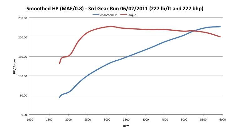

I did some more logging today up to the point where the DSG changes up. The results are actually quite consistent!
I firstly did a 3rd gear run which showed a peak of 233bhp and 237lb/ft. I then did a 2nd gear run which showed a peak of 231bhp and 229lb/ft. :happy2:
I've also since realised that to show the x-axis on the graph as a value instead of category (so that the RPM values are an equal distance apart) I needed to select an X-Y Scatter Chart in Excel, so here's the updated one:
