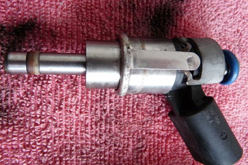

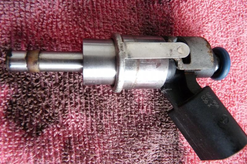

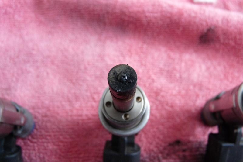

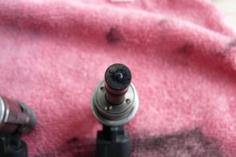

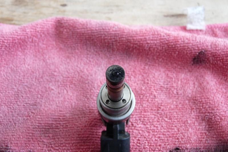

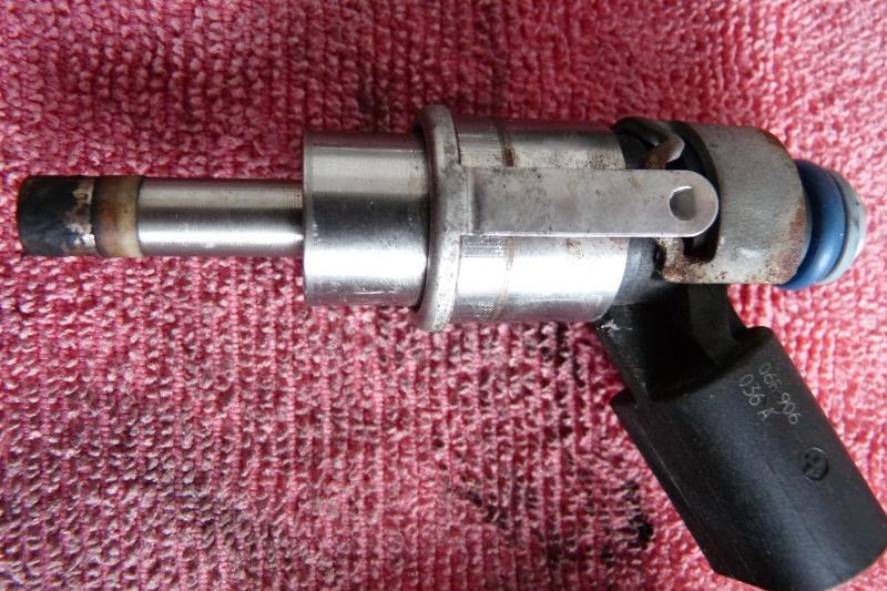

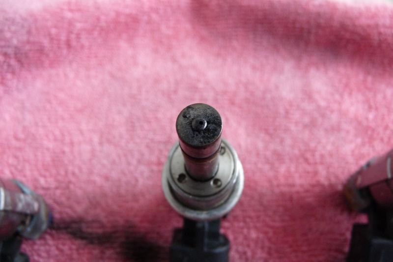

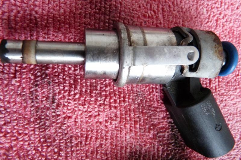

Unfortunately I didn't take any pictures of the ebay injectors but when you see the pictures of the one's that came out of my car I could probably have done a straight swap as the difference was night and day. However that would have defeated the object of finally trying to get the misfire sorted by tracking down what the actual cause was. Also bare in mind these injectors have done 153k miles, the majority of which is motorway commuting so no harmful short distance stop starting but still a bit of a shock.
These are what came out...
So as you can see 2 of the injectors look a lot worse that the other 2 and one in particular (the last pic) was the one causing all the issues in cylinder 1. I'd really like to get these sent off to injectortune for a comparison; a to see how bad they really are and b to see how they compare to the ones bought off ebay.
