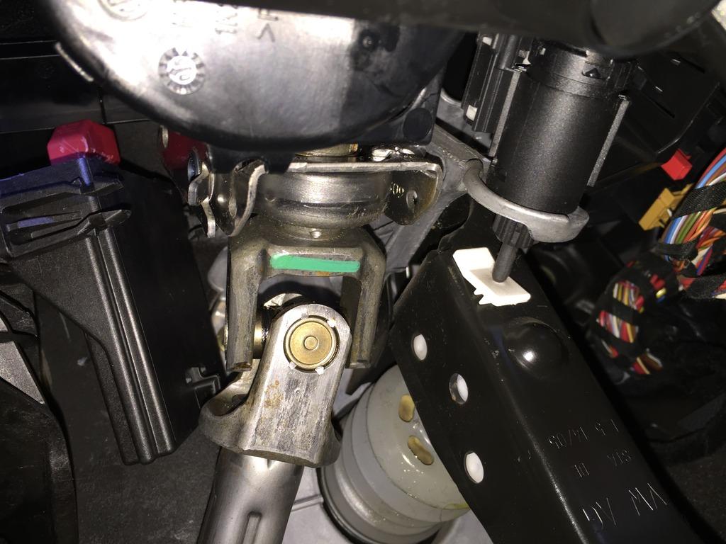

I had to change my can gateway too its pretty straight forward just in a really awkward place ! Mine is an 05 so its right up behind the steering wheel in the dash
Thats it on the left hand side  :wink:
