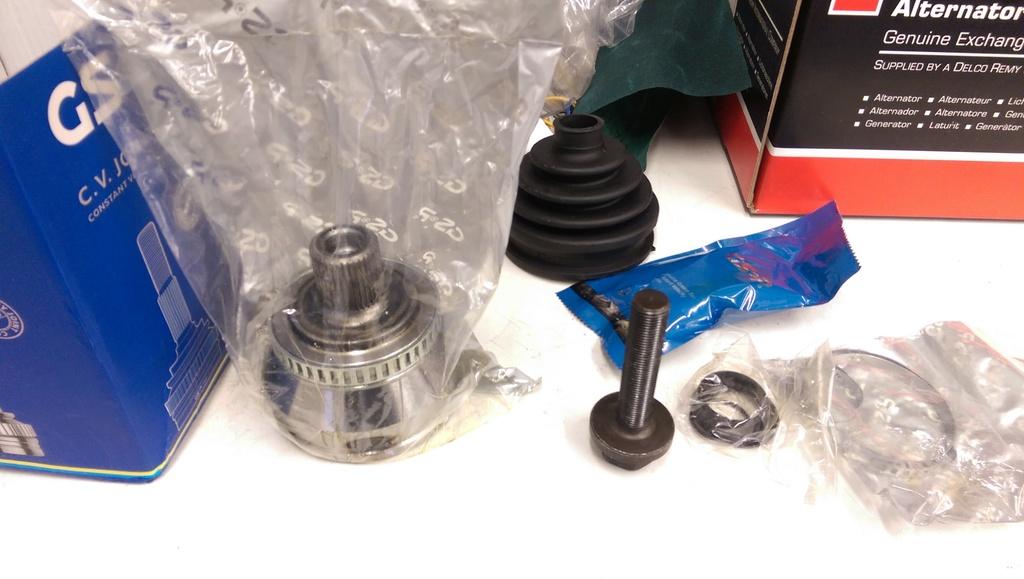

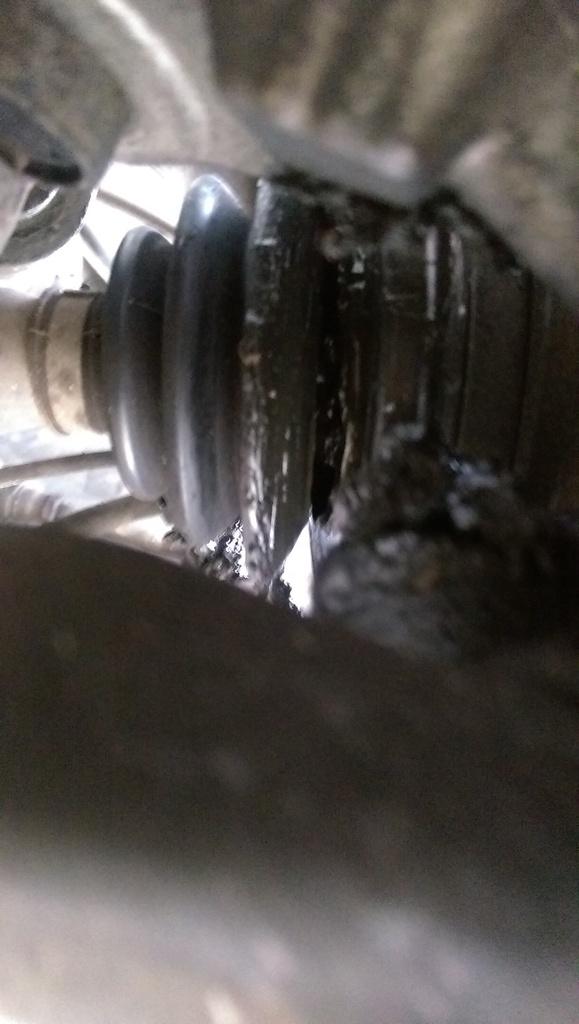

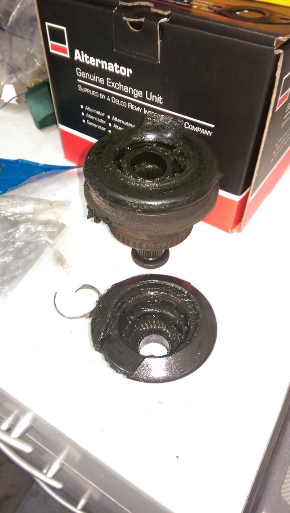

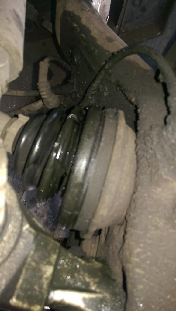

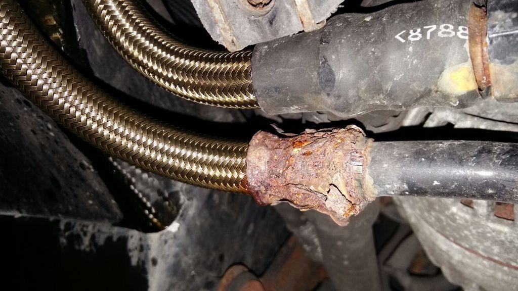

Had a puncture last week and on taking off the wheel discovered that the CV boot was split.

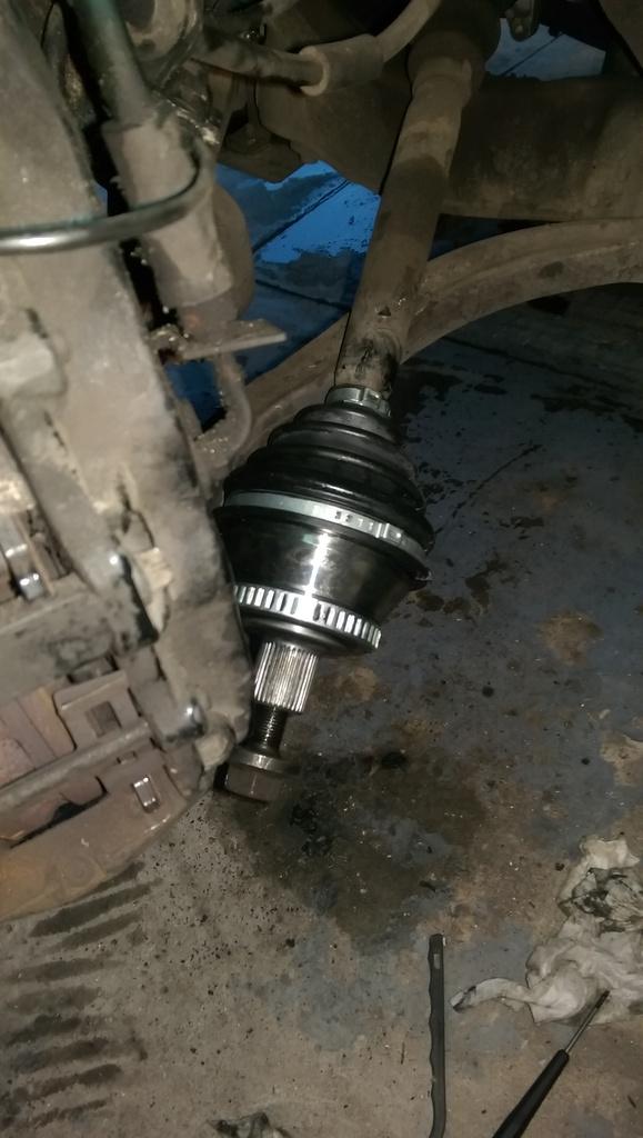

As I didn't know how long the boot had been split for and that a new CV joint kit was only £36 I decided to get the joint and boot changed.

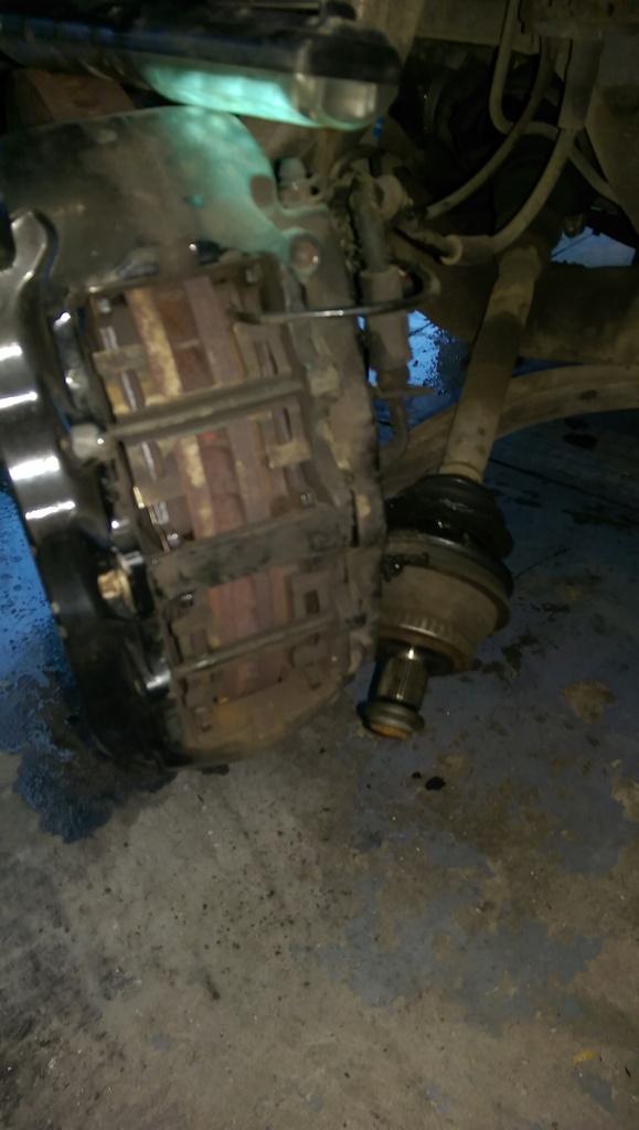

Was happy that I got the CV joint sorted, but when I arrived at my friends house for him to do the work the car decided to spring a leak as I reversed into his garage.

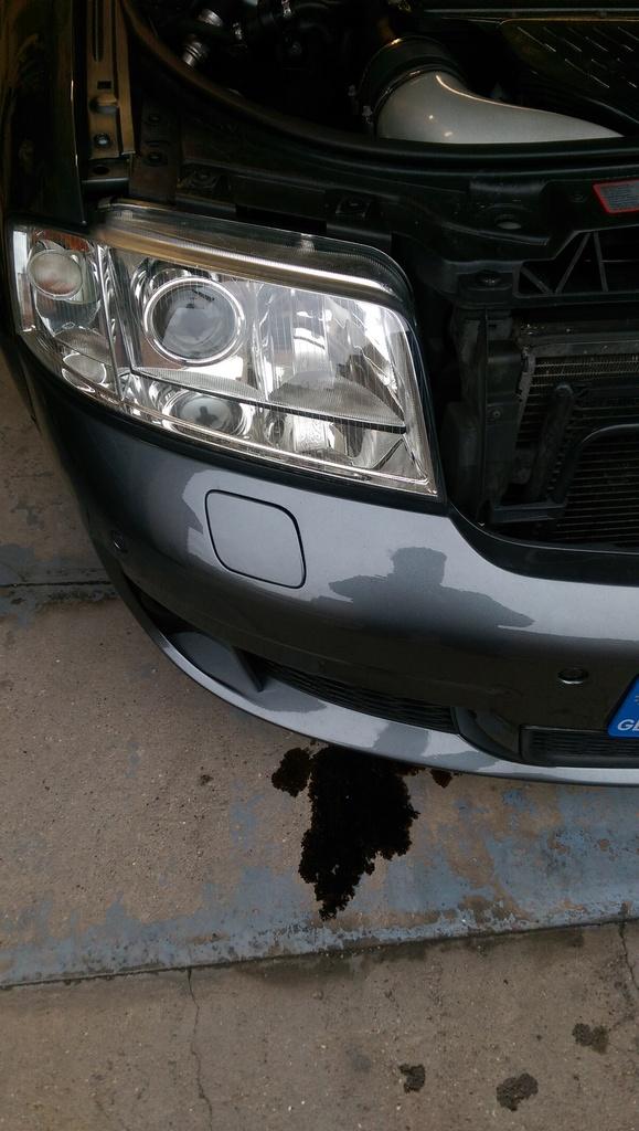

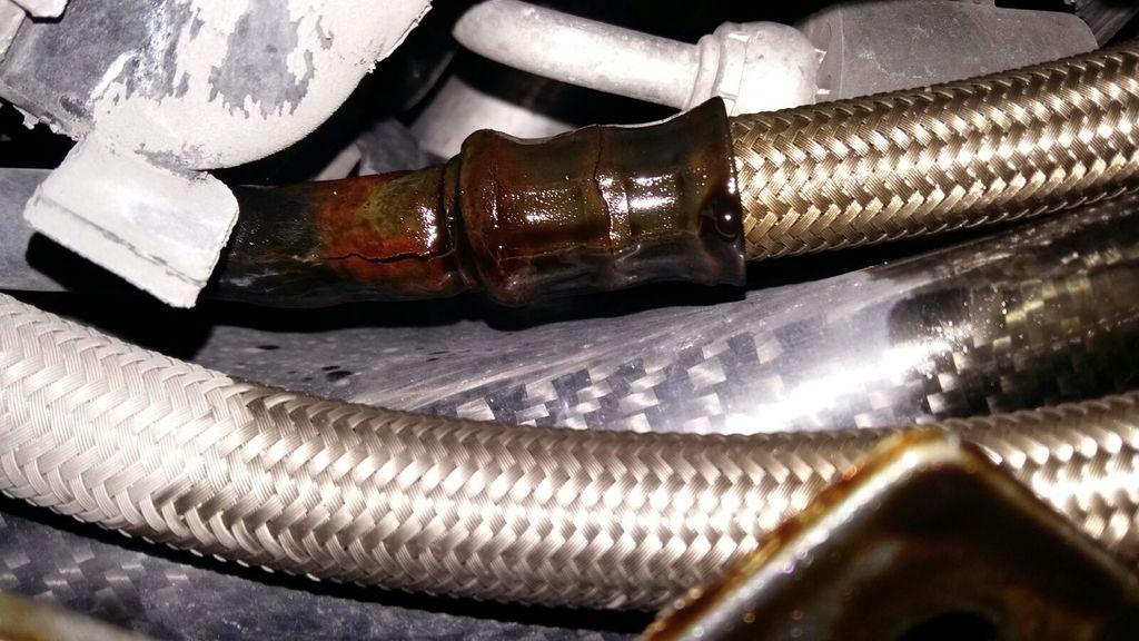

After the CV joint was done we took the under tray off to see where the oil was leaking from. The pipes on the oil/transmission fluid cooler have corroded and cracked.
Also got a problem with my drivers side headlight. Checked the fuses and changed the HID bulb, but still not working so looks like it could be a ballast or igniter.
Managed to get a second hand rear view mirror which will save me a lot of money as Audi want £209 for a new one! Also got a used Bentley books manual from the states. Find these cover a lot more than Haynes. Got a used door lock hopefully will cure the intermittent problem with the drivers door latch.
