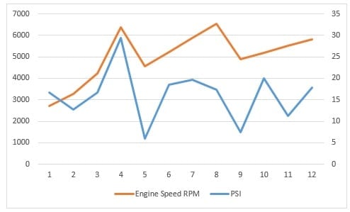

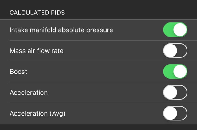

Thanks chaps. I'm pretty sure that the boost values that are being output are corrected for atmosphere. The logs also include inHg for absolute manifold pressure which, when converted to PSI, were reading 14.4 psi higher than the boost value at the same point in time.
Unfortunately the data logger only seems to write one line of data per second, so the finer points are lost. I've plotted out a run from stand still through 1st, 2nd and 3rd using the launch control. 2nd gear (points 6, 7 and 8 ) are fairly representative of what I was seeing in the instant read out (18.5psi, 19.7 and 17.3).
There is a big spike to 29psi showing, which I'm guessing isn't good.

Do not forget that almost all OBD logging using the MAP sensor provides absolute pressure readings, so you need to subtract approximately 1 BAR of atmospheric pressure to get the true positive 'boost' reading.
Subtracting approximately 14.7PSI from your readings sounds exactly like standard to me, with about 10psi peak settling down to around 6psi by the redline
post the data here if unsure
Spot on Dan, fell into the absolute reading myself many moons ago. That sounds like stock levels to me also

Definitely boosting to 20+ psi / 71 inHg Absolute Manifold Air Pressure. So either it's been remapped or something is amiss. Couple of questions if anyone knows:

I'm not convinced. What OBD tool are you using?
The turbo will not sustain 15+ psi at high rpm, even at higher stages of tune. You have an issue with your data logger I'm sure

I'm using a WiFi OBD2 dongle and logging with OBD Fusion on iOS. I do have a Chinese ScanGauge copy kicking around somewhere. It doesn't log but might be worth me plugging it in and seeing what that says.

The boost is all over the place according to your app.  Can't be very pleasant to drive like that!  A huge boost spike is typical of a Revo map but other mappers like the more aggressive approach also.
