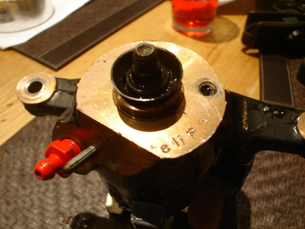

once you've removed the handbrake cable attach arm and the stop arm below it, the caliper will look like this (Its a B7 RS4 Caliper but the same process)

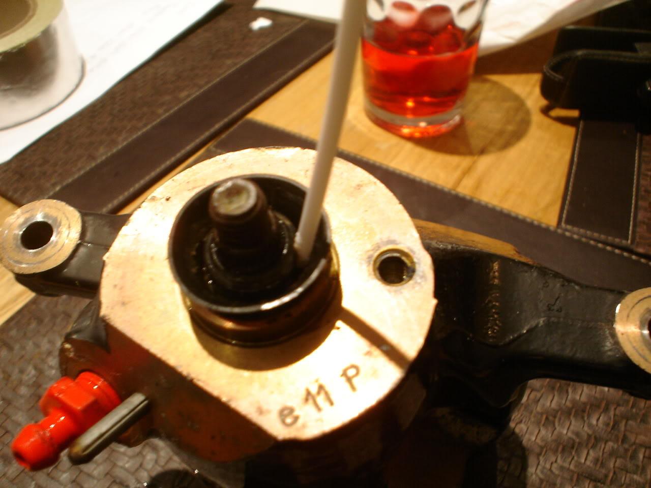

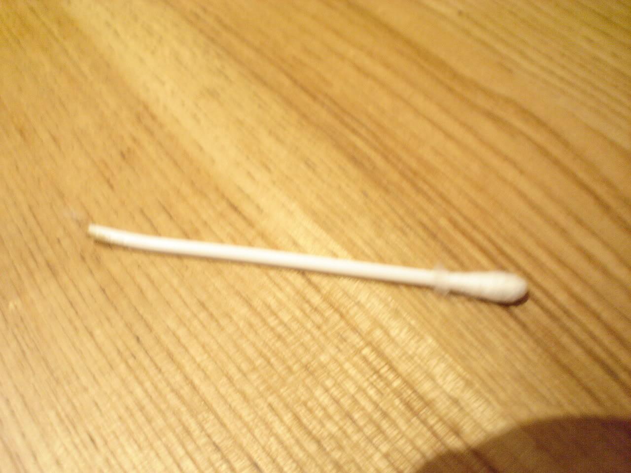

Now you will see that within the black seal that we are worried about burning is some crappy grease, you need to cut the end of a cotton bud and clean it up in there, the grease when hot degrades the rubber worse than the oven! use a TINY bit of solvent or worse WD40 to get rid of all grease and dry it out fully with some tissue paper.
Just to confirm this seal is just a dirt plug, the actual hydraulic seal is an O ring that abuts the dirt seal, its there to carry grease for the handbrake post to prevent corrosion and to trap dirt, if the seal is broken or split then I would use some speedtape to seal or "repair" it, this rubber seal "Flairs" out against the underside of the cable arm, this seal by TRW/Lucas is the same as the ones going back to the Mk3 golf so its easily available you've just got to dissasemble the caliper fully and for that you need some special uber long circlip pliers.

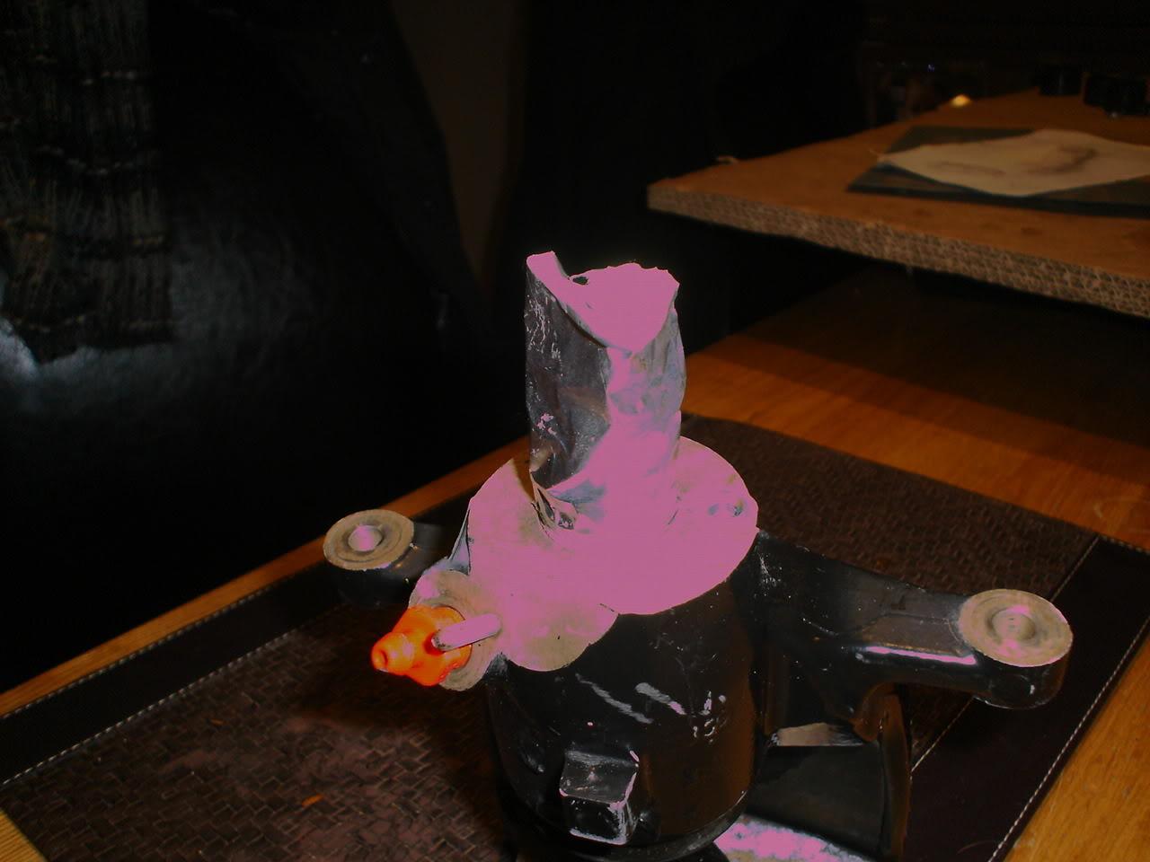

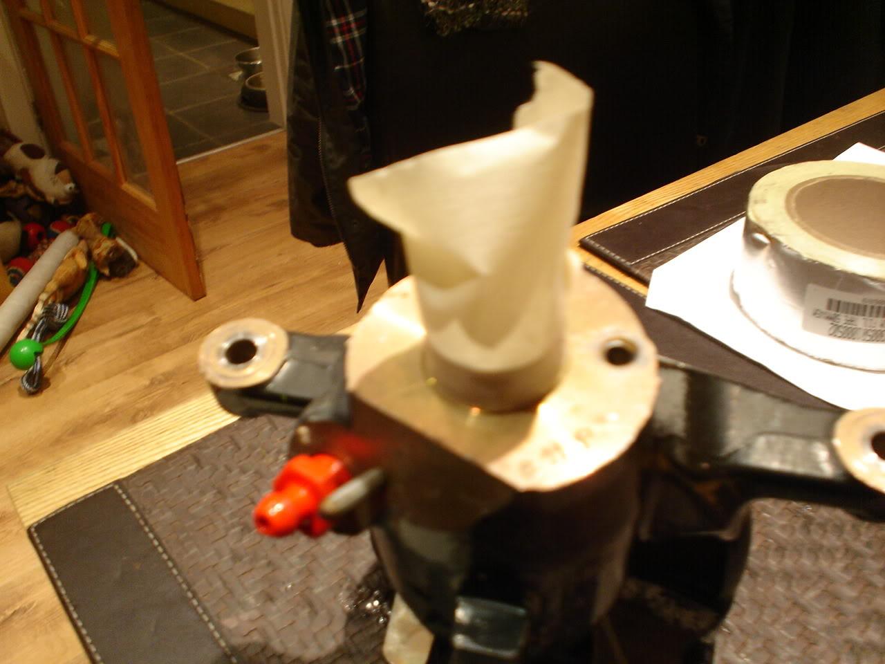

Once its clear of grease simply wrap it in masking tape and them most importantly wrap it in speedtape (Alluminium tape) its available from most engineering supply shops, its widely used in aviation circles so you can nick a piece if you know anybody (Mr Stoke Balloon has been keeping a fleet of Her Majestys helicopters airborne with this stuff and some self tapping screws for years) repeat this process to build up some protection and that areas good for the over Gas Mark 5 for 30 minutes

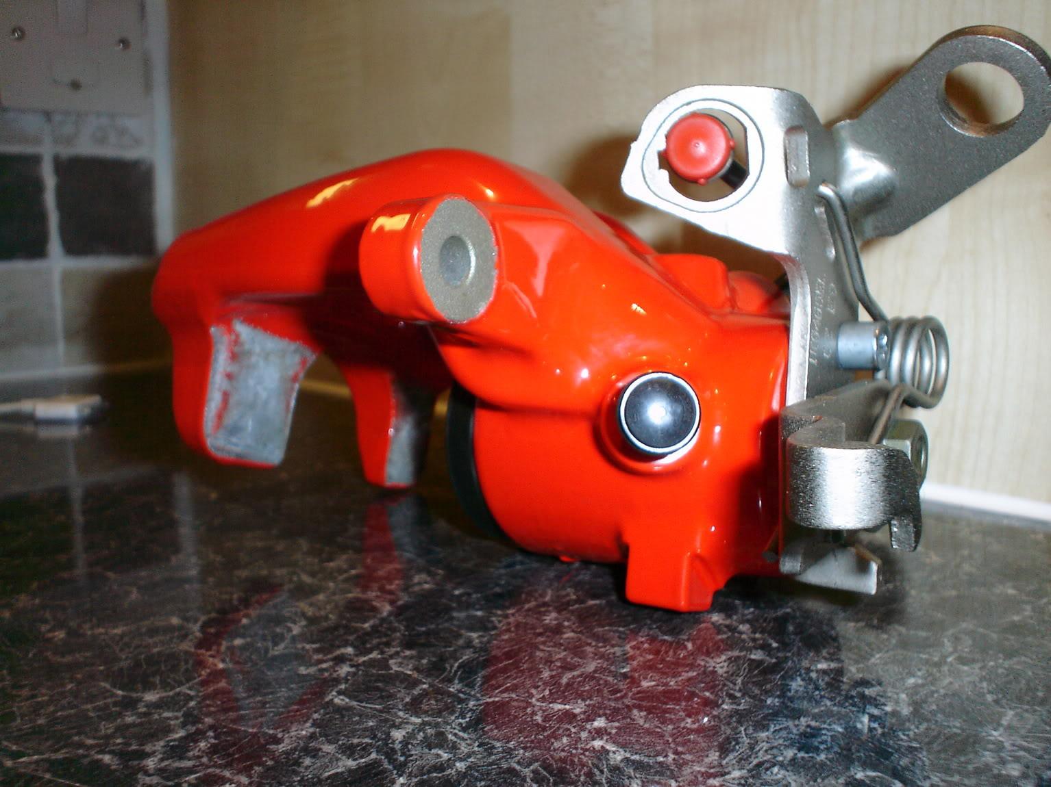

Finally lets see the pics heres mine complete with Nickel plated handbrake levers for some bling

Right, they're all painted now, and the rears are being built back up, ready for install on monday/tuesday, followed by a full valet on the car, considering the state of it!  I'll then get some pictures, so I can update my build thread properly.
