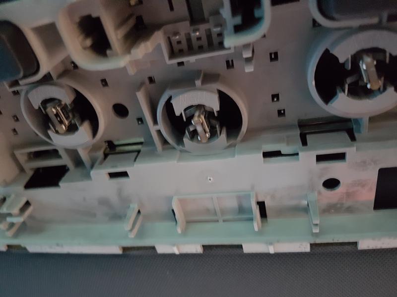

Never seen this before.
Driving to work I noticed a rattle in the car.  Sounded like a stone rattling round behind the dashboard at first.
A few roundabouts later I decided the rattle was coming from both the front AND rear.  WTF I thought.
I had washed the car the previous day so wondered if I'd dislodged something.
Anyway on the way back from work I noticed that my interior lights where not working - only the footwell and button lights were working.
Anyway I put two and two together and thought perhaps a bulb had come loose and blown the fuse.
Checked fuse - fuse OK.
Removed the rear interior light cover to discover this:
Every single one of them has either popped or snapped off.
What on earth could cause that to happen!

i've had this.  the resistor that prevents the can bus errors makes the bulb get hot and i think the bulb desolders the LED's i think next time i'll buy normal bulbs and disable the bulb tests
