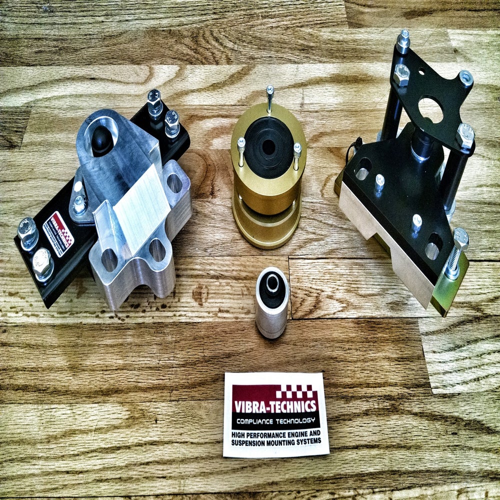

Here they are in their unfitted form, looking all purposeful and tasty.
Here is the right hand one fitted.  A bit tricky to see the juicy bits but the fact all the stock accessories bolts onto it like stock speaks volumes, compared to some other mounts which over look such obviousness.
The gearbox one fitted, in all it's billet alloy splendour, yum.
The dogbone.  I nicked RedRobin's pic as I don't have one of mine fitted, but they are gold in colour now, not alloy.

What about the small end of the dogbone?
VT have that covered too. Pic of it in the first image up top.  I have one, but haven't yet fitted it as it needs pressing in.
It certainly solves the issue of the shoddy voided bush VW put in it.
