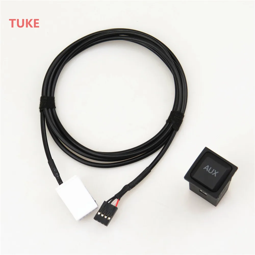

Has anyone fitted one of these jobbies to the standard stereo?
Link to it
https://m.aliexpress.com/amp/item/32827454138.html

Hi rado, it won't work if you have a rcd300, I tried it on my rcd300, it's not compatible with the generation of radio, you will need a connects2 kit for aux On a  rcd300.
