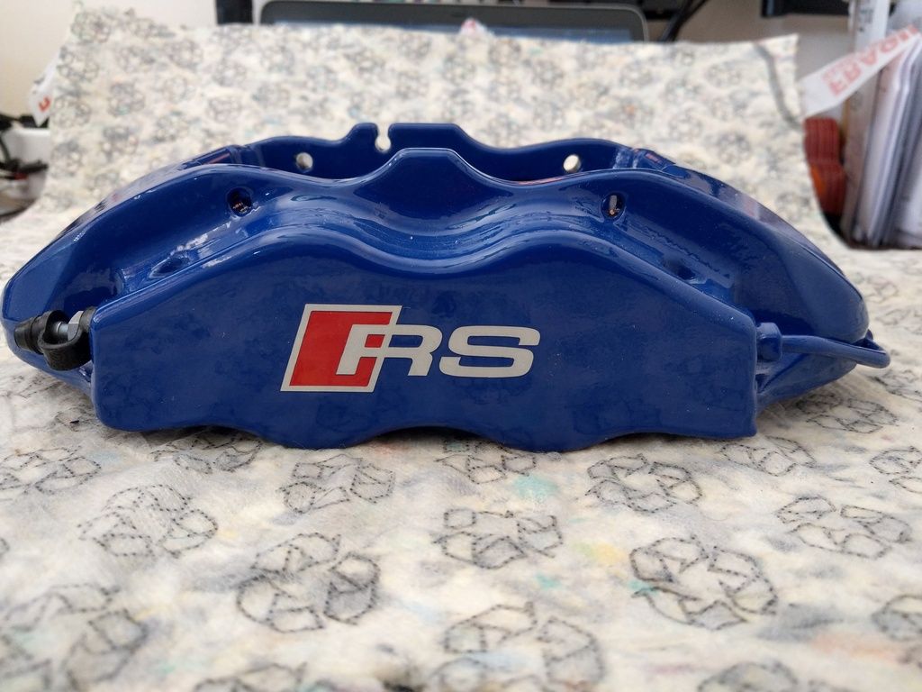

- fit ttrs front calipers, 340mm discs

Front brakes & Wheels
