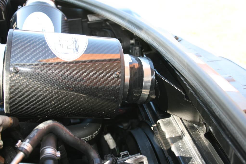

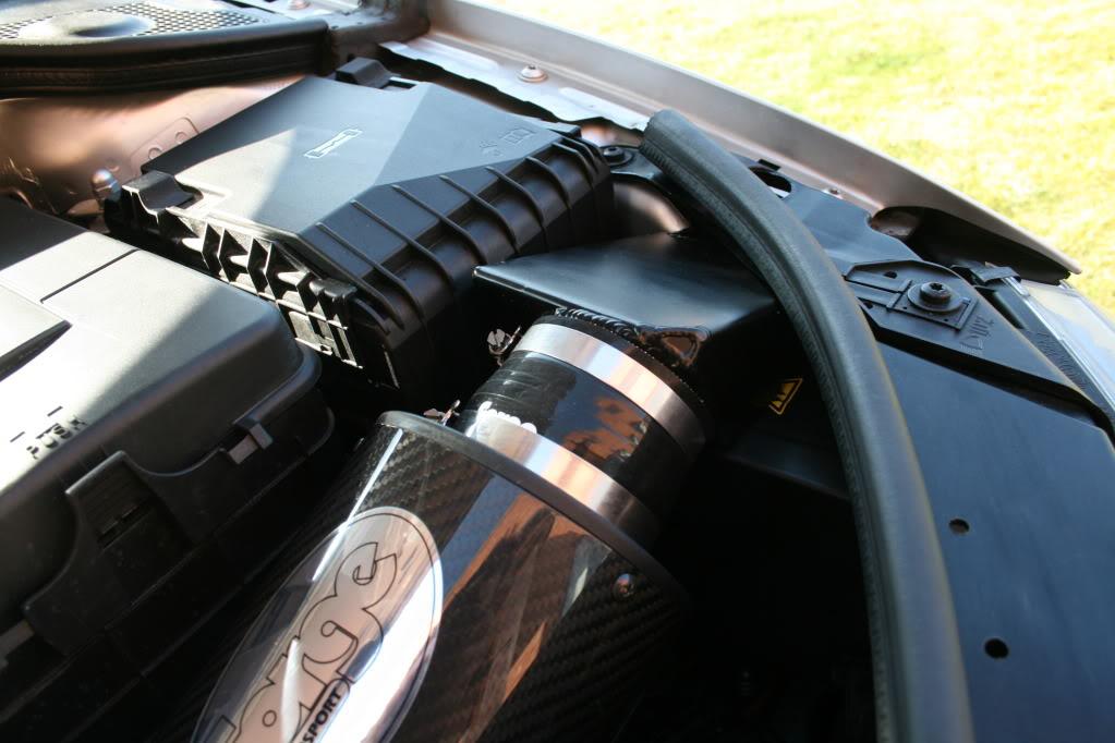

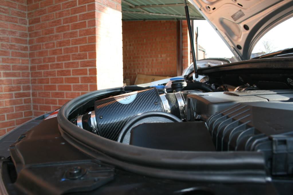

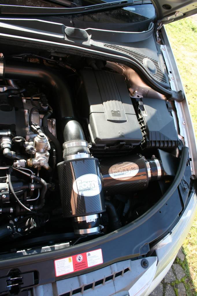

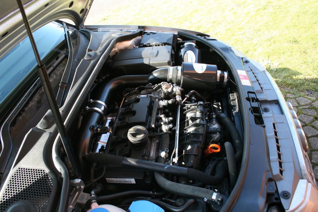

We have some better weather here today so here are some more pics:
Side View

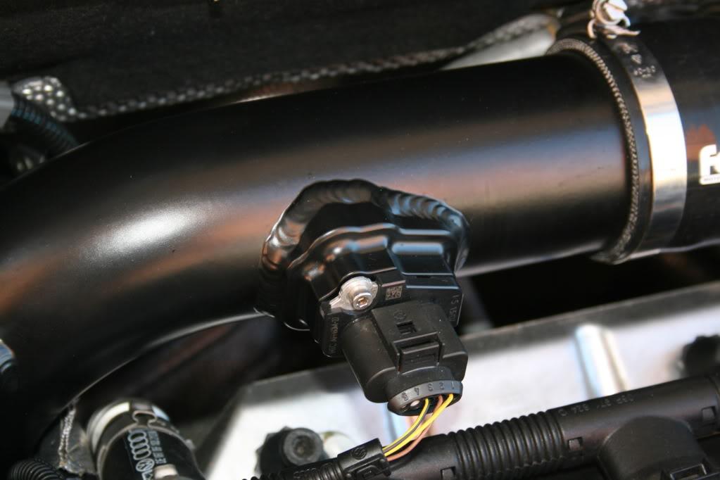

MAF - I'm very happy with the quality of the welds.
Second inlet above the passenger xenon
Factory inlet in the OEM position
Money shot
The filters
