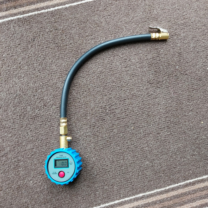

If anyone here is a bit of a fuss pot with pressure guages like me then found an ideal solution, I had a sealey digital guage which was accurate but the quick release connector was a nightmare I found, so essentially I bought another guage to swap the connector a clip on chuck one instead.
 Basically bought these two here https://www.demon-tweeks.com/uk/sealey-tyre-pressure-gauge-digital-with-swivel-head-quick-release-tst-pg98-seatst-pg98/ and  https://www.demon-tweeks.com/uk/sealey-tyre-pressure-gauge-with-clip-on-chuck-tst-pg6-seatst-pg6/ and took the secure fitting clip on chuck from the latter and with a 14mm spanner and a pair of grips and a lot of force wound it onto the digital one so it was air tight. Now I have an accurate guage with a solid connection and a bleeder valve :)
