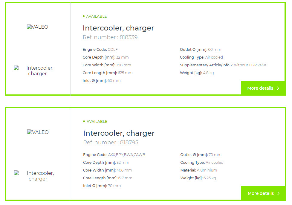

I've checked Valeo's catalogue too, same story.

That's encouraging. Think you're right about it being different internally, just found this from ECS tuning posted on golfmkv.com:
As requested - Here are is some of the information we found when researching the Golf R intercooler:
4 more bars spaced more closely together
* More equivalent frontal surface area, as well as internal cross sectional area - improved flow capacity
The plate design inside the bars are more closely packed
* Improved efficiency due to greater rate of heat transfer
Smoother flowing end tank ports
* Improved flow characteristics compared to the S3 fittings which have steps in diameter causing turbulence.
So it looks like external core volume is indeed a red herring and the newer IC makes up for it with the above. Either way it looks like I have the right part, so mystery solved  :happy2:
