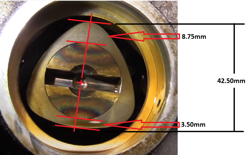

I found the pic below and cleaned up the specs to be more legible. Hoping for confirmation on the dimensions as well. I will leave it posted for future use when others are struggling to find why the rail pressure is suffering. As this may be the reason for it...given the age of our MK5 today.
This pic is supposedly of the intake cam tri-lobe; found on std-K03/BPY (and the like; AXX_BWA_etc.) of the EA113 engine. Remember, or know, what is important to produce rail pressure is the cam lift...in other words; the travel/stroke of the piston inside the HPFP.
As we know, the K04 equipped cars have intake cams with a bit more cam lift on the tri-lobe.
Also, take a look and if you can confirm the specs in the pic, just comment below please.

This all is likely only going to be helpful to those who've picked up their MK5 second, third, or fourth hand. Where the previous owner/s neglected all this, as well as informing the next owner. I've recently been helping a few with the issue. They've replaced all they could think of, only to find out the intake cam needed replacing. When they measured the tri-lobe 42.5mm, theirs was between 1.5mm to 2mm shy. There wasn't as much wear at the 3.5mm spot, so it was all worn at the peaks...thus reducing the cam lift and stroke of the HPFP's piston.
I thought if I posted this pic, perhaps some would then see it come up on one of their searches. And perhaps they would check the tri-lobe before replacing a list of fueling parts.

That is a really good idea. I think it is definitely something worth attempting, if to avoid removing the chain cover. Some calipers may make the reach while some may not, but....so long as cam lift measuring is achieved; 8.75mm - 3.50mm = 5.25mm

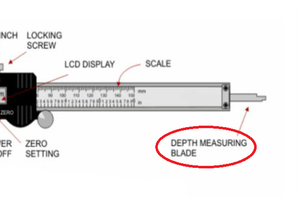

Or you could use a vernier caliper's depth measurement from the machined surface of the HPFP hole, to the peak of the cam.  We would of course need a known good measurement as a reference first.

That is another good idea for checking cam lift.
One would only need to measure depth and then rotate the engine to measure the two spots required to figure the lift...thank you.
With a sturdy bit of straight edge to span the HPFP opening, one could use the depth-end of their typical/std calipers;
Re: One reason why fuel-rail pressure may be low....
« Reply #11 on: May 04, 2022, 05:18:08 pm »
A proper depth micrometer would work better.  Good idea pudding. I would think measuring off that face would be fairly accurate.
