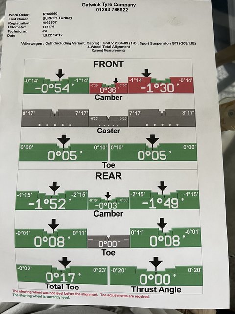

I'm currently sat at Gatwick Tyres, as been here before for alignment as they too have the Hunter Alignment kit. Car is just going on ramp now, so I'm hoping that they can sort it. I'm still concerned that the subframe doesn't appear to be lined up, as per the pics i posted, but according to my pal that fitted the 034 Deadset bolts, its fine. Steering Was spot on before i went for this kit, so something ain't right :confused:

So Jordan at Gatwick Tyres (fellow petrol head) adjusted the alignment. He did say that it looks like Kwik Fit may be using an older version of s/w on their hunter, which could account for the issues i've had. However he tweaked the settings and asked me to drive it over the weekend and see how it is. Whilst its a LOT better, the steering wheel is still slightly off centre and still pulls to the n/s, so going back tomorrow for hopefully the final check and alignment. I've added a pic of the existing set up.

That looks good. Remember the only thing that he can adjust directly at the front now the dead set is installed is toe.
Have you have a look at your tyres? Same brand and even wear particularly at the front? I’m sure you know this already but a car the left of the road will pull to the left due to the crown of the road. If you can find a clear road try driving in the middle to see if that helps.
Thanks for keeping us up to date. My car drives wonderfully straight and trying to decide whether to fit the dead set kit I have in the garage!

It confuses the crap out of me, Toe, Caster, Camber!!!! I need to have a read up on how this all equates!!!! Tyres are (Goodyear F1 Eagle SS - on recommendation of @Pudding) wearing evenly. I'm due to do an oil & filter change at 160k (do this every 5k) and will swap front/rears around to get even wear, as they'd have covered just over 5k. I have a road near me thats long and straight, and actually did the test you mention yesterday. It's a tad better, but still pulls to the left. When driving normally (in the road) If i let go of the steering wheel, its pulling quite significantly to the n/s (on a scale of 10 for aggressiveness i'd sat 6.5) I spoke to Jordan at Gatwick Tyres, and he said we can go out together in the car to test before and after he's re adjusted the alignment. I'll keep you all posted on this and really appreciate your help with this chaps!

So your car should pull slightly to the left. Online people say half a degree (what you have) is the point that it starts to show.

It was fine before the dead set bolts went in. Had new discs and pads fitted around 3k miles ago too.
