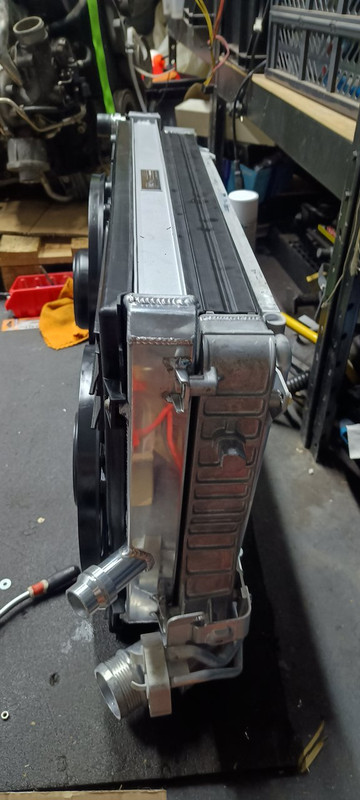

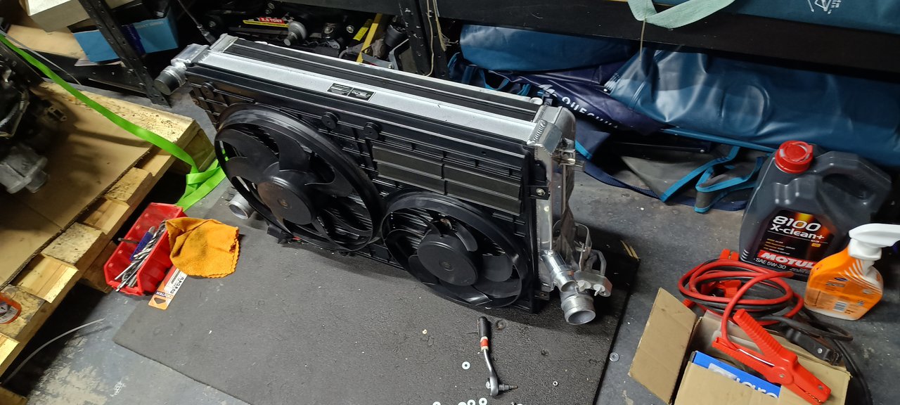

Started playing with the new cooling stack today:
All looks compatible, but the old screws that are looking self tapping screws going into the plastic end tanks, are not going to work with the alloy S3 intercooler and radiator.
So now I'm off to ETKA to try and find the correct bolts..

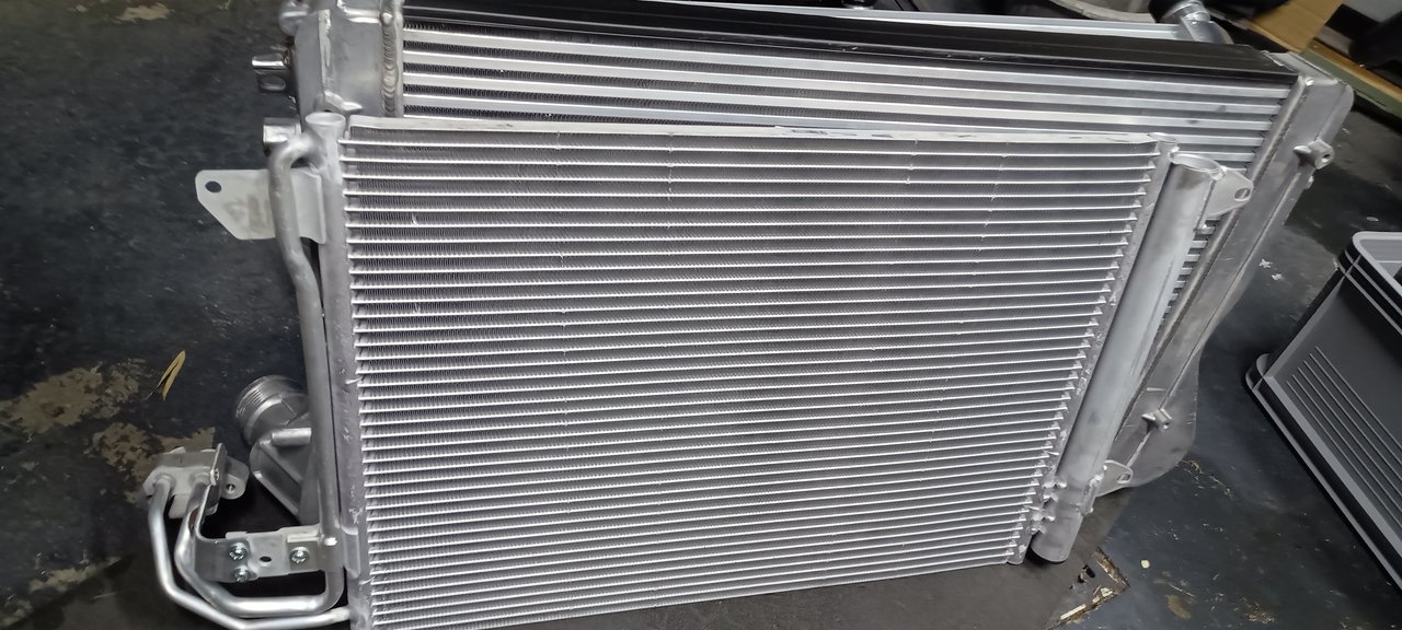

Ok, another small update, but progress is still progress.
After a quick check with some calipers and a trip to the hardware store I came home with some m6x20 bolts and washers.
It turns out that the intercooler is threaded for these but the radiator will take the old self tapping screws.
The only real issue was getting the new AC condenser to fit to the intercooler as it didn't want to line up. But after extending one of the holes in the brackets I made it work.
So after all that the new cooling stack is together:
