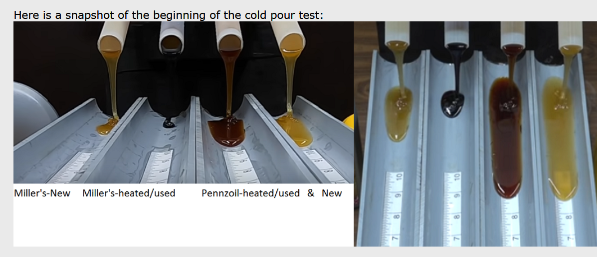

The clackity sound at startup may be due to the gooeyness of Millers...stay tuned. I would stay away from using Millers for the duration of an interval used on a daily. You might consider Millers for a trip to the track and then drain it for your normal VW 502.00 approved oil. I use Liquimoly Molygen 5w40, although Mobil 1 is slightly better against friction in a test. Millers responded to someone and said "there's is more of a race oil and should not be used in a daily...it is not VW 502.00 approved. Millers does provide good protection against friction, but it isn't meant for longer intervals or even for 5k mile intervals." Also...Millers, in a test where Millers and Pennzoil were heated and then cooled, can get a bit gooey. This is a pic of a cold pour test performed with both oils new poured beside themselves after heating and poured when chilled;

I like that boil and cold test that you posted @ROH ECHT , it gives quite an interesting insight. Pouring out the Miller's with 3k miles on it, seems as viscous as any other used oil that's come out of there, bar the 5W30 that was originally in the car when I got it. Thankfully Ireland rarely goes below freezing temperatures so the cold use of it isn't something I'm worried about, especially considering this is pretty much gonna be my oil for the whole summer.
But the common consensus is that I should dump the €91 Miller's as soon as the track day is over, right?

Right....race oil is not meant for running normal to long intervals. Any "Race" oil you use is probably not going to be factory approved...but will likely protect better under track conditions and use.
