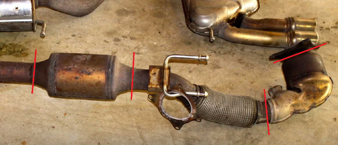

For those suggesting the magnaflow 59959 (@Pudding and @ROH ECHT  :happy2:), how is that welded in, just replacing the standard cat on the OEM downpipe? And the pre-cat is left in, so I assume that's something I have to ask the welder to delete as well?
It seems like less hassle getting a whole generic sports cat down pipe off eBay, but if the Magnaflow is really such good value for money I'd like to find out how it's supposed to be installed and also how people deal with the pre-cat too.

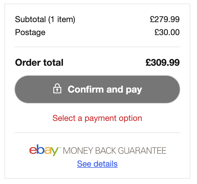

If I could get that downpipe @FatWelshBoy for the listed price I would jump on it. But that price is before import tax, unfortunately putting out of my budget.
I live in the Republic of Ireland, where we have to pay crazy fees whenever importing something. Look at this for example, £233 base price, £32 shipping and then a whopping £92 import fees. That puts the total at £343 (almost €400 for me) for a generic sports cat down pipe.
Whereas if I lived where you guys lived, it would be £279.99. £63 less.
So please please please, if you have a link to where I can get it in the EU then send it. Or if you know a really cheap one in the UK (like the Magnaflow 59959) then send that on too, as then the import fees substantially less.
Sorry about the price rant. Appreciate your help lads  :happy2:

If replacing the OE with a Magnaflow 200 cell, 59959 is a 200 cell for a 3 inch pipe, and you would want the Magnaflow 59956; it is 200 cell for a 2.5 inch pipe.
Install requires cutting the original and welding in the new.
As far as doing a pre-cat delete...that would require a skilled tube former and welder to make a replacement section once the pre-cat is cut away. It must have a transition from the turbo outlet plate, then add a bend, and a reduction to match the pipe prior to the flex section. The secondary cat is straight forward...cut and weld.
