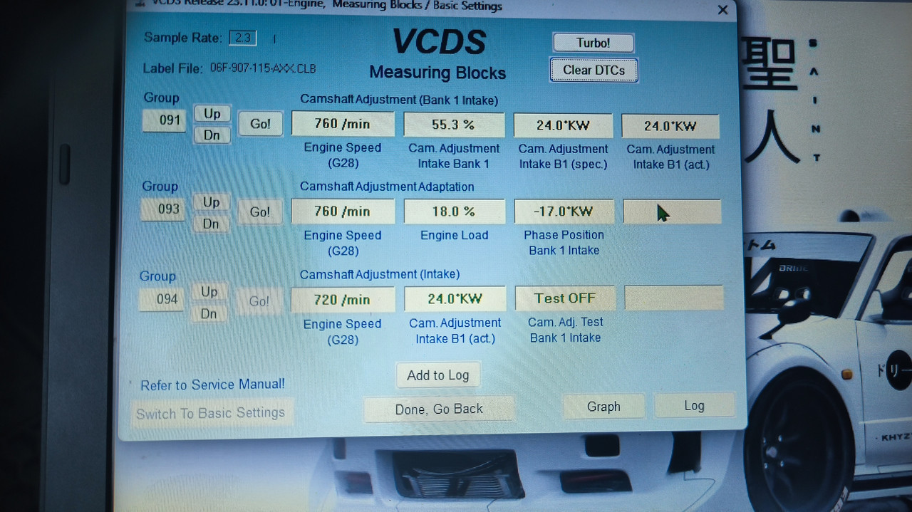

« Reply #92 on: November 12, 2023, 09:26:11 pm »
Good news and bad news.
It runs    :jumpmove:  :pomppomp: :star:
Bad news
Coolant leak from the elbow that connects to the block.
In vcds block 93 phase position is -18

« Reply #93 on: November 13, 2023, 03:59:04 pm »

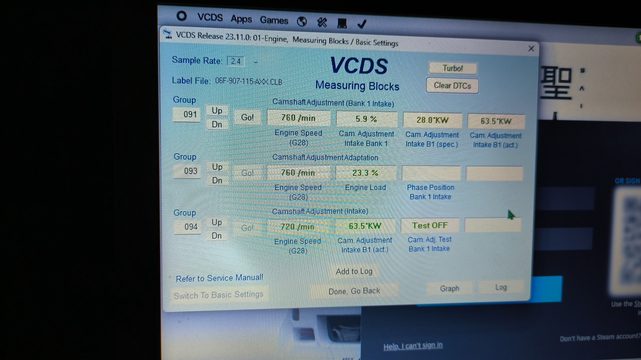

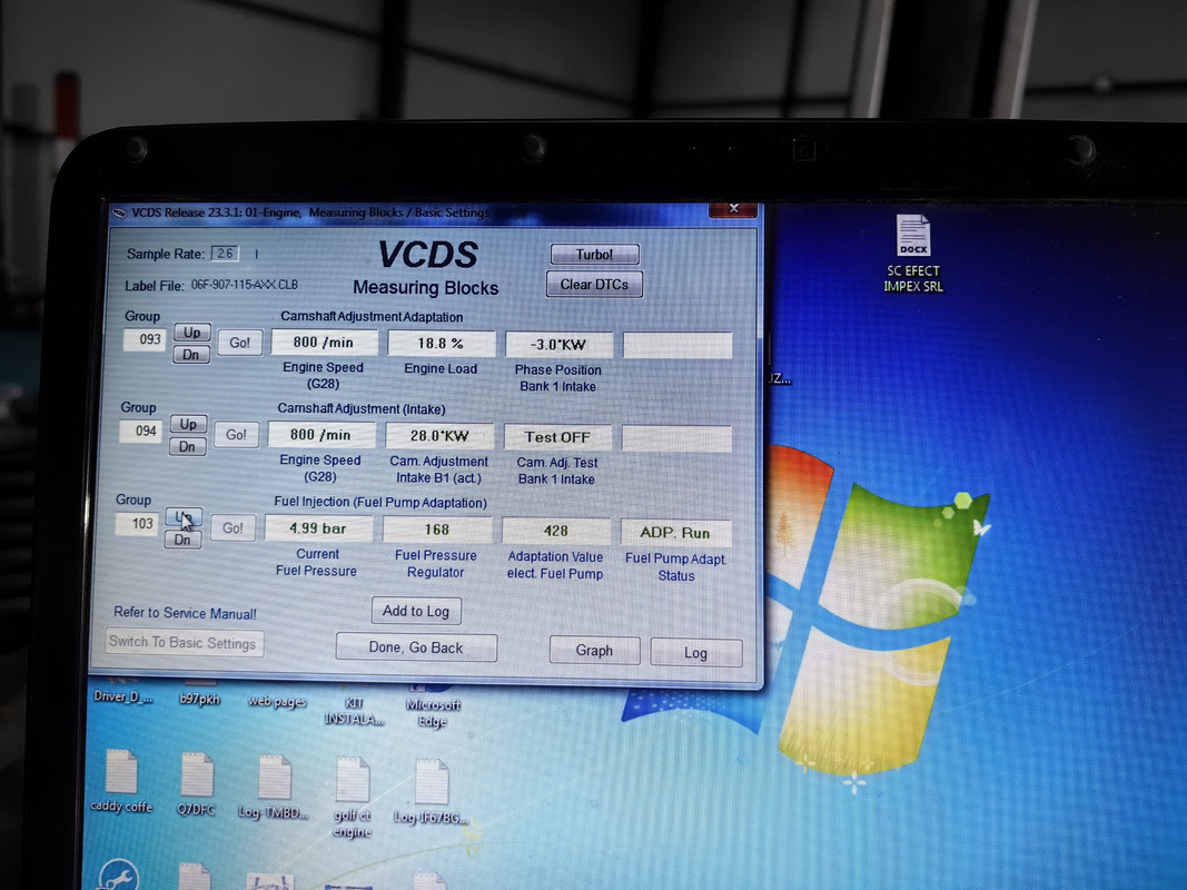

Timing seems off. Are you getting ~28kw actual in group 94? Here's how mine look.
2007 ED30

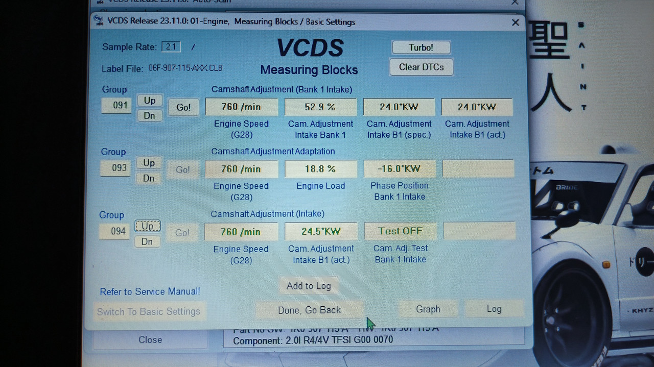

Re: Some Help Broke Down :(

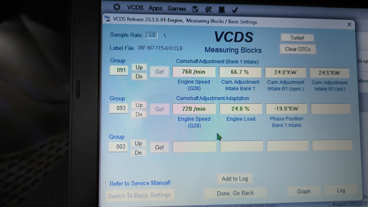

« Reply #96 on: November 16, 2023, 09:13:48 pm »
 :sick: :sick: :sick: :sick:
With 18/19 link method it's worse
When I did 19/20 links
Why is the 18/19 link method not working?
05 | Tornado Red | DSG

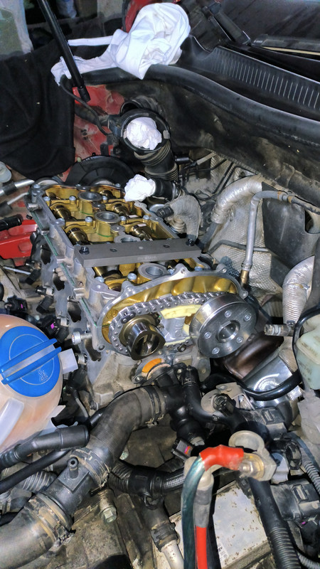

  • Posts: 115
« Reply #97 on: November 17, 2023, 09:40:37 am »

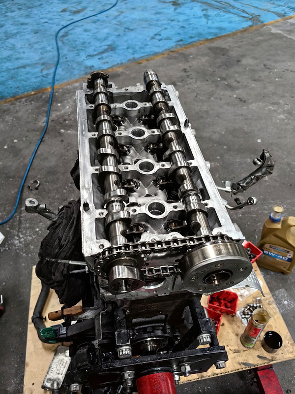

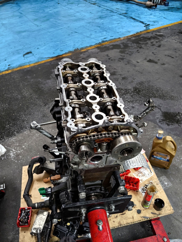

Damn, that looks way worse. Only things I can think about are the actual camshaft install into the head, the locking tool should slide in there without any force or wiggling if all is set properly. Either that or the timing belt side, are you certain that it's on spot? Here's two photos of how my cam positions looked with the current timing I have.
2007 ED30

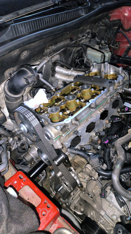

« Reply #98 on: November 17, 2023, 10:44:16 am »
Thanks for the pics
The belt side looks good.
Even when the head was off i could only get the locking tool in at 18/19 links with a lot of wiggling.
I suppose i will set back to 19/20

« Reply #100 on: November 18, 2023, 08:38:06 pm »
Checked my bottom timing mark.
After a spin to the shops phase position bank 1 is now -16
No other errors

Mine used to be -9kw on group93 with the old engine. I'd run it but fk do I know :stupid:. Group 91 looks good with actual meeting requested. A bit baffling though as mine and all the others i've seen request 28kw at idle vs your 24kw, was that with the engine up to temp?  Maybe someone with more experience can chime in.

« Reply #102 on: November 20, 2023, 01:10:46 pm »
Yes it was up to temp. The motor is an axx maybe this is why some readings are different.
Going to drive it for a few days to see if it improves.
