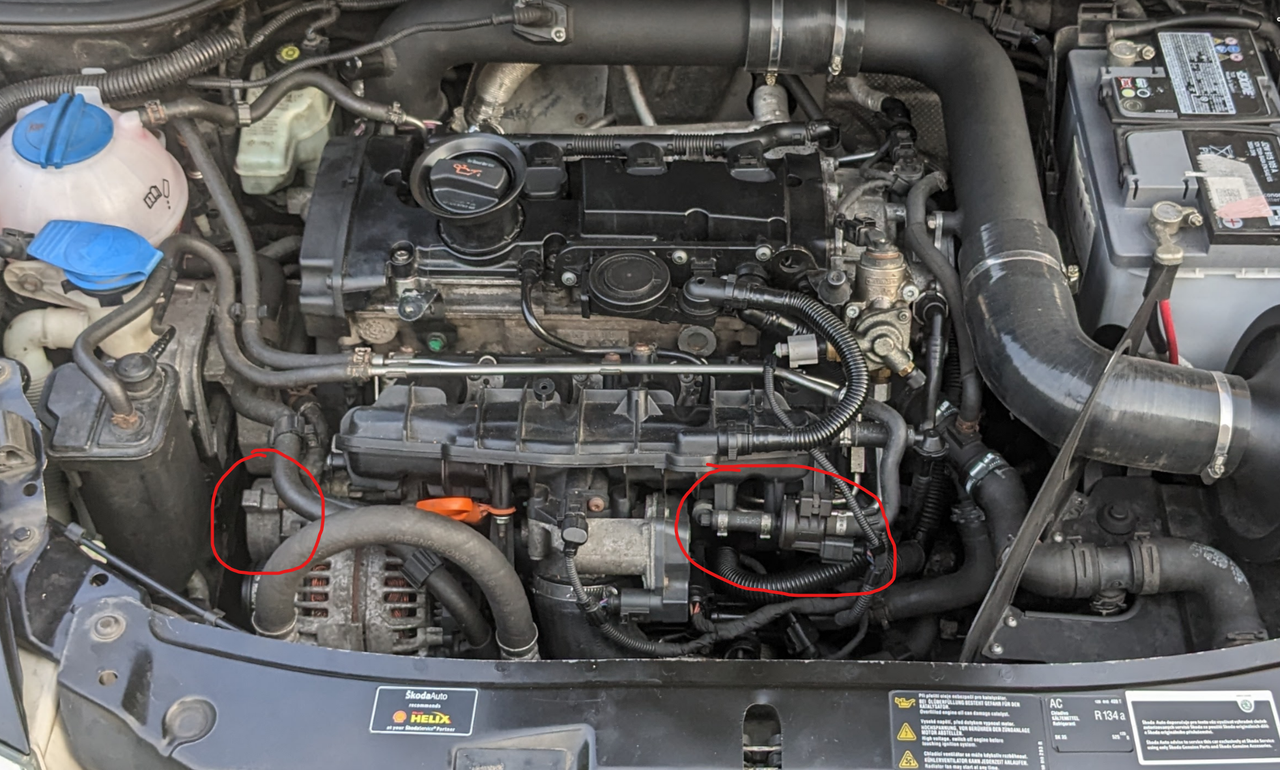

There's two places to check before determining it could be the timing chain: Left circle is the tensioner for the auxiliary belt, right circle is the Evap Purge Valve (N80). Both can make a metallic noise. Put your ear to both and see if either is the source of the noise.

Thanks for the response, I did end up doing the chain and tensioner along with the adjuster and it's now a lot quieter and the sound has gone.
However, I did hear a lot of ticking from the purge valve, so I put back my old one and that's also a lot quieter
Reason I changed the purge valve initially was because of the P0441 code but that was due to needing a new charcoal cannister
