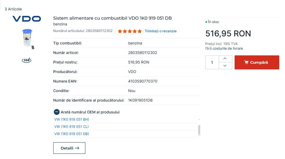

I also cant find a VDO pump anywhere but I can get Pierburg or Bosch units. Any clue if these would be ok or does it have to be OEM?
Also do update on how it cold starts next time, since I'm having some issues and the pump is the next thing on my list.
Edit: Found this one on Autodoc. I've heard mixed reviews about Autodoc. Some say it's aight, other say they are knockoff parts. Price is 110 euros.
« Last Edit: November 16, 2024, 05:05:07 pm by ZoliWorks »

Well anyway, I'm in luck. 1K0919051DB comes back as a valid part number for VDO 2803580112302 which is in stock at a friend's parts dealer for 125 euros. Now hopefully this VDO unit is a new-ish one and not leftover stuff from the early 2006 stockpiles lol
