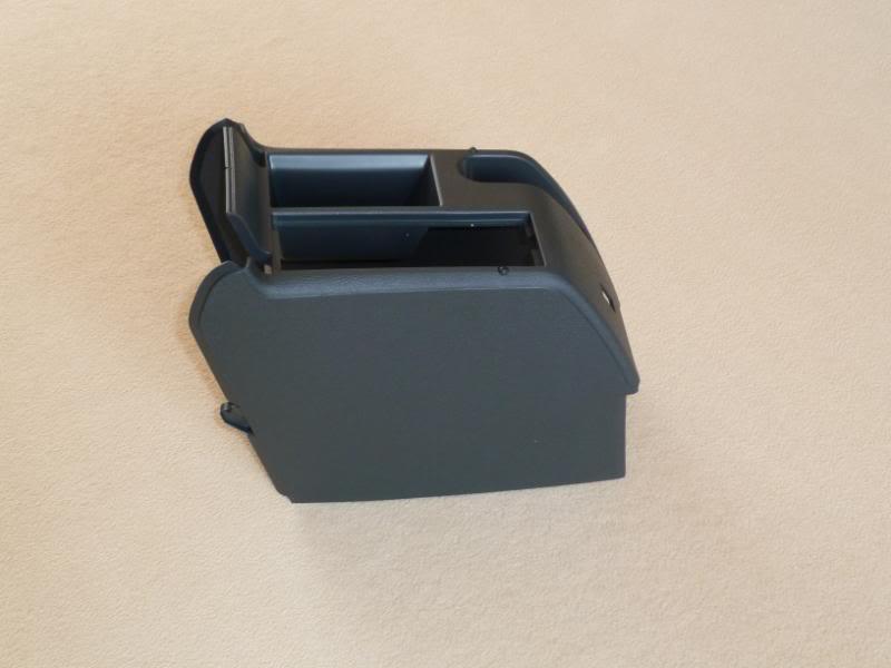

Arm Rest, this is the one for cars equiped with the Aux connection/MP3.

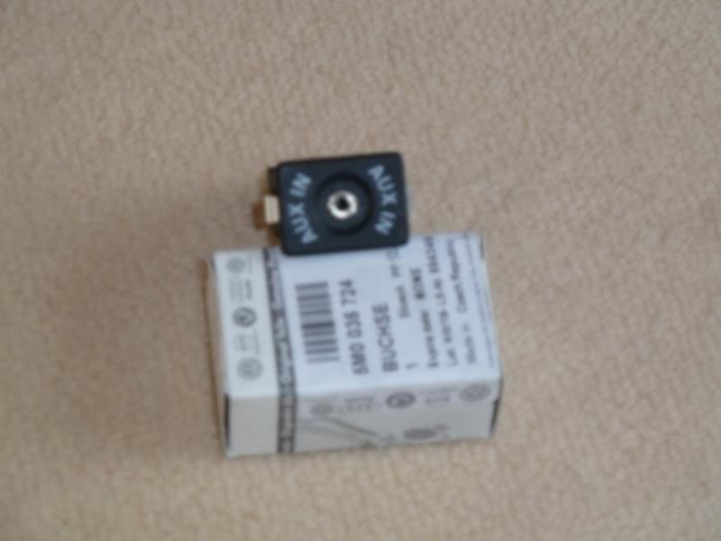

Aux connector

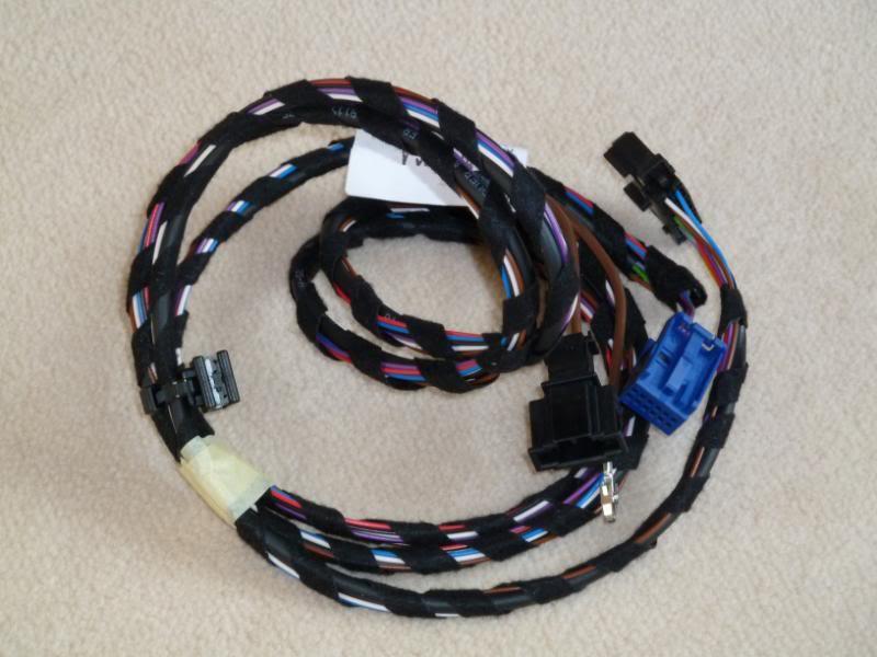

Wiring set RNS510 to CD Changer

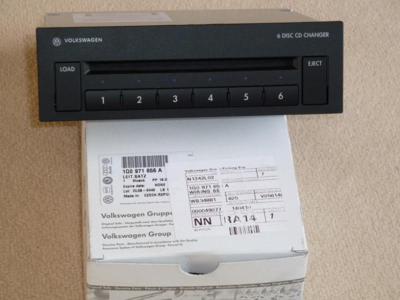

6 CD Changer

A5M0 035 724  056265/Socket  (Aux Connector for the outside of the arm rest).  Â£6.90
A1K0 863 323 Q7 1N 056265/Console  (With hole for Aux Connector) £24.18
A321 857 233 01 Glove Box (you won't need this part if you already have the CD changer) £9.08
A1Q0 971 656 A Wiring Set (RNS510 to CD changer)  Â£43.70  (cheaper on Ebay I'm told, but this one is Genuine VW)

A1K0 057 110 A indincdhanger  (6 disc CD changer)  Â£370.21  ouch....mine cost a lot less than that... :happy2:

What is required to add the Aux-In port? I have the CD changer cable - presumably some additional wiring is required?
I have the hole in the front of my arm rest, rather than stick the blanking panel in I may as well add the Aux-In facility, but other than the 3.5mm Aux-In socket shown above, what else do I need?
I take it that the Aux-In and the CD changer are able to work together given that you can only get the CD changer version of the arm rest with the Aux-In cut out in the front (as far as I know anyway)?

VW must do a cable for the CD Changer and the Aux socket, the ones I bought to do the job are the wrong ones as they will only connect the CD Changer up and not the AUX as well. At present I don't the correct part number.
So Mr Forum (SteveP) took my cables (looms), CD changer and the MDI kit and has made a loom to connect them all, which after todays fitment I'm pleased to say they all work.

What does the connector look like on the back of the Aux socket
Is the CD changer connector fully populated at the changer end, if so then the aux signals will be present in the arm rest

What does the connector look like on the back of the Aux socket  can take a pic tomorrow and post this up

I have new arm rest section (with the Aux cut-out), the CD changer only cable (no spur to also connect the Aux-In) and the new section of A/C ducting. It would appear I have to live with the Aux cut-out as the option of the CD changer armrest without the hole is no longer available. For 35p I can buy a blanking panel for the hole - job done. But I'm not a fan of blanking panels as it looks like something is missing. So, I figure I may as well fit the Aux-In socket but I'm not sure what I need other than the socket to get it working?
For what you say above Moschops, there is a different CD changer cable that also has the connection for the Aux-In socket? What does your setup look like? I appreciate Mr. P made it for you, but I'm guessing the cable that runs from the back of the head unit to the arm-rest splits - with the main connector going to the CD changer and a spur going to the Aux-In?
cameluk - In answer to your question, the multiplug at the changer end of the cable has two vacant pins...
It looks at though if I want to add the Aux-In, I need to buy a different CD changer cable  :sad1:

Animal, it would be very easy to make a separate cable to connect the aux in socket, it's only three pins  :happy2:
Let me know if your interested and I can either help make it with some proper shielded cable or send you the part numbers for the required repair wires and connector housing  :smiley:
