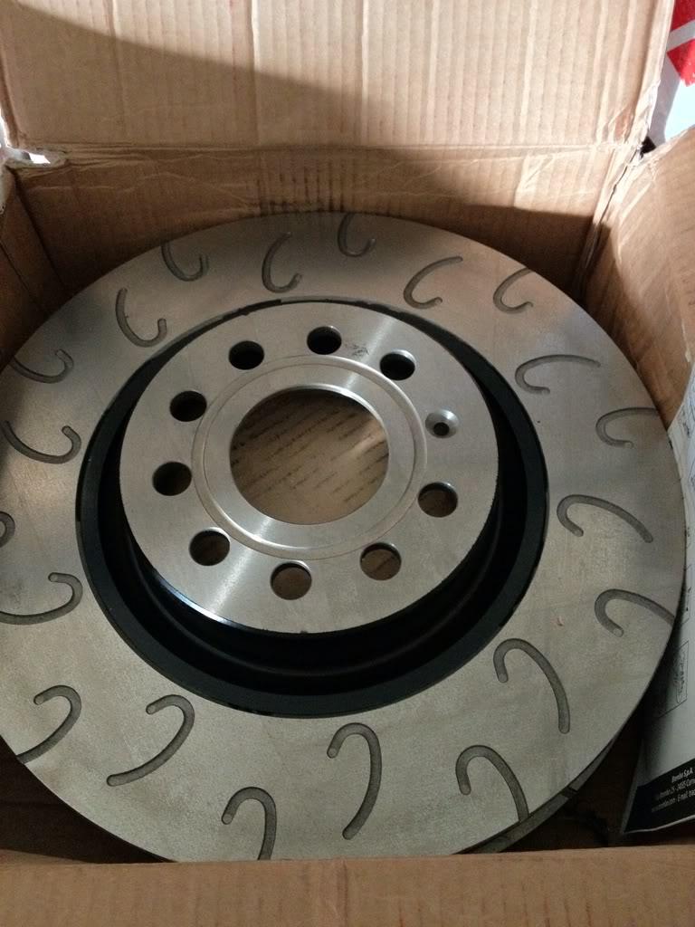

just took delivery of my machined drilled discs from DaveB for my NQS. words cannot describe the awesome. i cannot WAIT to get them fitted  :party:
just as an example of the attention to detail:
the discs are drilled in a design that's symmetrical on both sides of the car! i'd never thought to ask him of this but secretly deep down it would have bothered me if they weren't but this man has clearly thought of everything!
DaveB i salute you  :happy2:

Received my J hooked 312s today too.
Fitting tomo with pagid blues  :party:
