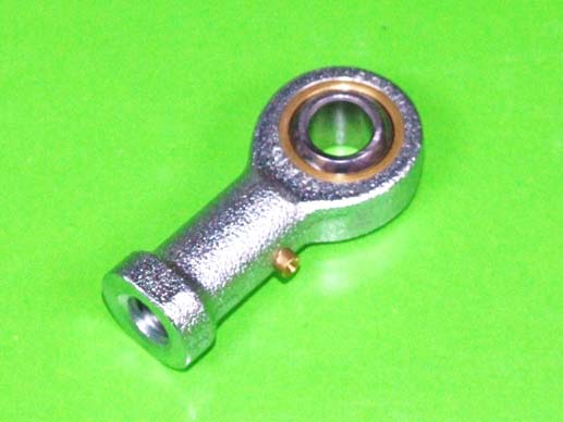

Problem is rose joints don't suit the UK climate, but there's no doubting it's ace.

« Reply #8 on: May 07, 2010, 09:07:50 pm »
rose joints??
i thought rose jointing is when you weld stuff together
Offline tony_danza
  • -Receive: 112
  • Posts: 3013
Re: Whiteline Bump Steer Kit?
« Reply #9 on: May 07, 2010, 09:15:10 pm »
Nope. Uber control, compared to ball joints but eat themselves when combined with road crap and salt.
Sideways yo!
Offline Janner_Sy
  • -Receive: 113
  • Posts: 5392
« Reply #10 on: May 07, 2010, 09:20:25 pm »
You have any pictures of what one looks like as i can't picture what a rose joint would look like.
I've heard the term rose jointed suspension  before just not seen them.
Offline tony_danza
  • -Receive: 112
  • Posts: 3013
« Reply #11 on: May 07, 2010, 09:23:12 pm »
With a lockpin. No movement, no protection to the elements.... but epic win.
Sideways yo!
Offline Janner_Sy
  • -Receive: 113
  • Posts: 5392
« Reply #12 on: May 07, 2010, 10:30:01 pm »
now i can see what you mean, have seen this sort of thing before, just never realised that they were rose joints.
the normal track rod ends run the ball joint so would have a lot more play in it that.  Do you anticipate quite a bit of improvement?  and how wearable do you reckon this whiteline kit would be,
Maybe this is why it is taking so long to get released, as there are wear and tear issues???
The Ohlins steering damper on my CBR is rose jointed - and hasn't deteriorated.  Maybe when they are hidden under arches, and peeps get lazy . . . .

It wouldn't be so bad if there wasn't so much salt and crap on our roads over winter. Grotty location on the car that most people won't be bothered getting at to keep clean.
But yes, tighten things up a real treat.
I wonder if you could devise something to seal them, like some kind of boot?
