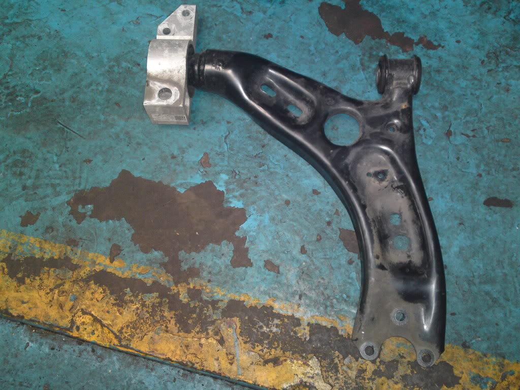

I eventually had to give in and refit the standarrd arms, it solved the problem, I have noticed subsequently that the wishbone is different on a 09 Roc, mine the 59 plate has a steel standard arm whereas the 09 plate has cast arms??

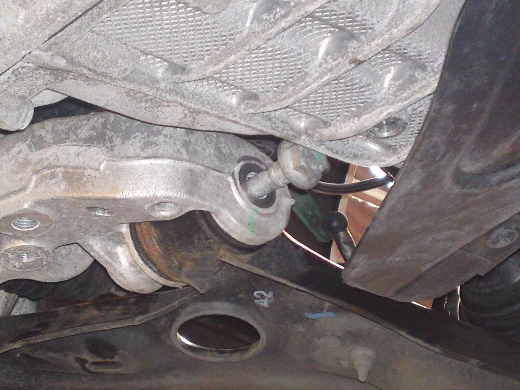

Also, when I fitted the TT arms with the WALK kit on it was a nightmare to locate the fixings, Once I refitted the original arms along with original rear wishbone mount it went on an absolute doddle.

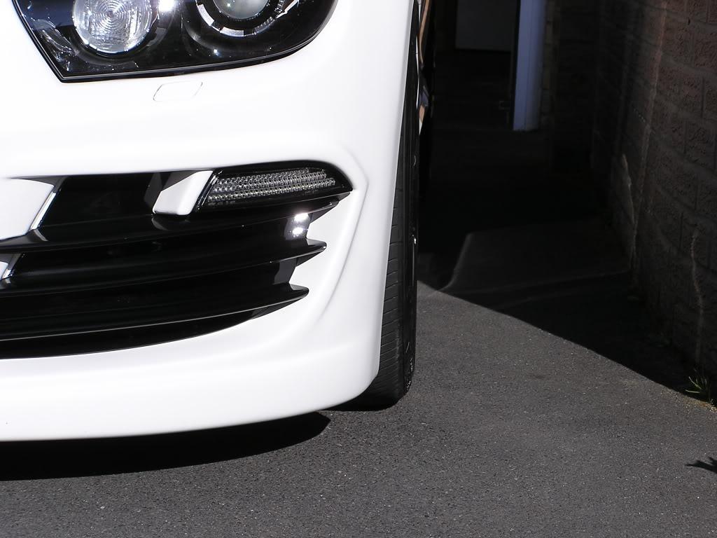

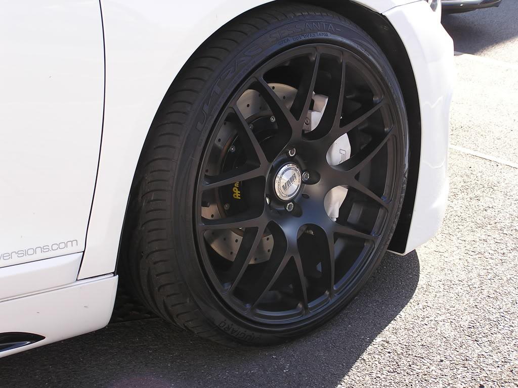

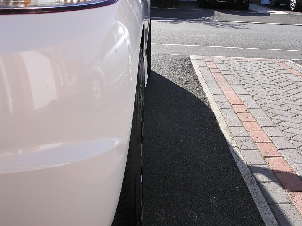

Heres just a few more pics with it all fitted to show that it does actually fit all bolted up but for some reason just throws the alignment right out? How much adjustment do you have in your track rod ends in degrees? Does anyone know if this could be the solution just totally redo to alignment.

Hi, just another thought, could this be due to the fact that the track has been widened obviously and therefore this would push the alignment out  cos of this? And if so would it push it out quite a bit if so?

Red it will affect the alignment on yours aswell pal as it widens the track on both the golf and the rocco. I have fitted them now last night and had the tracking done. All i can say is WOW! Before i changed them when exiting a corner etc as you know you get a lot of wheelspin as for fitting the WALK kit and TT arms and ball joints and adjusting the camber i can barely tell as its very difficult to lose grip! I am so glad i invested in this and kept teling myself it will work! I cant beleive how much a few degrees camber can actually help matters.
