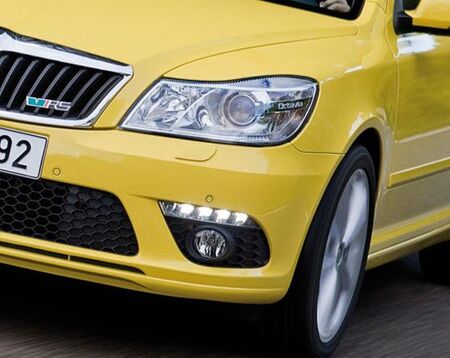

This illustration clearly shows a 4-bulb LED DRL unit in the usual foglight position like mine. There's folks on Briskoda (I'm not registered there) wanting to retro fit these DRL's.

Yep there are as ive given people the part no in the past :laugh:
They are £65ish quid each iirc
You can get the same thing for an Octavia Scout and I'm pretty sure it would fit the Octavia vRS as it "looks" to be an identical housing (the scout one not the Fabia).

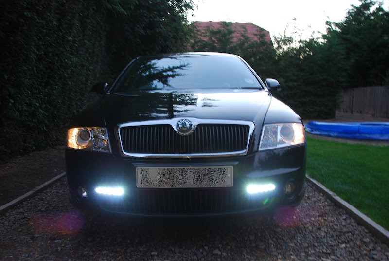

You can get ones like I have installed though for £35 from here
Click Moi
This is what they look like fitted & working (ignore the holes they were from a previous test)

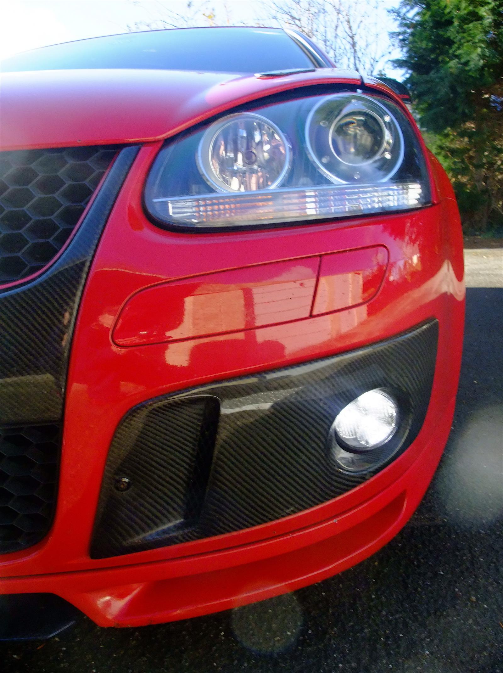

Carl would I be right in saying the ones you have don't dim when the headlights come on?? Iv been toying with the idea of these in my GT fog grilles. How do you think they would fit?

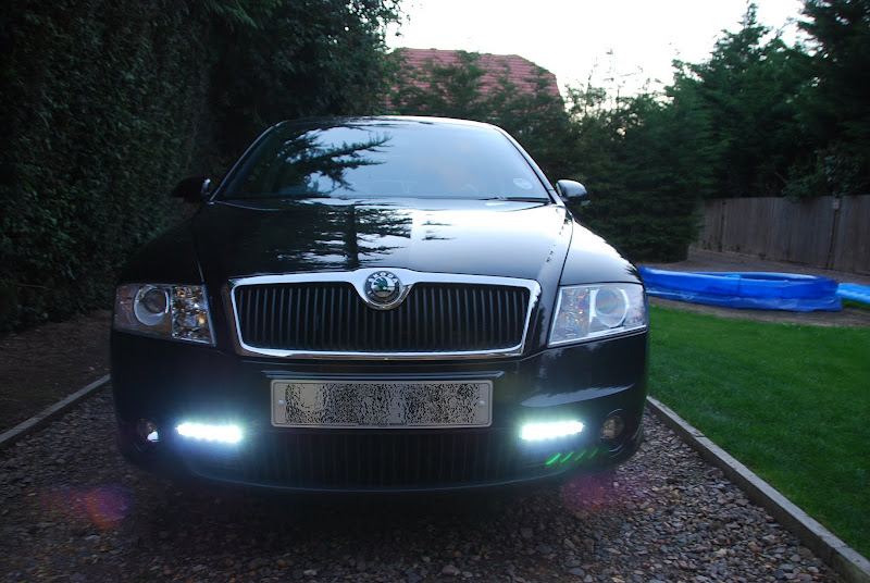

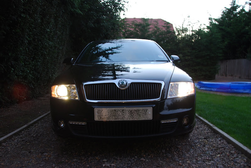

You get supplied 3 wires. Red, Black & Yellow. The Yellow wire determines wether they dim or not.
This is what Dave did to achieve it.
Quick update - the advice I gave regarding connecting the yellow DRL wire to the yellow/black on the car was based on the car with ignition on / engine off.
I fitted the DRLs today and wired them as mentioned previously and noticed that having the engine running gave a slightly different result.  The next six pics are:
1. Ignition on / engine off / no lights
2. Ignition on / engine off / side lights
3. Ignition on / engine off / main lights
4. Engine on / no lights
5. Engine on / side lights
6. Engine on / main lights
Spot the difference between 3 and 6....with the engine running, when switching on the main beam, the DRL goes dim instead of going completely off.  Not sure if I prefer this or not.  I may get the multimeter out and test things again but with the engine running this time  :ashamed: However, I'd be interested to hear opinions - DRLs dimmed with main beam or off???
