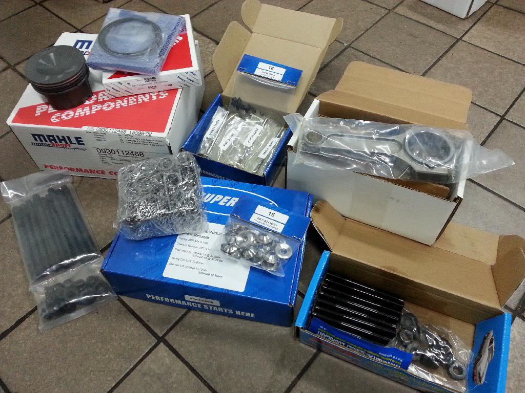

Few bits have turned up today.  Just waiting for the inlet valves to be made.
How come your changing pistons Alex.
Want to build the best possible. These pistons are stronger than the cdl pistons, and 83mm so the engine gets a slight bore from 82.5mm.

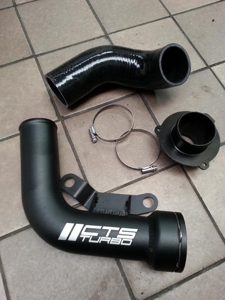

I had ordered one of the CTS discharge pipes before I decided to go all out.  Fitted it anyway to see what difference it makes.   Well it does feel like a slight improvement to spool and it revs past 7k smoother too.  So for the money it's worth it.
Did an oil and filter change and now running millers cfs 10w50 nt. Oil temps are actually around the same when driving hard, but have dropped a little when cruising.  More testing needed.
