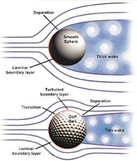

Does anyone know if the 'golf ball' pattern actually makes a difference?
The dimples do make an improvement aerodynamically, primarily by inducing a lowering of the drag coefficient by improving the Reynold's number:
As a note, maybe 10-15% of an "eco" car's efficiency gains are from improved aerodynamics on the underside.
Remember though that increases in aerodynamic downforce also result in increases in drag, making the vehicle less efficient and and reducing vmax.
I saw a few years ago on one of the American forums someone had fitted an undertray and a crude diffuser which he said improved high-speed stability; something which is entirely plausible, but which lacked any form of quantiative testing.
Undertrays designed to reduce drag will not, in my opinion, improve high-speed stability.

Re: improved aerodynamics with OEM parts
« Reply #29 on: January 14, 2011, 09:57:55 pm »
Thanks for the pic.  :happy2:
Yes, but we talk about reducing our Golfs' lift. There's no chance for real downforce.  :wink:
These undertray parts reduce turbulences and these tubulences cause both - drag and lift.
A smoother undertray helps getting a laminar air stream. The smoother, the faster the air
will pass the car's underbottom. The faster the air, the less drag and lift.
Just advantages, no problems. Just my 2 cents.  :happy2:
