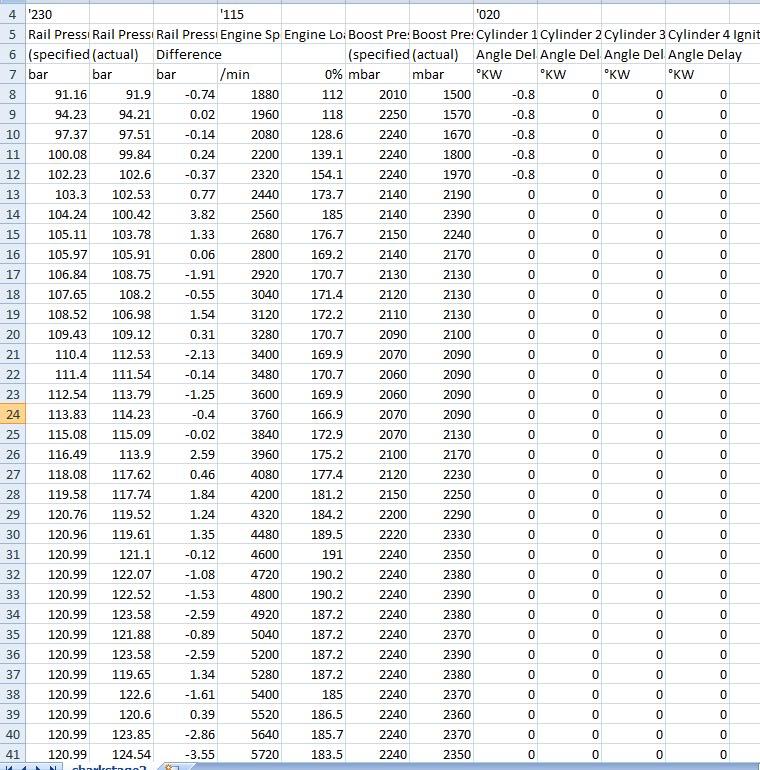

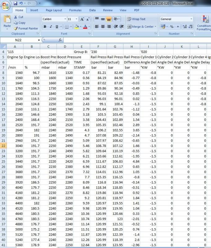

Hello folks, I just moved from a pdt stage 2 to shark performance stage 3. It is better than the stage 2 map, but not up there with the Revo.
I did some data loggng, and the timing pull is better than the other maps that I had at this level, but the rail pressure is lower, and the requested boost is only the same level of bluefin, but less than Revo. I know that shark prefer to do safer maps, and I asked them the reason for the lower fuel pressure, and was told that it makes no diference. I also put their stage 1 map on to try, and must admit its a nice map, if anyone is thinking about getting a remap!
What is peoples views on the logs?
Thanks in advance for any info :happy2:

Would have liked to see AFR too.
Looks ok but I would have prefered more boost low down as thats when you use it for every day driving. Practically no timing pull which is good and fuel pressure stays close to requested.

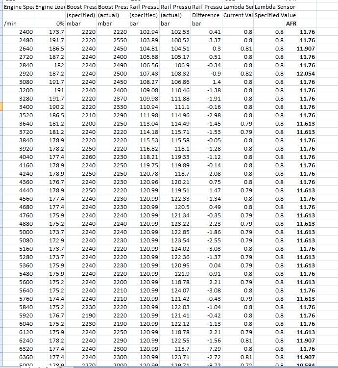

This was an alledged tweaked map I got this morning. looks the same, but I loggged the AFR with this one

Like you say everyone's different but the previous map was tame low down. The new one looks a lot better IMO with just a tad of timing pull but not bad at all, Maybe a little lean at low rpm but not bad  :happy2:

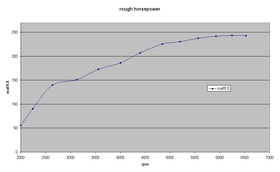

HeavyD have you logged your MAF?
If you log your MAF and then graph it in Excel charts.  You need to Divide the MAF figures by 0.8 with the results in a separate column.  use the X-Y scatter graph, put the RPM on the X axis, and the MAF/0.8  on the Y axis. this should be a rough guide of the output.
I did this with the shark stage 1 and it was pretty accurate when compared to the rolling road,
