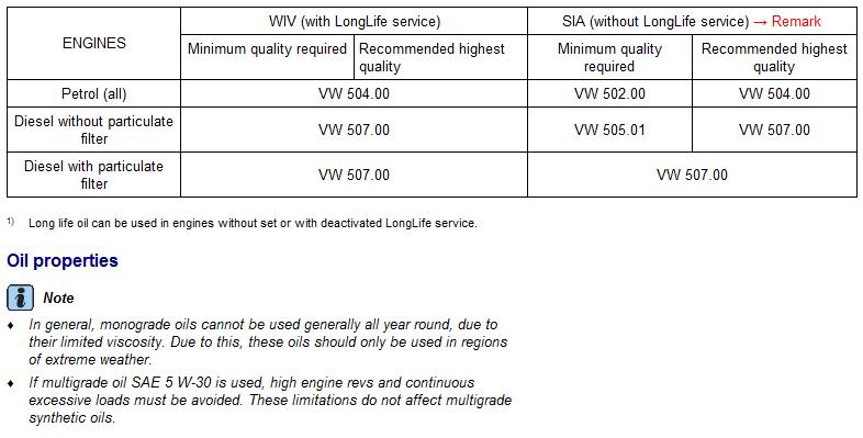

Here's the oil specification sheet......its a recommendation for the oil but not a neccessity, as long as it meets the minimum standard.
And I've checked the toothed belt guide and yes, its still 120k miles or 4 years. Whichever comes first.

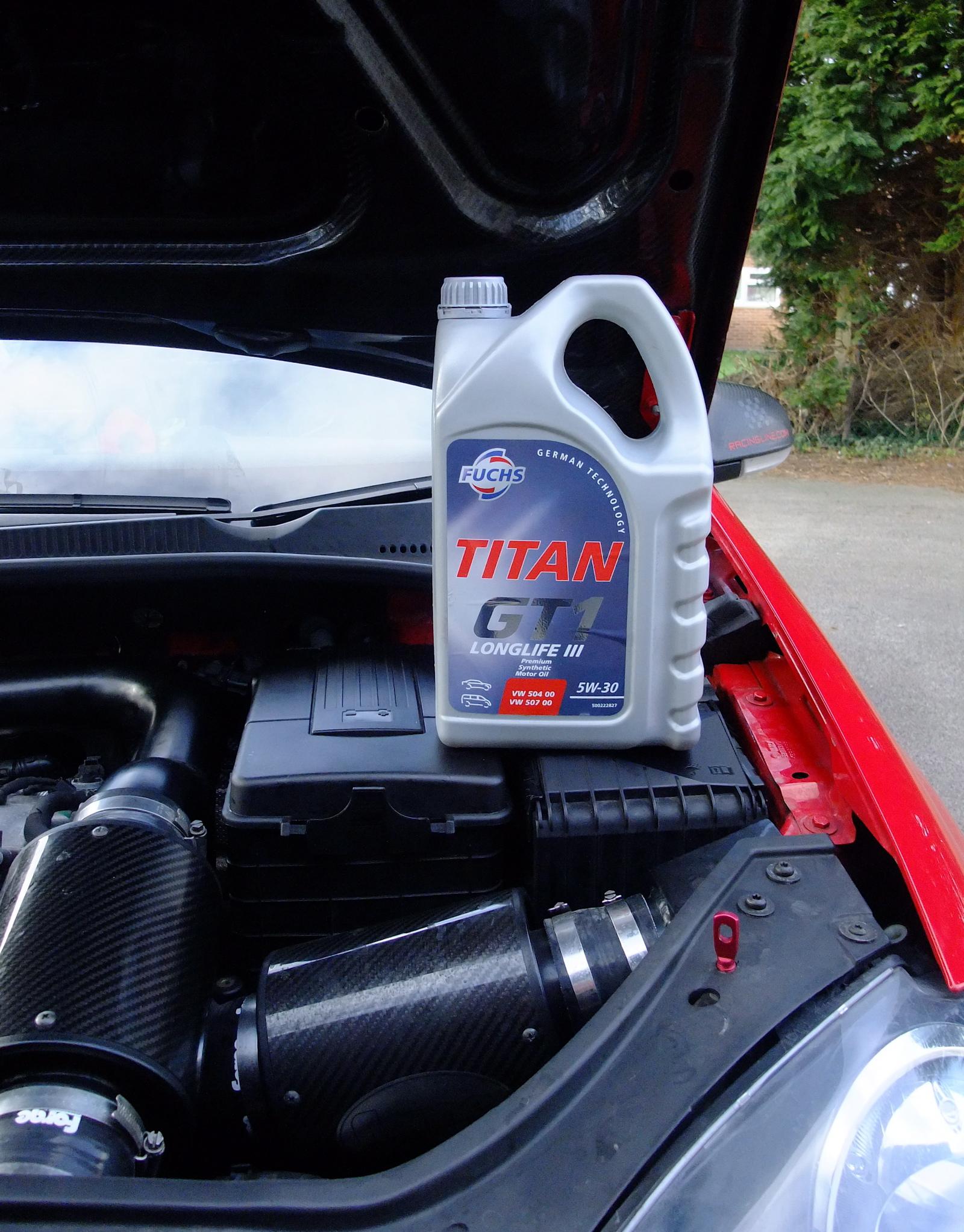

Mine is running on this oil:
And am assuming it's absolutely fine!

Re: Oil issues - Time & Distance
« Reply #14 on: June 09, 2011, 10:59:17 am »
The Fuchs says its meets "VW504" standard so yes!!  :drinking:
Personally I would put the highest grade oil in as it give the most protection.....I like my engine to keep working after the abuse I give it with my heavy right foot!!!  :happy2:
....That Fuchs oil is what VWR use when they service my car every 10,000 miles  :happy2:
