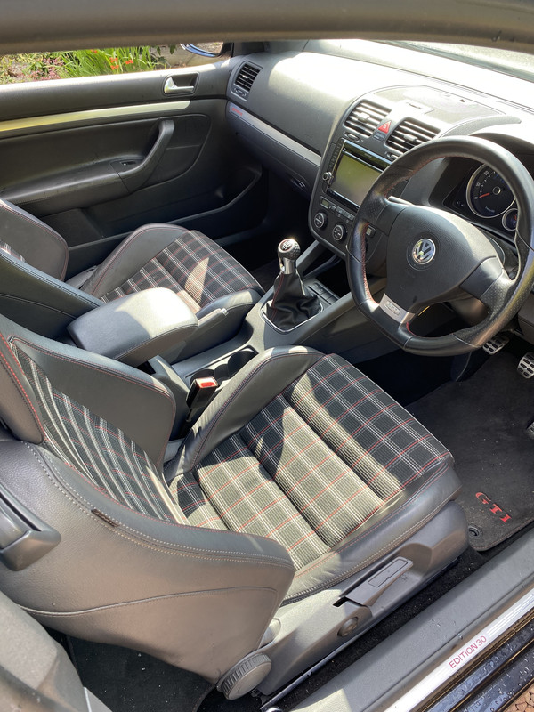

« Reply #12212 on: August 22, 2021, 03:53:20 pm »
Finally found a good condition leather gti armrest for my car and was fitted today.

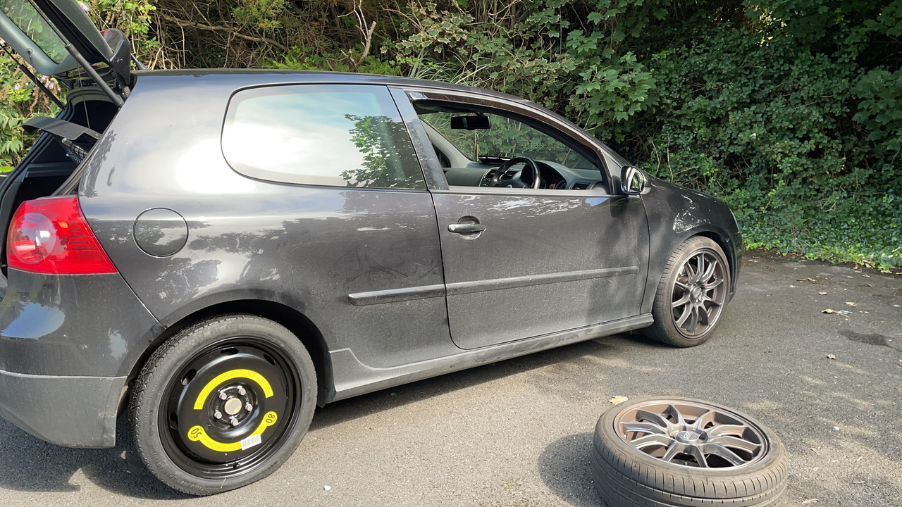

« Reply #12215 on: August 26, 2021, 09:28:38 pm »
A flat tyre highlighting the need For some urgent TLC over the weekend
