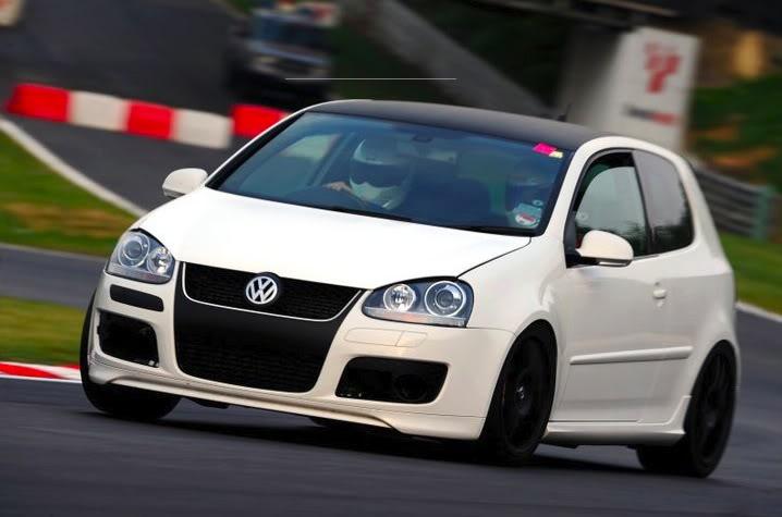

here is the car running load on 255 35 18 toyo 888's she's currently on 255 35 18 Yokos AD08's both give no problems with rubbing either loaded or on full lock...

Can't understand how is that possible with OEM fenders. What do you mean by rolled slightly ? (5mm, 1cm ?). Chalkie, please also specify what ET have you got to those 8.5 x 18 rims ?

rex, It's also weird the 255 tire doesn't touch the damper on the inside. For me, with 235 the tire sits about 10mm away from the Bilstein damper and I have ET46. 255 should touch it with ET50 !!!
Mk5 GTI 6MT - Revo stage 3
