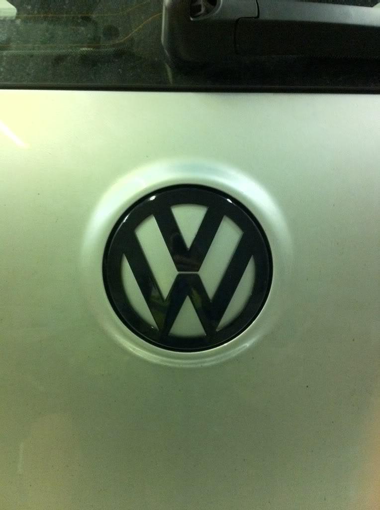

i did mine last week wiv vw reflex silver i removed the VW badge rubbed the black backing a lil so the paint had a surface 2 cling 2 sprayed 2 layers of plastic primer then 2 layers of silver followed by 2 layers of clear coat and this is how it came out
« Last Edit: September 13, 2011, 08:20:04 pm by Gti_Mad »

looks smart, have you got a wider shot of it?  :smiley:
