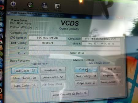

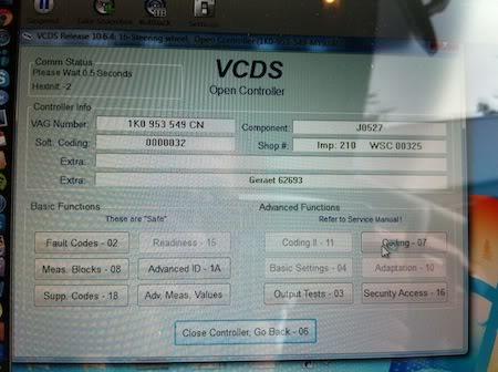

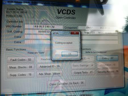

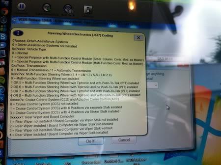

Apologies for reviving an old thread but thought it better to revive this than start a new one on the same topic.

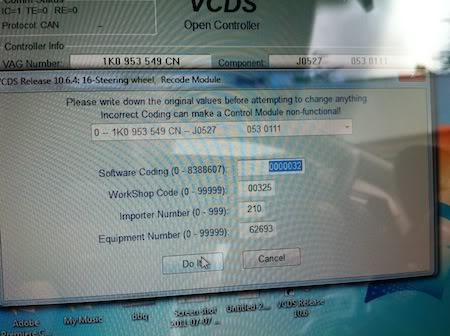

My question is can someone please explain to me how exactly you work out what number you should input where this install was 000032?
I.e., what are the parameters for deciphering this code or am I missing something REALLY obvious!?
I have everything else done, ie., stalk installed, wire already present and all codes cleared. Just the coding to activate the CC itself required.
Thank you in advance for any help.

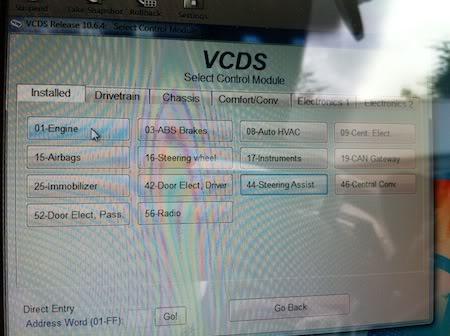

Regards,
Mick.

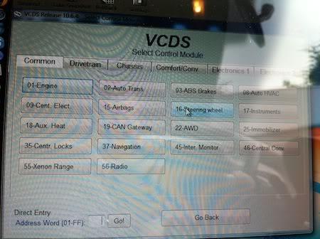

A helper window should popup when entering in the code, however you do need to activate cruise control in the engine control module too.

Thank you for the quick reply.
Am I to understand that this helper window will assist in deciphering the correct code to input?
I've only recently gotten VAGCOM etc and am very new to this coding lark so apologies if that is a very silly question!

Yes it should tell u what what each digit is for, you have to add the values in the helper popup and enter that number in

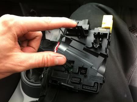

4) Don't take the steering wheel control module apart, this video shows how to remove it at 4 minutes

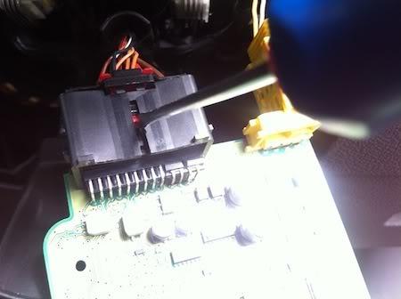

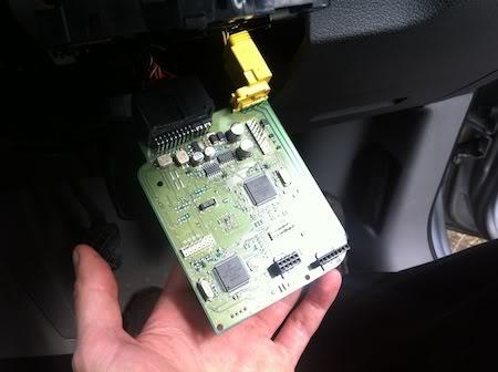

First of all you will need a compatible Steering Control Module. This is a circuit board in a black casing that sits under your steering column and is what the indicator / wiper stalks, ignition barrel, slip ring and steering angle sensor plug into. Take off the steering column plastic casing (see below on how to do this) and then look under the column and you will see a slim black rectangular part about 12cm x 9cm. Mine had a yellow warning sticker on it (as its all to do with the airbag so dont mees with it unless the battery is disconnected). Write down the part number of the steering control module.
For cruise control you will need a steering control module that is midline or highline. Lots of caddys however were fitted with lowline modules which will need upgrading. To check which version you have refer to this handy table... you will note they are all the same part number... just with a different letter or two letters at the end. The letters tell you which version you have.
http://wiki.ross-tech.com/wiki/index.php/VW_Golf_(1K)_Steering_Wheel_Versions
My van had 1K0-953-549-AE which is a lowline so I needed a new module.
If you have a midline or highline module already fitted happy days move onto the next bit. If you have lowlline get on ebay and search for the correct part. I was lucky and found a CN module for £13 :) but you will have to keep your eyes peeled. There are a few versions that will work.

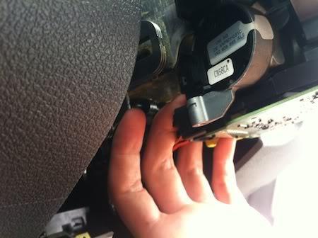

Second if you need to change the steering control module, double check which slip ring you have fitted as it will need to be compatible with the module.
You will see from the link above there are 4 modle numbers for slip rings and these fall into 2 types..
Type 1: 1K0-959-653 and 1K0-959-653-A
Type 2: 1K0-959-653-C and 1K0-959-653-D
Again I was lucky and had a 'C' slip ring which was compatible with the 'CN' module i purchased. If you buy a module that supports midline / highline but supports a type 2 slipring and you have a type one slip ring... obviously you will also need to buy a different slipring. Might seem obvious but thought I'd mention it as its something to check.

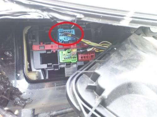

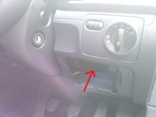

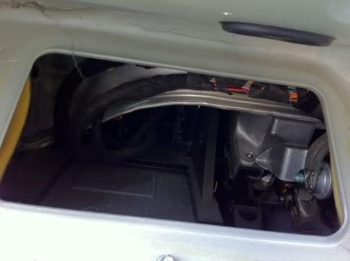

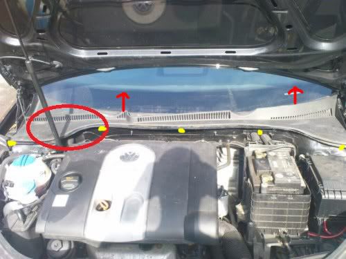

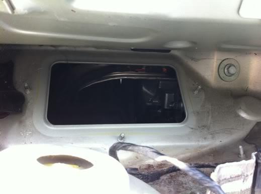

First pic is the marked area of where the target is in the circle. To get to it remove the wipers (which can be a tricky job in itself). Then remove the upper scuttle panel. This pulls up from a small grove at the front of the screen. Be gentle as its a bit fragile but it will come apart from the grove buy pulling up as marked by the red arrow. Start and one end and work along.
I found it much easier to work in that area as wel once the lower metal cover was removed. From what I remember there are 5 bolts holding this in place in roughly the places marked by yellow dots.. I had all this apart anyway to get to my top mounts to change suspension

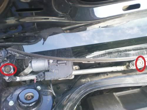

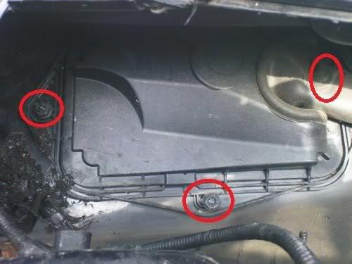

Remove the wiper motor. Unplug it and then 3 torx screws and there its also pushed into a rubber fixing at the back aswell so once unscrewed it pulls forwards a bit and then its free.. not this is a golf.. on the caddy there are 3 screws
Remove the plastic cover. Again this is a golf.. on the caddy it doesnt have that rubber pipe thing on the side and its actually hidden up and further back than it looks here

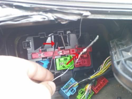

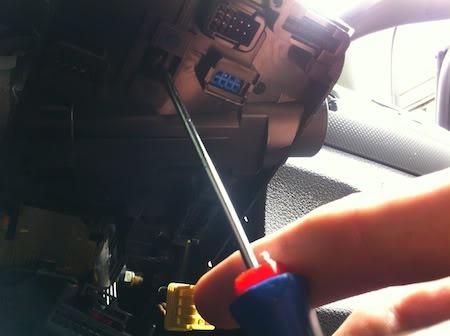

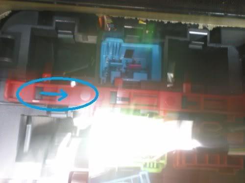

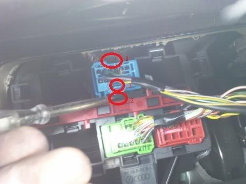

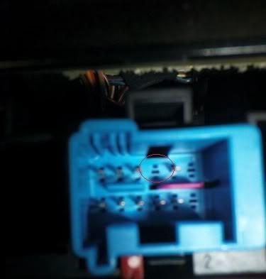

Lifting the cover, you will see the target, only one you will be working with is the BLUE connector.

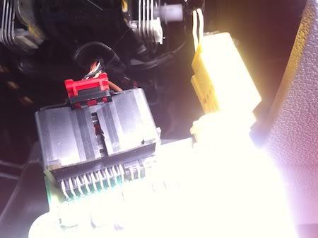

Start off with uncliping the area marked (1) that will remove the part with the wires in it, circles 2 and 3 need to be unclipped also. DO NOT TRY PULL THE CONNECTOR UP, IT IS MENT TO BE PUSHED DOWN AFTER IT HAS BEEN UNCLIPPED!
You have to slide the red bar to the right so that the connectors can release.
Now we can see the area that has no pin, the new lead will be attached into this slot.

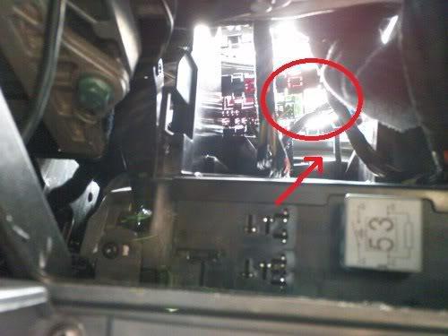

Now leave everything as it is and go back into the car. Take off the small item box buy opening it and pressing on each side, again pulling it down, it will release, then pull towards you to remove. Here is where you will feed the male side of the wire.... on my caddy i have a fuse box there but you will have to work out how to route the wire through
This is the direct path to the area you was at, lead the wire to the top and leave it there. Go back out and pull the wire.

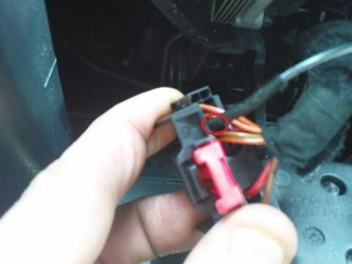

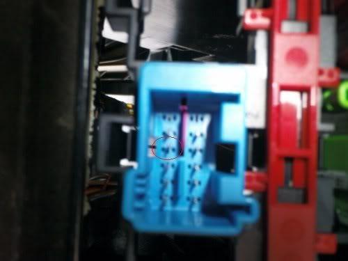

Bring the wire through ready to clip into the blue plug
Here it has been connected to the blue box, pin no (4)
Connect everything back in reverse and return back into the car.

Now.. again to avoid duplicating guides please see below for how to remove the steering control module and plugs but this is a photo of the wire clipped into the black plug in location 13. Simply push the connector till you hear a slight click.
Now you see why your lucky if you already have that wire installed :)

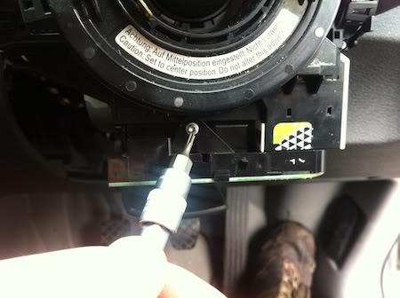

T8 torx (yes very small!) for removing the tiny screw on the control module

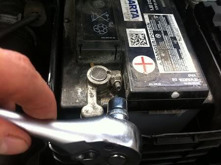

First things first... disconnect the battery. Dont forget to write down your trip mileage if you keep track of that because this will clear it to zero.
10mm socket to undo this and tuck the terminal down in the battery box so it doesnt just swing back and touch the positive terminal on the battery

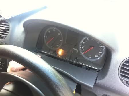

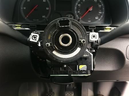

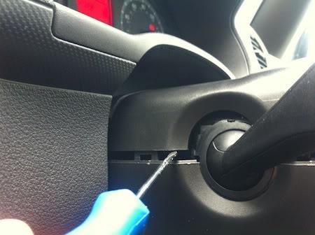

Back inside the van remove the steering column casing. Thin screwdriver to prise the top part of the cover off
The part under the clocks then pulls away towards you and you can put this whole section to one side to stop it flapping down on where your working later

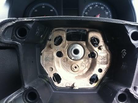

Turn the wheel quarter to the left then to the right to reveal 2 t25 torx screws holding the lower section of the casing in place. There is also one underneath the casing screwing in upwards which also needs removing

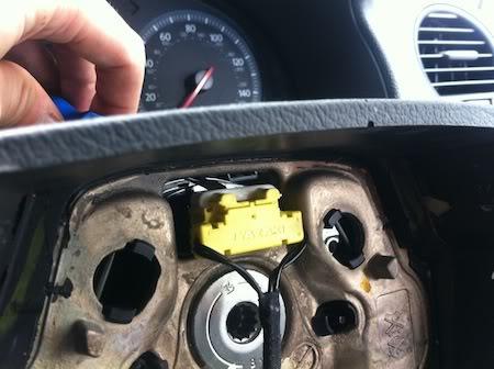

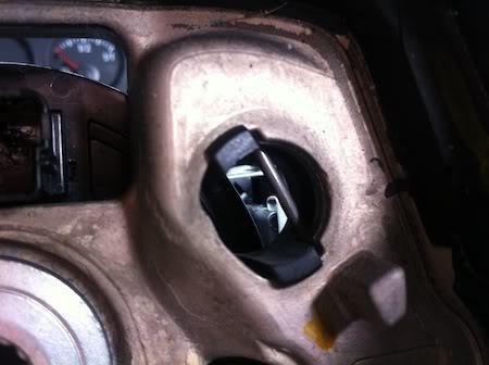

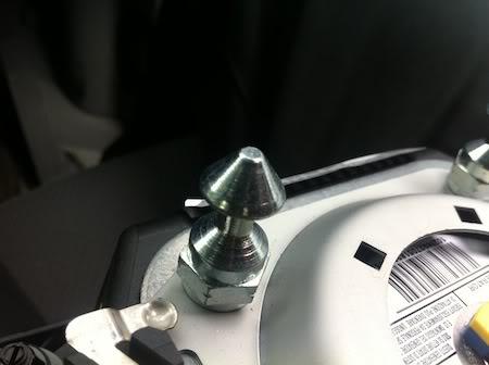

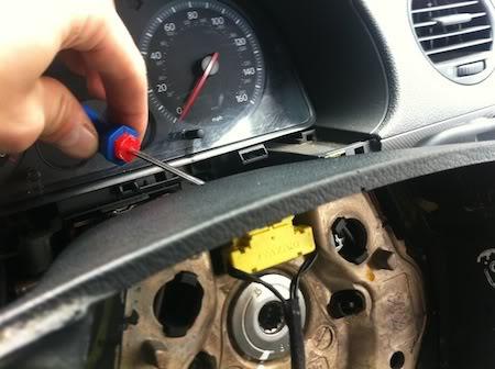

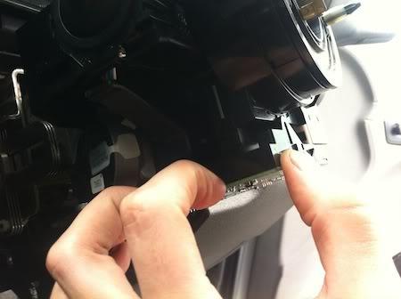

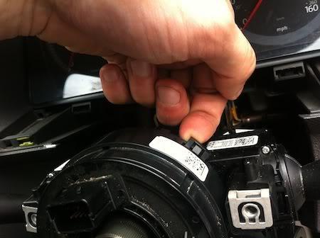

I then had fun trying to get the airbag out so I thought it would be helpful to show you what your trying to do..
Your trying to get this pin..
out from behind this spring thats holding it in place..see the little metal bar.. thats the spring you will have to deform to release the pins
I didnt get a photo of this as its right behind the wheel and hard to see but you need to turn the wheel a quarter to the left again and there is a clip in the middle where you insert a thick ish screwdriver (i used a 5-7mm thick philips screwdriver as you need to put a bit of force through it and something thinner would bend). Push down hard on the clip and at the same time push the airbag in a big to release the pressure on the spring and then pull it back. You should feel that side come free. Turn the wheel the other way and there is another clip the other side. Its a bit of a faff but thats the process.

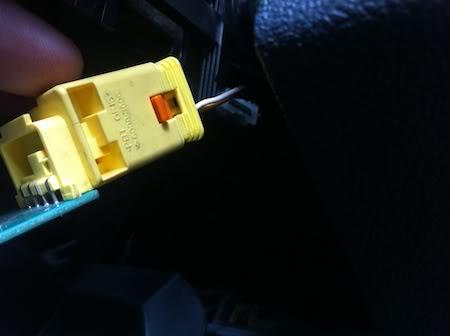

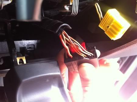

Once the airbag is free you have to deal with the plug which has a white slide clip at the top. I used the thin screwdriver from the back of the steering wheel to push this white clip towards me and in turn this pushed the yellow plug off

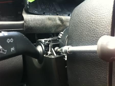

Then just the M12 multibit spline bolt and the steering wheel is off
Now your left looking at this.. note i had already removed the black cover from the bottom of the steering control module. this just clips off using the this screw driver
Remove the T8 torx screw from the front of the control module.. dont lose it with it being so small!
Now a bit tricky... you have to prise the circuit board out but be careful as there are lots of delicate pins and connections that need to come out. I found the best way was to first pull it down a bit from the plugs at the back
then from the sides
and finally it will drop free
I found it essential to remove the board in this way as its otherwise near impossible to get to the clips that actually hold the control module casing to the bottom of the steering column.
Undo the black plug but using a small screwdriver to press the little red tab in and the red slider will come out and then use the screwdriver to carefully prise the plug from the socket
The yellow one can be done by hand by pushing the sprung orange tab back
The black plug is where the diagnostic wire will go... or is where it will already be if your lucky!! mine already have a plack wire in pin 13 (there is a pin hole number guide stamped on the side of the plug for you to double check the right hole)
Now to remove the rest of the control module casing so you can start taking off the slip ring etc...
Again I'll show you what your trying to do... ontop of the control module casing there are two clips. I could not see any way of getting to these other than by removing the circuit board and accessing them from underneath..
These are the clips on the casing once its been removed
And here is the view from under the column looking up where you can just see the bottom of the tab you need to pull back (again i used the small screwdriver to lever it back a bit so i could pull the case down a bit at the front and then again used the screwdriver on the tab at the back and it came free.
Next the slipring has 2 clips at the top on either side and then it just pulls forwards
This tiny little thing is the steering angle sensor... you might need to reset this little puppy later!! this is what caused me so much confusion but because I'm nice I'll run you through that in due course lol. This just pulls forwards.
And at long last you can remove your old stalk. Its clipped at the back and then it pulls forwards.

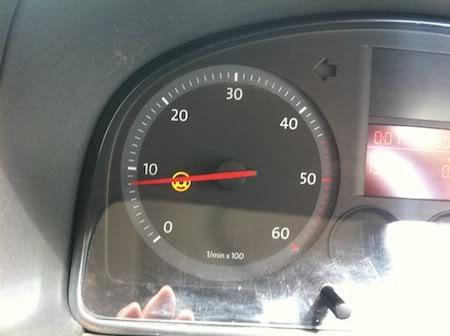

Reconnect your battery and start her up. You will probably have this steering fault light showing.. even if you only took it apart to check the wire and didnt change anything
If you didnt change any parts but only took it apart to check for the wire etc then try the Steering Limit Stop Adaptation reset below and it should clear the fault.
Step 4 - Coding with Vag Com
Excuse the poor quality photos.. i took photos of the screen with my phone for speed rather than doing screen dumps.  :roll:
With the ignition on load up vag com. hit 'Select'
Then '16-Steering Wheel'
Then 'Coding-07'
You should get a prompt box pop up with all the options
Here are those options (taken from the rosstech wiki site http://wiki.ross-tech.com/wiki/index.php/VW_Golf_(1K)_Steering_Wheel#Coding)
Quote
The following table applies to Control Modules with Software Version 0101 or lower.
0?xxxxx: Vehicle Type
0 = Normal
1 = Special Purpose (e.g Taxi)
0x?xxxx: Transmission
0 = Manual Transmission
1 = Automatic Transmission
0xx?xxx: Steering Wheel
0 = Steering Wheel without Multifunction
1 = 3-Spoke Steering Wheel without Multifunction
2 = 3/4-Spoke Steering Wheel with Multifunction without Cruise & Voice Control
3 = 3/4-Spoke Steering Wheel with Multifunction with Cruise & Voice Control
0xxx?xx: Additional Equipment
+1 = Tiptronic (Shift Paddels)
0xxxx?x: Board Computer / Cruise Control System (CCS)
0 = w/o Board Computer and w/o Cruise Control System (CCS)
1 = with Board Computer and w/o Cruise Control System (CCS)
2 = w/o Board Computer and with Cruise Control System (CCS)
4 = with Board Computer and with Cruise Control System (CCS)
0xxxxx?: Rear Wiper
1 = Rear Wiper not installed
2 = Rear Wiper installed
The following table applies to Control Modules with Software Version 0110 or higher.
0?xxxxx: Driver-Assistance-Systems
0 = Driver-Assistance-Systems not installed
0 = Message for Driver-Assistance-Systems active w/o Button
1 = Message for Driver-Assistance-Systems inactive w/o Button
2 = Message for Driver-Assistance-Systems active with Button
3 = Message for Driver-Assistance-Systems inactive with Button
0x?xxxx: Vehicle Type
0 = Normal
1 = Special Purpose with Multi-Function Control Module (Steer. Column. Contr. Mod. as Master)
2 = Special Purpose with Multi-Function Control Module (Multi-Function Contr. Mod. as Master)
0xx?xxx: Transmission
0xxx?xx: Multi-Function Steering Wheel
0 = Multi-Function Steering Wheel not installed
5 = Multi-Function Steering Wheel w/o Tiptronic and w/o Push-To-Talk (PTT) installed
6 = Multi-Function Steering Wheel with Tiptronic and no Push-To-Talk (PTT) installed
7 = Multi-Function Steering Wheel w/o Tiptronic and with Push-To-Talk (PTT) installed
8 = Multi-Function Steering Wheel with Tiptronic and with Push-To-Talk (PTT) installed
0xxxx?x: Cruise Control System (CCS) and Adaptive Cruise Control (ACC)
0 = Cruise Control System (CCS) not installed
1 = Cruise Control System (CCS) with 6 Positions via separate Stalk installed
2 = Adaptive Cruise Control (ACC) with 6 Positions via separate Stalk installed
3 = Cruise Control System (CCS) with 4 Positions via Blinker Stallk installed
4 = Cruise Control System (CCS) via Multi-Function Steering Wheel installed
5 = Adaptive Cruise Control (ACC) via Multi-Function Steering Wheel installed
0xxxxx?: Rear Wiper and Board Computer
1 = Rear Wiper not installed / Board Computer via Wiper Stalk not installed
2 = Rear Wiper installed / Board Computer via Wiper Stalk not installed
3 = Rear Wiper not installed / Board Computer via Wiper Stalk verbaut
4 = Rear Wiper installed / Board Computer via Wiper Stalk installed
So with my new steering control module being version 'CN' with software version SW 0111 i obviously need the second set of options.. My code worked out as 0000032... I input this.. BUT... yours MIGHT be different depending on what options you have on your van so check this yourself
and hit 'do it'
Then hit the 'close controller, go back -06' button at the bottom and go into '01-Engine'
Then 'Coding II- 11'
Enter the number '11463' and hit 'do it'
Come back out of vag com, disconnect the cable, go for a test drive and test cruise works. your steering light will 'probably' still be on though
Step 5 - Clearing the steering fault / Resetting the steering angle
If your van is like mine you will now have cruise active and tested as working on a little drive but your steering fault light will still be on and your power steering will feel really really heavy.
I dont have any photos of the next steps I'm afraid.
Back in vag com go to '44-Steering Asist' and check the fault codes. This is what mine showed and they wont just clear. If you try to clear them they pop right back up

Steering wheel control module is a git to remove, yes, but with patience and a long hex key, it's simple.
The routing of the wire from the steering control module to the in-line is tricky due to the steering column shaft movement. You need to make sure it won't get trapped or chaffe anywhere.
I've added a pic of the wire routing as you have to take care with this due to the steering column movement.
