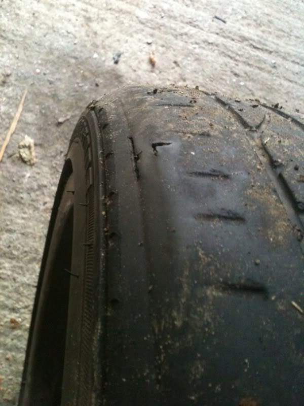

Tyres have even tread, apart from inner edge which has a 45 degree chamfer...
 :surprised:
Tracking or Camber do you reckon, both fronts are same...
Left Front - Camber =-1.01 & Toe =0.06
Right Front - Camber = -0.50 & Toe =0.06

Are they the tracking results after a recent alignment?
You wouldn't get wear like that unless the toe was poking out loads.

Yeah that was the latest alignment done say 3 months ago... So dunno if it was bad before, then just overall wear has made it worse...

Must have been out for a while before the latest alignment.
Now you have new tyres it would be worth doing the alignment again.  Obviously I would do the best job!  :grin:

On a stock car, front toe is adjustable, whilst caster and camber are fixed. If there is an imbalance across the front axle you can move the front subframe slightly to optimise (balance across the axle) the front camber and caster.
On the rear you can adjust the toe and camber.
In my experience most FWD cars with a mac-strut front end tend to scrub the inside edge of the front tyres when cornering. It normally shows most on the offside front tyre due to enthusiastic driving around roundabouts.
Ignoring the inner edge of your tyres for the moment, what are the other tread blocks like? If you run your hand around the tyre, does it feel smooth one way, and rough the other - almost as if the treadblocks have a kinda sawtooth profile when viewed from the side?
It's quite possible you've run with excess toe-out, and then with the inside edge scrub superimposed on this the tyres are shot on the inside edge earlier than would normally be the case.

As you also say it might have been the exagerated tyre wear when the alignment was out, that did the majority of the damage then general wear caused the rest...
