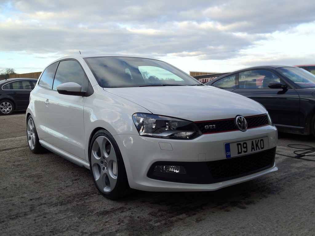

DMR Enhancement Detail completed today!!!  :jumpmove:  :pomppomp:
Detail My Ride by LukeDeakin, on Flickr
#1493
Offline rdfcpete
  • -Given: 98
  • -Receive: 52
  • Posts: 2567
Re: Candy White 6R Polo GTI - DMR Enhancement Detail - 19/3/2012
« Reply #131 on: March 19, 2012, 05:56:54 pm »
Cleannnn old girl she is  :happy2:
(Is that a Z4 next door? Who's is it, not one of Nathans own?  :smiley:)

Offline Deako
  • -Given: 38
  • -Receive: 44
  • Posts: 1655
  • Eat, Sleep....VAG
« Reply #132 on: March 19, 2012, 06:25:57 pm »
997 C4S iirc.
