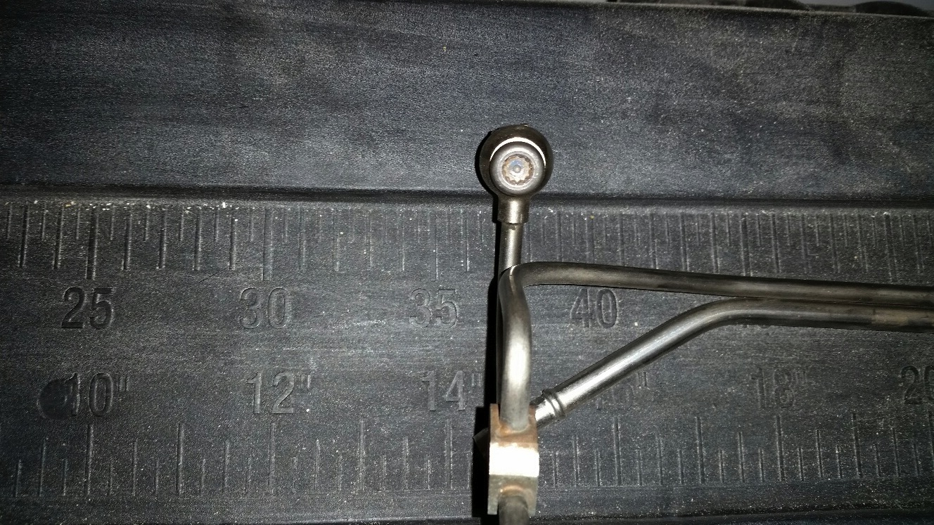

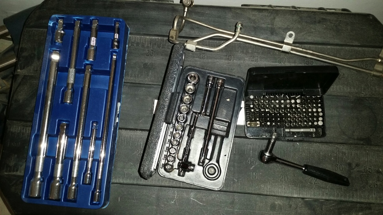

Here is my cam follower replacement process I do every 10k miles along with every other oil change...because HPFP is upgraded. Mine is Bamboo fitting and doesn't show how to tackle the Banjo bolt. If you do not have an upgraded HPFP by APR, Autotech, I.E., or other...your stock oem cam follower is likely going to get worn through from 80k miles on;

Just to add that a bit more effort will be needed if you have a banjo bolt attaching your fuel line to the hpfp. This diy only deals with those cars that have the flexible hose to hpfp which is easier to do.
btw I thought that the safest way to relieve the excess pressure in the rail was to bleed the Schrader valve.
