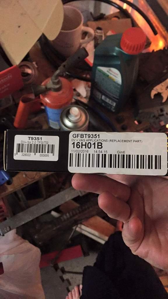

Niki put up a load of pictures on Facebook (TFSI Tuning) demonstrating the differences (will need to search on a PC to find it).
Obvious signs of a fake were the sticker on the box looking distinctly sh*t i.e. very basic and not having a barcode. The billet body of the fakes had 4 holes compared to the genuine which has 3 (perhaps the copy was based on an old design?). The brass piston on the fakes had a very poor finish compared to the genuine item too.
As for the old versions, I believe it had a different piston and plunger, and they may have been a different colour but not 100% sure.
To be honest I would just save up the cash for a new one from AMD

Offline r5gtt
  • -Given: 342
  • -Receive: 334
  • Posts: 5586
Re: GFB DV+ OEM Diverter upgrade kit
« Reply #198 on: June 04, 2016, 03:20:57 pm »
Ive found someone who bought two from demon tweeks in march this year, he doesnt know if its the latest revision though, does anyone know how to tell if its the latest revision?
pesky pesky pesky always asking questions  :signLOL:
The revised version has a brass colour piston and stronger springs and the older version had a black piston. Also the picture you've posted has a date on it   :doh:
« Last Edit: June 04, 2016, 03:23:24 pm by r5gtt »
Offline Pesky jones
  • Posts: 1639
« Reply #199 on: June 04, 2016, 05:26:50 pm »
So its the revised version then? I thought thr newer revision had the black plunger?
Offline Dan_FR
  • -Given: 132
  • -Receive: 189
  • Posts: 1845
  • wait...what?
« Reply #200 on: June 04, 2016, 06:08:07 pm »
If it was bought in March it should be the latest revision.
Don't confuse the plunger and the piston. Piston is brass and the plunger is black
Offline r5gtt
  • -Given: 342
  • -Receive: 334
  • Posts: 5586
« Reply #201 on: June 04, 2016, 06:24:46 pm »
wrong thinking pesky  :slap: as Dansays
Offline Dan_FR
  • -Given: 132
  • -Receive: 189
  • Posts: 1845
  • wait...what?
« Reply #202 on: June 04, 2016, 08:36:25 pm »
Found the FB post:
