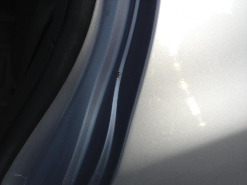

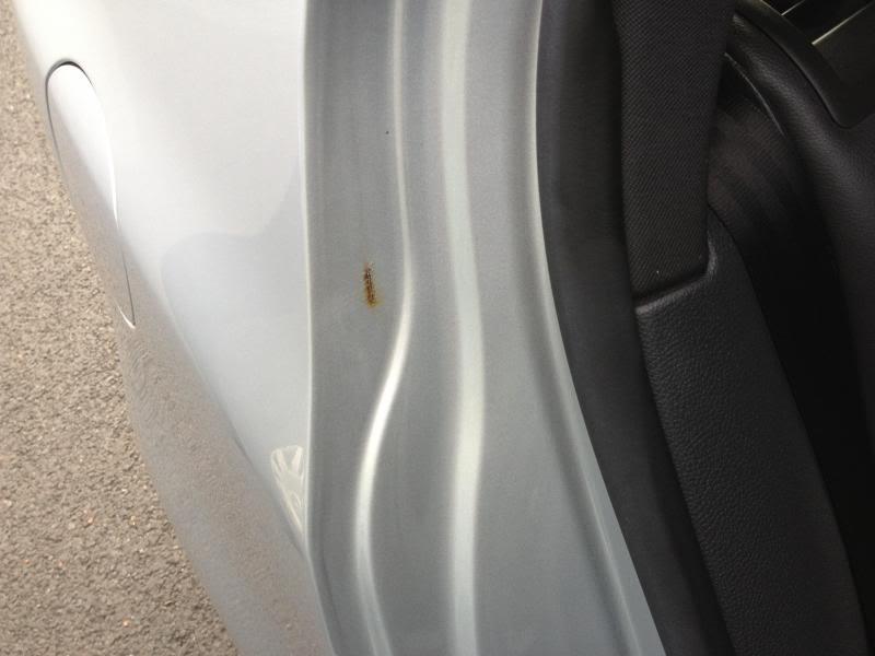

I'm on the fence about a particular MKV I viewed recently. I noticed a couple of strange rust spots and wondered are they a sign of something worse
Front right sill/arch
Back left rear door
Back right rear door

Sadly they are common areas of rust on the mkv  :sad1:

Is there any particular reason for the rear door pillar rust spots ? also as the car is only 2007 - would VW cover this ?

You'll probably get a 50% contribution from vw but I'd move on to another car.  The skirts have been badly prepped and sprayed, that paint will flake off in no time
The rubber door seals rub the paint work  :sick:
The kicker here is, I need a 5 door and the spec of this particular one is excellent, dsg/leather/climate/nav/fsh/low mileage and the remaining ones for sale here (ireland) don't come near that spec.
ah ok, so if repaired, you would need to trim back the door seal ever so slightly.

wheel arches are a major problem, check all around for any signs of bubbling or early rust

You can buy precut patches to place on these areas
